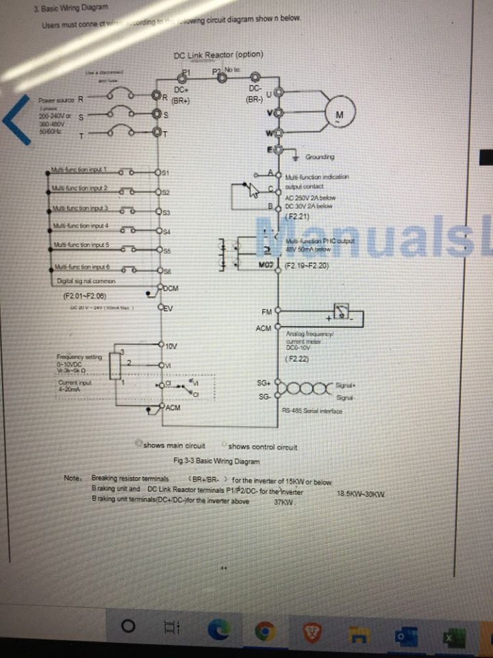

27 Jul 2020 23:51 #176171
- bevins
- Posts: 1947
- Thank you received: 338
28 Jul 2020 00:12 #176182
by bevins
Good to know. I will use a relay and order some. These came on the machine from China. Same place they used N/O limit and home switches.... now to watch this inverter video.
and for the record, THEY ARE STEP AND DIR servo's.... lol
Replied by bevins on topic Yaskawa SGD7S drives cant get to work with 7i76

28 Jul 2020 00:20 #176185
Replied by tommylight on topic Yaskawa SGD7S drives cant get to work with 7i76
It seems i will never get used to that, but who knows. I did play with that though on a Hurco retrofit with Granite Devices Argon drives, and promptly set them back to +-10V.and for the record, THEY ARE STEP AND DIR servo's.... lol

28 Jul 2020 01:48 #176201
by bevins
Something change in 2.9 that changes max velocity before homing and after homing?
Before homing I can jog at 600, after it is homed I can only go 180.
- Posts: 22002
- Thank you received: 7488
28 Jul 2020 07:29 #176221
Max_velocity is set in the ini file, per joint, per axis and in the display and traj sections.
I always set the display and traj sections to 25 to 50% more than each joint/axis, this way when i jog X and Y at the same time, it does not have to clip the velocity.
