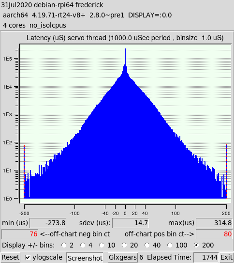

31 Jul 2020 14:41 - 31 Jul 2020 14:50 #176667
by destruction_cereal
Replied by destruction_cereal on topic RPI4 Servo Lateceny Spikes
Here is a plot that I do not understand.
I assume its showing the distribution of latency points
I'll try some things while I wait for replies to see what changes.
As a side not, this build is not the one I made the cmdline modifications to. Its more or less a fresh build.
I want to run a 7i76E from this. Do I need to focus on base thread or servo thread for that?

- Posts: 18111
- Thank you received: 5330
31 Jul 2020 14:51 #176668
Replied by PCW on topic RPI4 Servo Lateceny Spikes
You might try isolcpus =1,2,3
The following user(s) said Thank You: destruction_cereal

31 Jul 2020 15:07 #176670
I added that to my cmdline.txt file and the result has changed. I assume its better.
I took a screenshot around 2-3 minutes. It looks pretty similar around 15 minutes
If i run the standard latency test though, then then numbers are ridiculous.
Max interval 71998871
max jitter 70998871
Last interval 900-1000

31 Jul 2020 15:11 #176671
Its expected that the standard latency test will fail unless you disable the base thread
(the RPI4 + current Preempt-RT kernels cannot possibly handle a 40 KHz base thread)

31 Jul 2020 15:19 #176673
Thats good to know. My previous attempts to bring the latency down probably didn't entirely fail as I previously thought.
Is what I have currently usable for a 7I76E?
- Posts: 22002
- Thank you received: 7488
31 Jul 2020 16:18 #176678
Replied by tommylight on topic RPI4 Servo Lateceny Spikes
Only servo thread is needed and it is usable for 7i76E.
