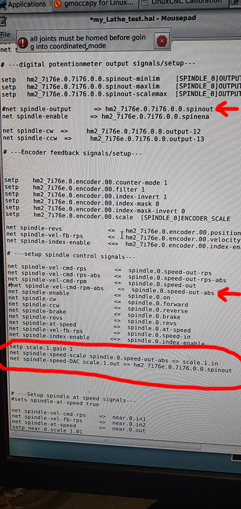

Hello guys,
since about 2 weeks i am stuck at setting up my VFD. I will not write down what i have tried the last 2 or even 3 weeks, but to make it as short as possible, i wanted to control the spindle motor through Modbus. I exchanged a lot of mails with the author of the VFS11 VFD Driver : linuxcnc.org/docs/2.8/html/drivers/vfs11.html. He helped me a lot to build my own converter, which should work (works on 2 different PCs - tested with the windows "Tera Term" software and on Linux with "picocom") but unfortunately the VFD does not want to communicate, so i gave up and decided to control the spindle with 0-10V Analog signal.
Unfortunately its not accurate as on my CNC Router where the spindle is controlled through Modbus. (huanyang vfd)
The Max RPM should be 1420 rpm at 50Hz. Everything is set up correctly in the VFD. Here are 2 examples (please take a look at the bottom of the .IN file - i have also attached the .HAL file):
example 1:
OUTPUT_MIN_LIMIT = 0
OUTPUT_MAX_LIMIT = 1420
OUTPUT_SCALE = 1420.0
With those settings the encoder.00.velocity-rpm parameter (not sure if that parameter name is correct - i am not at the lathe PC) is showing about (jumping around a bit):
- 80 rpm when it should be 100 rpm
- about 1500 rpm when it should be 1420 rpm
example 2:
OUTPUT_MIN_LIMIT = 150
With those settings the encoder.00.velocity-rpm parameter is showing 100rpm when it should be 100 and about 1480 when it should be 1420.
Thats the first problem. I thought to to use pwm signal, but to be honest, i dont know if i can control that VFD with pwm signal, so i was looking for a solution and found that page: Closed Loop Spindle .Speed Control . Unfortunately that example is for PWM signal and i dont know how to set it up with Analog signal control
The other problem is that i get not spindle feedback but the encoder is wired for sure correctly and in the hal meter i can see at the encoder.00.xxxxx commands that the encoder is also connected with Linuxcnc. I am pretty sure that something is missing in the file, but i cant figure out what.
I hope you could take a look at my configs and help me out with those problems. I have some other files like the postgui files for some physical buttons and potentiometers, so please let me know if i should upload them.
Thanks in advance

04 Aug 2020 19:10 - 04 Aug 2020 19:22 #177268
by denhen89
Replied by denhen89 on topic Setting up Closed loop Spindle speed control and Feedback (0-10V Analog)
Thanks Todd and PCW.
I did what you both wrote: FF0: 1 , all other set to 0 (P, I ,D and FF1 and FF2)
With those setting and min. speed set to 150, i get quiet accurate rpm from 150 to 500.
At e.g. S800 the rpm is between 810 and 860 (jumps around)
At S1420 the rpm is between 1450 and 1500
On the motor plate it reads that at 50hz the motor should run 1420 rpm, so i "had" set the max speed to 1420 rpm, but then i changed it to 1480 to see what happens.
I uploaded a video to youtube when i changed the speeds: YOUTUBE: Linuxcnx - 0-10v Analog spindle control
I then tried to set up the scale of the 0-10v, but it does not work as it should or as it is described.
Please take a look at the picture: (i marked the 2 lines where i had to put a "#" before the parameter)
I first tried it with "spindle.0.speed-out, but there was no reaction from the VFD, so i changed to spindle.0.speed-out-abs, which works, but take a look at the scale value: "1" instead of (in my case) 0.007.
When measuring the outout voltage of the analog signal on the Mesa 7i76e i get at full speed/50hz = 10.2 Volts
So, this is my calculation: 10,2 Volt / 1420 rpm = 0,007183.....
I am sorry that i am not describing it more clearly, but i am really a bit tired of that.
I just want a quiet accurate spindle speed and also be able to use "constag surface speed".
Synchronization seems to work:
I did a dry test with a Threading g-code. I have started the programm - axis waits for spindle at speed, then starts threading. I paused the programm and made to spindle to not turn and turned it then by hand. Axis moves when turning spindle, but does not move when spindle is not turning.
Br,
Denis

04 Aug 2020 19:30 #177270
by Mike_Eitel
Replied by Mike_Eitel on topic Setting up Closed loop Spindle speed control and Feedback (0-10V Analog)
Listening to the sound i doubt that your speed is jumping. I think you need to filter the encoders signal. Somebody else can chime in how to...
Do not try to adjust any loop before , you'll get crazy ;-()

04 Aug 2020 19:33 #177271
by denhen89
Yes, you are right, but I do have already a lowpass component but no matter what value I set, there is no visible change.
Something is not correct, but i uploaded my ini and hal file, so it would be great if someone can take a look at this. I really have me best to get it done by my self.
