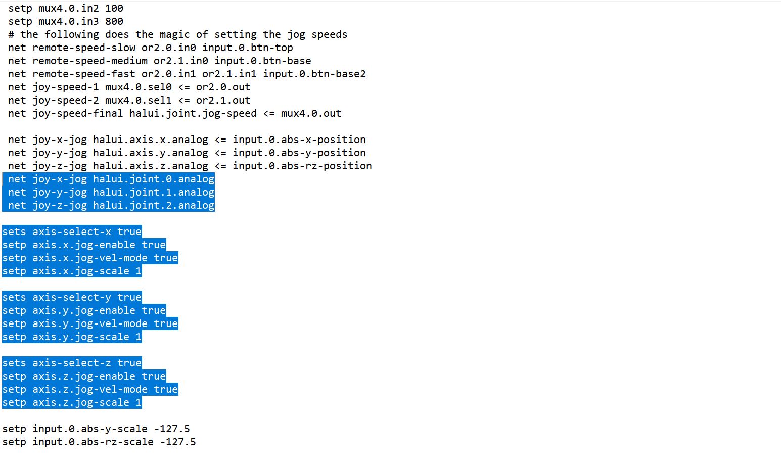

could you help me please? I try to set joypad under linux CNC 2.8 . What i know some links and pins in custom_postgui.hal have to be renamed.
Here is my posgui.hal :
# Include your custom_postgui HAL commands here
loadrt or2 count=2
loadrt mux4 count=1
addf or2.0 servo-thread
addf or2.1 servo-thread
addf mux4.0 servo-thread
# set the jog speed for the joypad again use numbers that make sense for your machine
setp mux4.0.in0 0 # this one must be 0 to prevent motion unless a button is pressed
setp mux4.0.in1 25
setp mux4.0.in2 100
setp mux4.0.in3 800
# the following does the magic of setting the jog speeds
net remote-speed-slow or2.0.in0 input.0.btn-top
net remote-speed-medium or2.1.in0 input.0.btn-base
net remote-speed-fast or2.0.in1 or2.1.in1 input.0.btn-base2
net joy-speed-1 mux4.0.sel0 <= or2.0.out
net joy-speed-2 mux4.0.sel1 <= or2.1.out
net joy-speed-final halui.joint.jog-speed <= mux4.0.out
net joy-x-jog halui.axis.x.analog <= input.0.abs-x-position
net joy-y-jog halui.axis.y.analog <= input.0.abs-y-position
net joy-z-jog halui.axis.z.analog <= input.0.abs-rz-position
# This file will not be overwritten when you run PNCconf again
Linux CNC with gmocappy now start without errors but if i i try machine movems with gamepad nothing happen. All signals and pins in hallmeter works OK.
Maybe if somebody have sucessfully configured and working joypad under linux CNC 2.8 then please for posgui , ini and hal files sharing.
Thank you and sorry for bad English ...
Marek.

Finally it's working! One skilled LinuxCNC user helped me via remote desktop and find out problem in signal linking in custom_postgui.hal . Against tutorial for adding joypad under LCNC 2.7:
wiki.linuxcnc.org/cgi-bin/wiki.pl?Simple_Remote_Pendant
.... you have to add additonal signal links ( marked on picture bellow )
Complete Zip with setting also attached.
Enjoy
