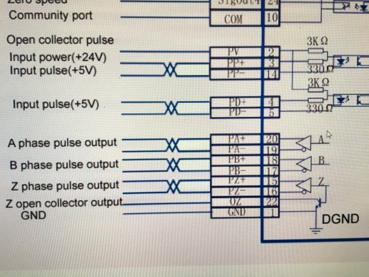

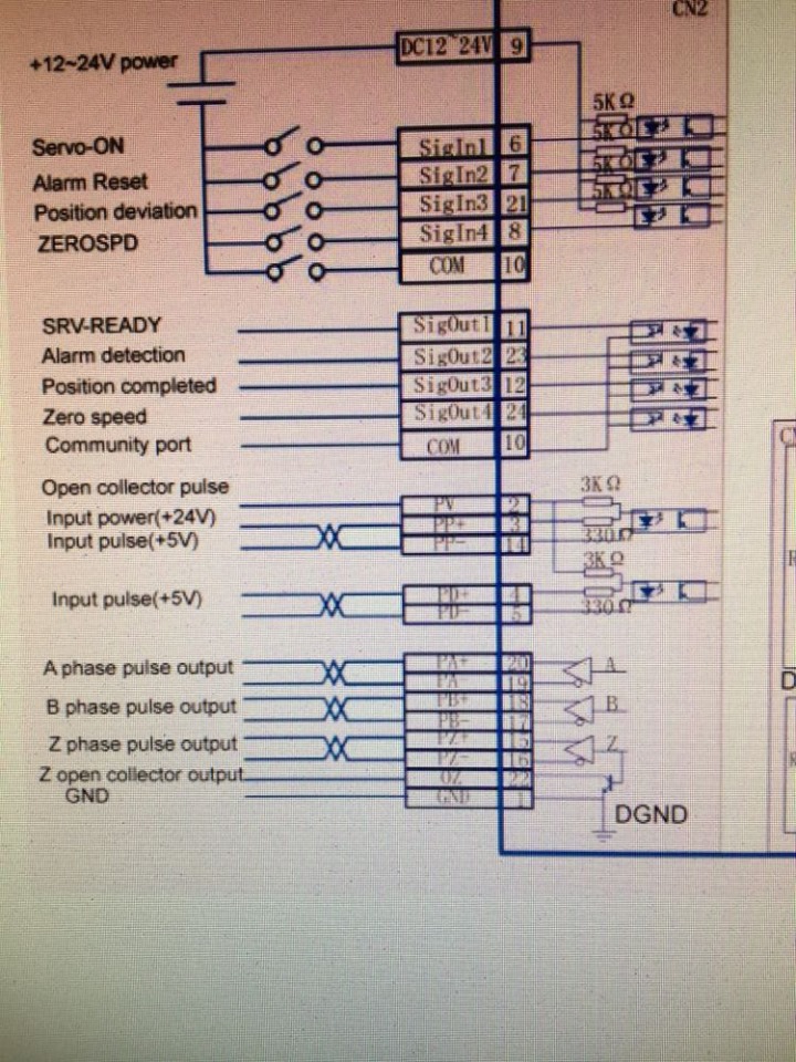

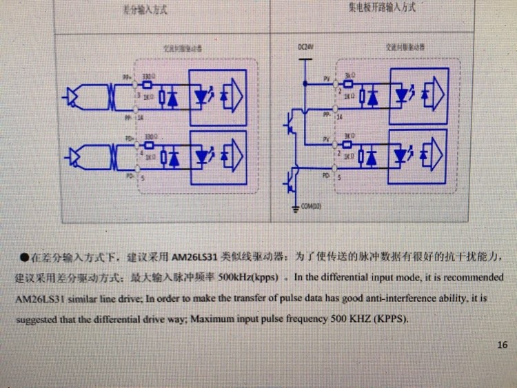

11 Aug 2020 15:04 #177902
by bevins
The manual says it works ion differential or single ended like the pic below. Maybe some weird quirk it doesn't work differential.
Plus what looks weird is the single ended needs 24 volt supply and differential doesnt....

11 Aug 2020 15:20 #177904
Replied by PCW on topic Cant get step/dir drives to move 7i92-7i76
No, it should work as is. The 24V is just for a 24V open collector driver
Is the drive enabled?

- Posts: 18084
- Thank you received: 5317
11 Aug 2020 18:40 - 11 Aug 2020 18:41 #177920
If the differential inputs can be driven by a 26LS31 (as suggested in drive manual)
then the 7I76 outputs should be fine.
Can you make the drive step by connecting PP+ to 5V and grounding PP-?
