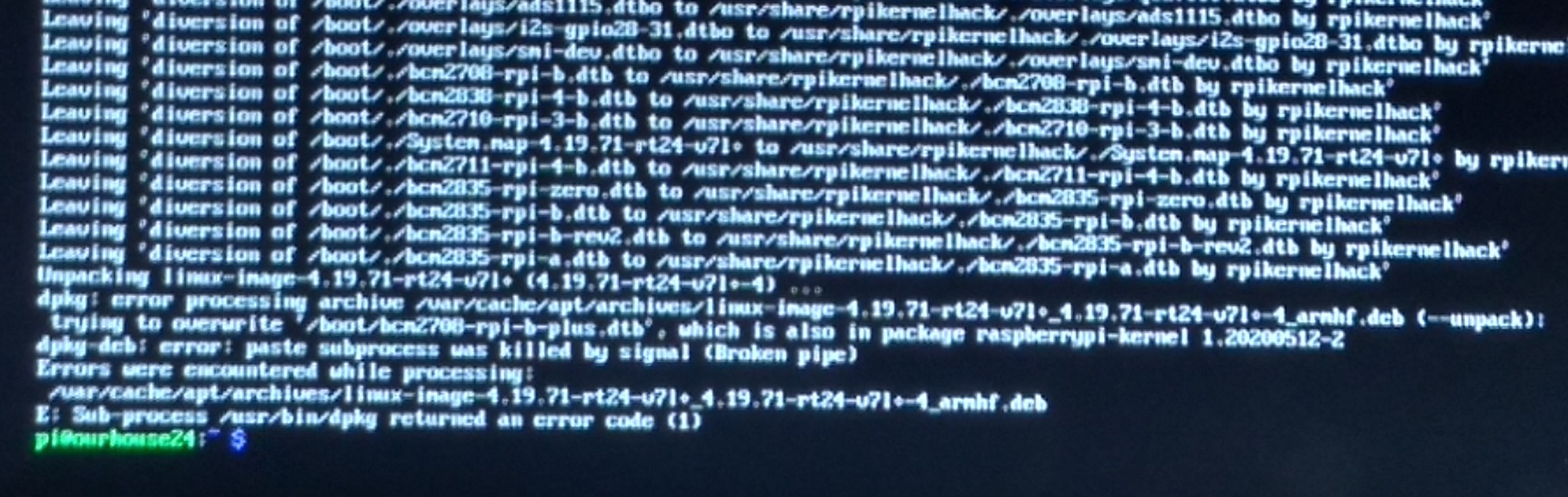

OK - reinstalled everything - including step 6 for the kernel. Heres the screen shot following that image install - not sure if these errors are significant (OK to install linuxcnc -uspace) or fix somthing first. So sorry for crappy jpg.

17 Aug 2020 15:32 #178481 by andypugh
Replied by andypugh on topic Installing on Raspbian 10
There seems to be a problem over-writing some special Raspbian files.
Jepler on IRC found an inelegant solution:
jepler: andypugh: last time I suggested that this command let me
complete an upgrade from one version of my kernel to another:
dpkg-divert --list | grep rpikernelhack | while read _ _ a _ _ _ _;
do dpkg-divert --package rpikernelhack --no-rename --remove $a; done
[02:35am] jepler: and said it appeared that something could leave the
diverts around but I have not discovered what does that besides
interrupting a package installation.
[02:36am] jepler: after running that command, re-run the installation
of the new kernel
[02:36am] jepler: as root
