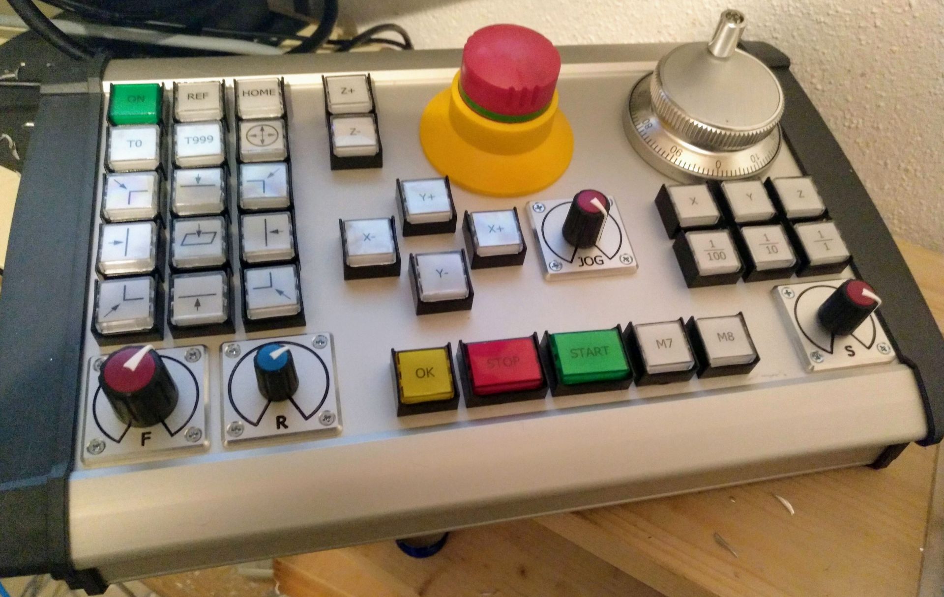

Thanks for the answer. This possibility has not yet occurred to me and I will try your solution. By the way, we have the same taste in housing

24 Aug 2020 04:42 #179211
by roland
Replied by roland on topic Poti for overrides
The following user(s) said Thank You: keyboard, Himarc3D
