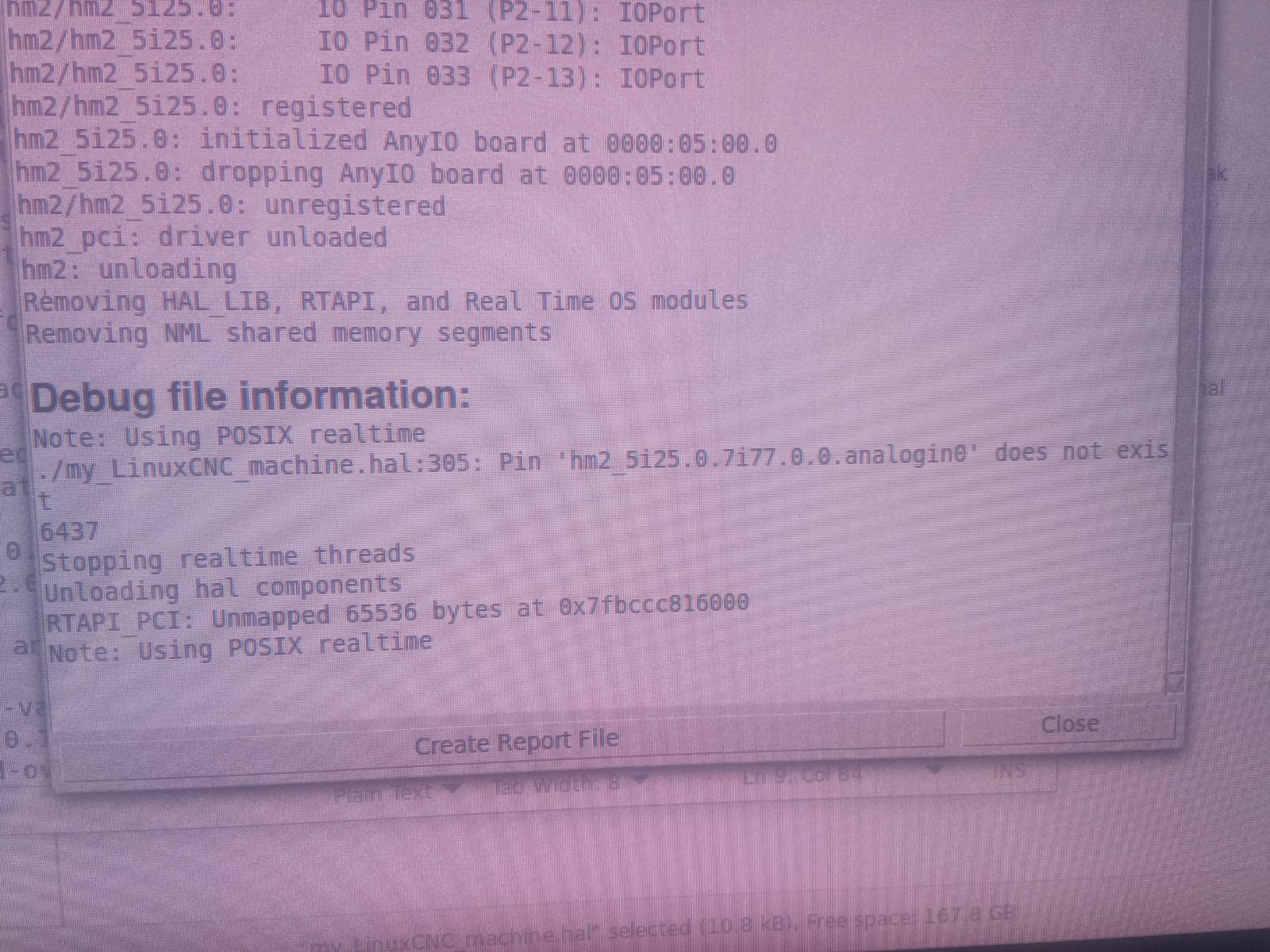

- Dragonick
- Posts: 48
23 May 2023 12:28 #272031
by Dragonick
Replied by Dragonick on topic Poti for overrides
- Posts: 18122
- Thank you received: 5337
23 May 2023 12:35 #272033
Replied by PCW on topic Poti for overrides
Most likely the 7I77 is not set into a mode that supports analog inputs
Modes 1,2,3 support analog inputs
You change this with the "sserial_port_0=Something" command line argument
in the hal or ini file.
With most 7I77 firmware, sserial_port_0=200xxx should work
