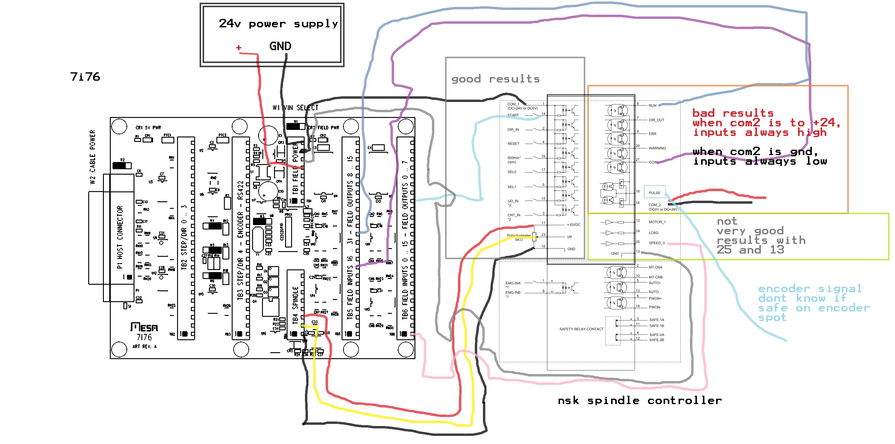

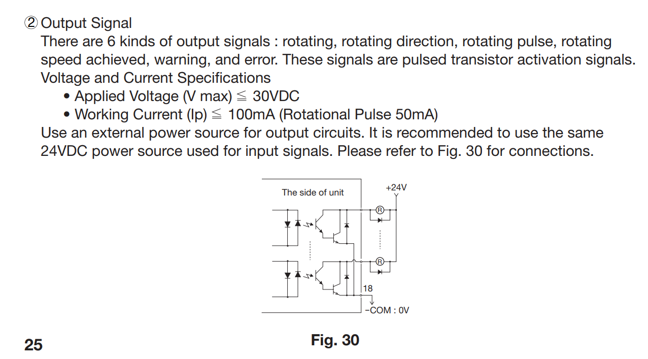

I recently got a Nakanishi Spindle controller and am making an attempt to wire it up with my 7i76 and its not going well. The datasheet I was using was too recent, as my controller is slightly different, making my wiring not so straight forward. I need some help wiring my inputs from the spindle controller , which appear to be sinking outputs on the spindle side.
this is the schematic in question. I do not understand what the R with the circle is in the circuit and what the diode is for edit, it think it is suppossed to be similar to this forum.linuxcnc.org/38-general-linuxcnc-q...-output-to-mesa-7i76.
Right now I have common to ground, output pin to 7i76 input pin 24, with a 2k pullup resistor to +24with no luck, I have also tried several different resistor sizes with no luck either
it appears ive blown one of the outputs on the spindle controller , when i try with others it is now working
This is also the circuit that the "encoder" uses, but with lower "working current" of 50mA. im not sure what this means in reguards to how I hook everything up. I am also not sure how I can wire this into an encoder spot, or if I need to wire it into the MPG spot instead of the 5v spindle encoder spot. Its not really and encoder exactly, but more of a tachometer

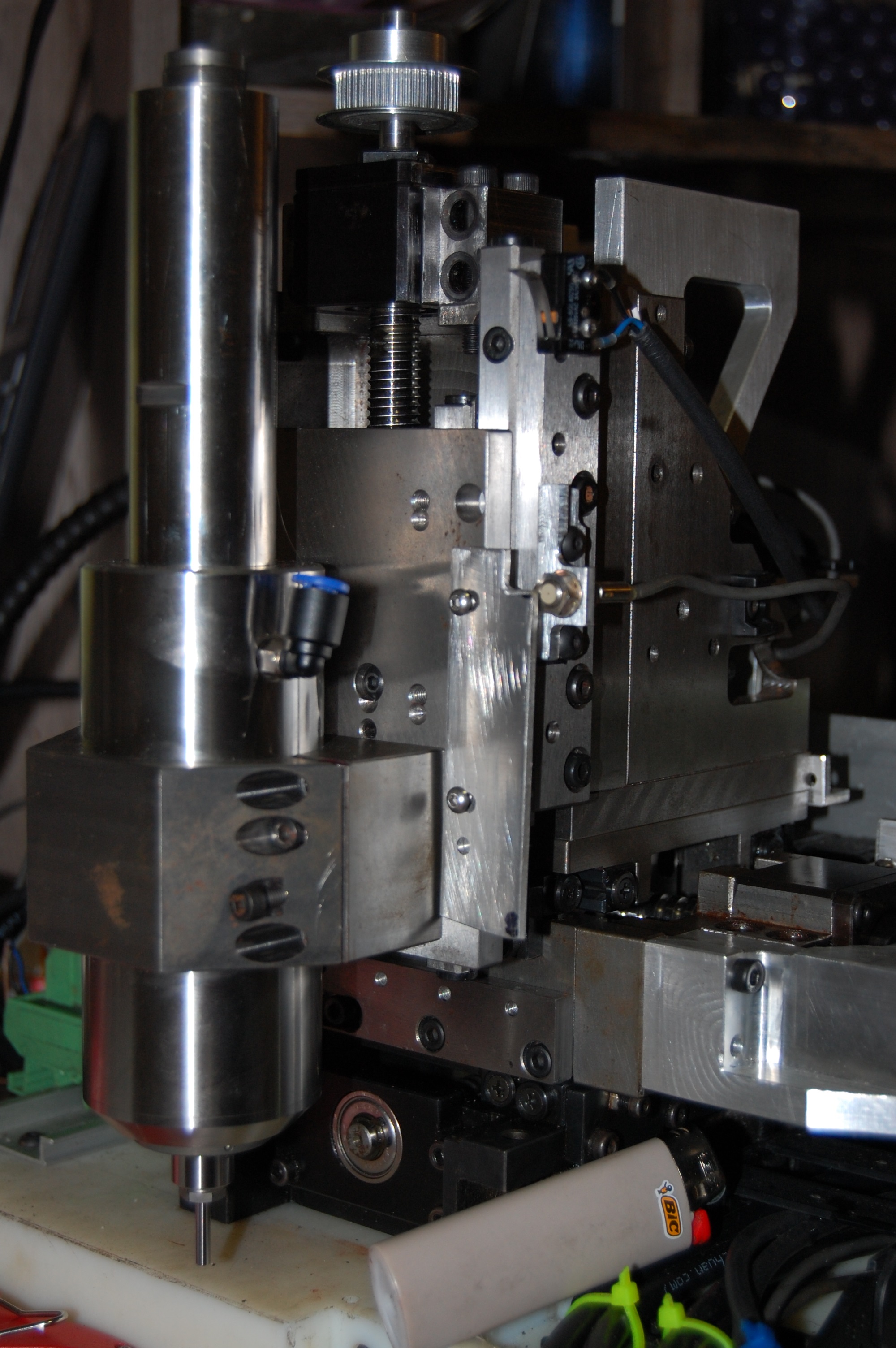

here is a picture of my machine with the spindle in question

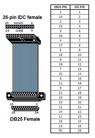

not even thinking, Ive wired everything with IDC pinout instead of DB25 pinout. luckily nothing blew up.

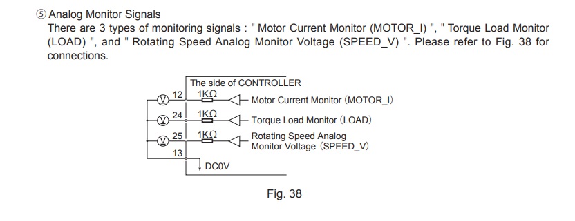

since im having a hard time getting the digital inputs to work(output signal I fig 32 and output II fig 33)and , cant seem to figure out the wiring on them, or if i damaged something,, they jus either never low, they are on high the whole time if i wire them to +24 as common. if i wire gnd to common, they are always low
i am starting on the analog inputs (analog monitor signals or fig 38) , but im running into an issue, which is great, i measue off the spindle controller .5v at 5000rpm, no problem.
when I plug in the analog in to mesa analogin0, and the ground to ground, I am now getting a reading of .284, and 10,000rpm is now .711
so i set my scaleso that worked fine for 10,000 rpm, but now something weird is happening. When i command it to 5000rpm to check the scaling, it can no longer go to 5000. it slides down to 4000. commanded speed is still 5000, the analog in reads 4000, and the spindle controller, which has its own feedback loop with readout, says 4000rpm. i can go 6000 and get 6000 on the controller and analog in. i can even command 5000 as the first spindle move, but after i got up or down i cannot get it to go back to 5000rpm
25 SPEED_V
Rotating Speed
Analog Monitor
Voltage
Output 10,000min-1 (rpm) / V
Output the rotation speed of rotating motor
with Analog Monitor Voltage.
0V ≦ SPEED_V ≦ 10Vwhen I plug in the analog in to mesa analogin0, and the ground to ground, I am now getting a reading of .284, and 10,000rpm is now .711
so i set my scale
uhhhh... 363000/.711 =258093, which gave me a reading of 5000rpm when its at 10,000, so ill *2 to get
.0.7i76.0.0.analogin0-scalemax 516186Please Log in or Create an account to join the conversation.

Ok, input/out problem somewhat solved. My spindle is an older model, with all sinking outputs. I have tied them to a pullup resistor and it is now functioning. I am now trying to close the loop with my spindle and am running into 2 issues. 1 issue is related to my 24v spindle tachometer, which ive put into the first post. It is a 24v signal with the rest of the controller outputs. since this is a 1 pulse per revolution type signal, at 30k rpm, thats 500 per second. would this be slow enought to use with the rest of the IO? the "working current" of the encoder signal is 50mA, where as the rest of the outputs have 100mA working current. what does this mean and how does it change my wiring?
The second issue is related to the analog outputs from the spindle going into the 7i76. i have the scaling and everything done reading mostly the correct output of the spindle +/- 44rpm. I have not hooked this up as a pid or anything closed loop. the analog outputs have a separate/isolated ground to the controller. when I hook it to the common ground, it actively interferes with the spindle analog output and alters my spindle output by about 1000rpm. , the spindle and controller still report the proper rpm, but linuxcnc thinks its going 5000rpm when its going 4000rpm. is there something i need to connect between ground? like a diode or capacitor?
