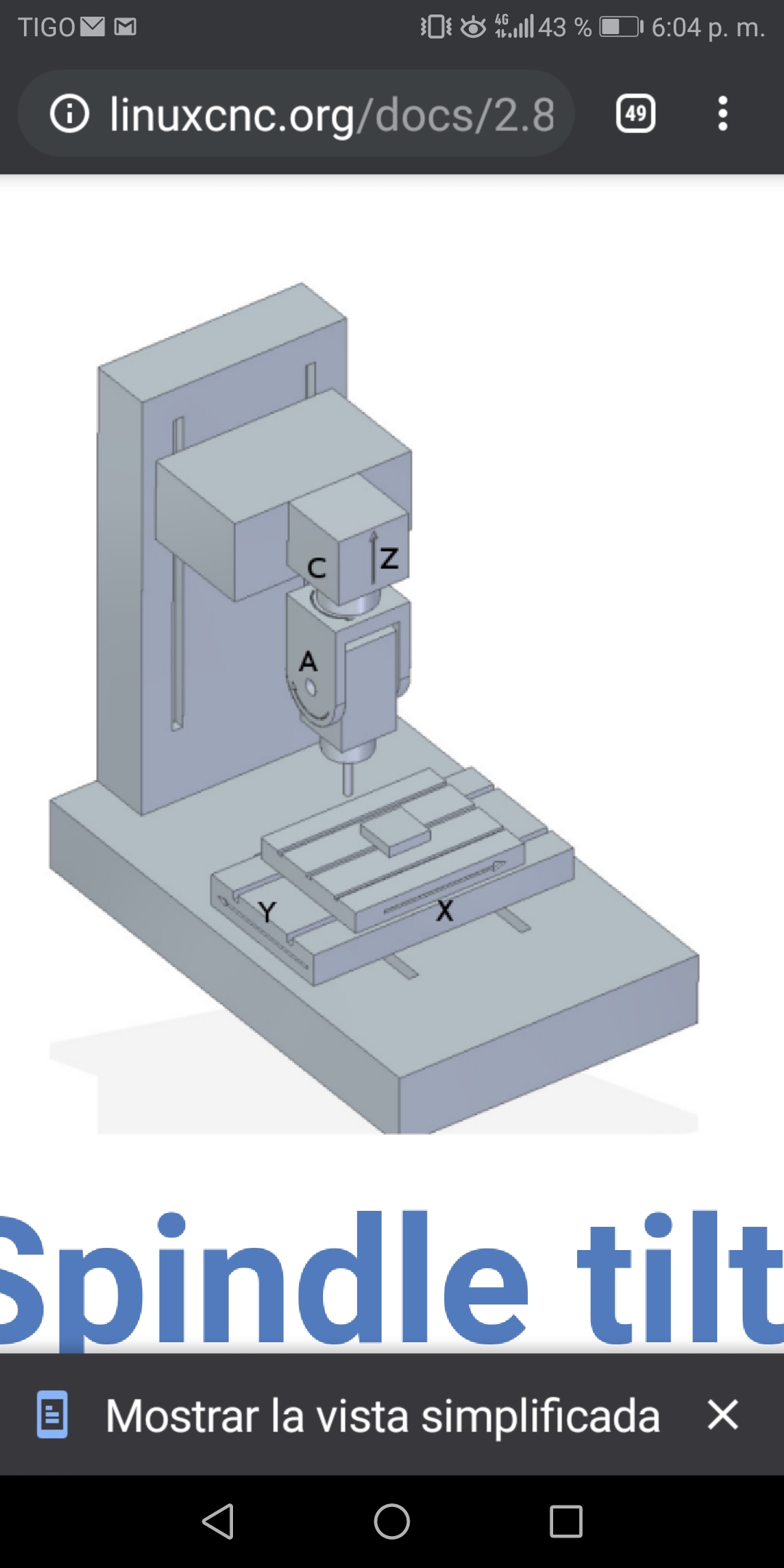

How can I modify etch servo configuration from a 2 axis to a 5 axis?
I bought a lpt pci port to have more inputs.
I can't buy servo drivers because I have no money :)
In the image below is the type of the machine that i wants to control

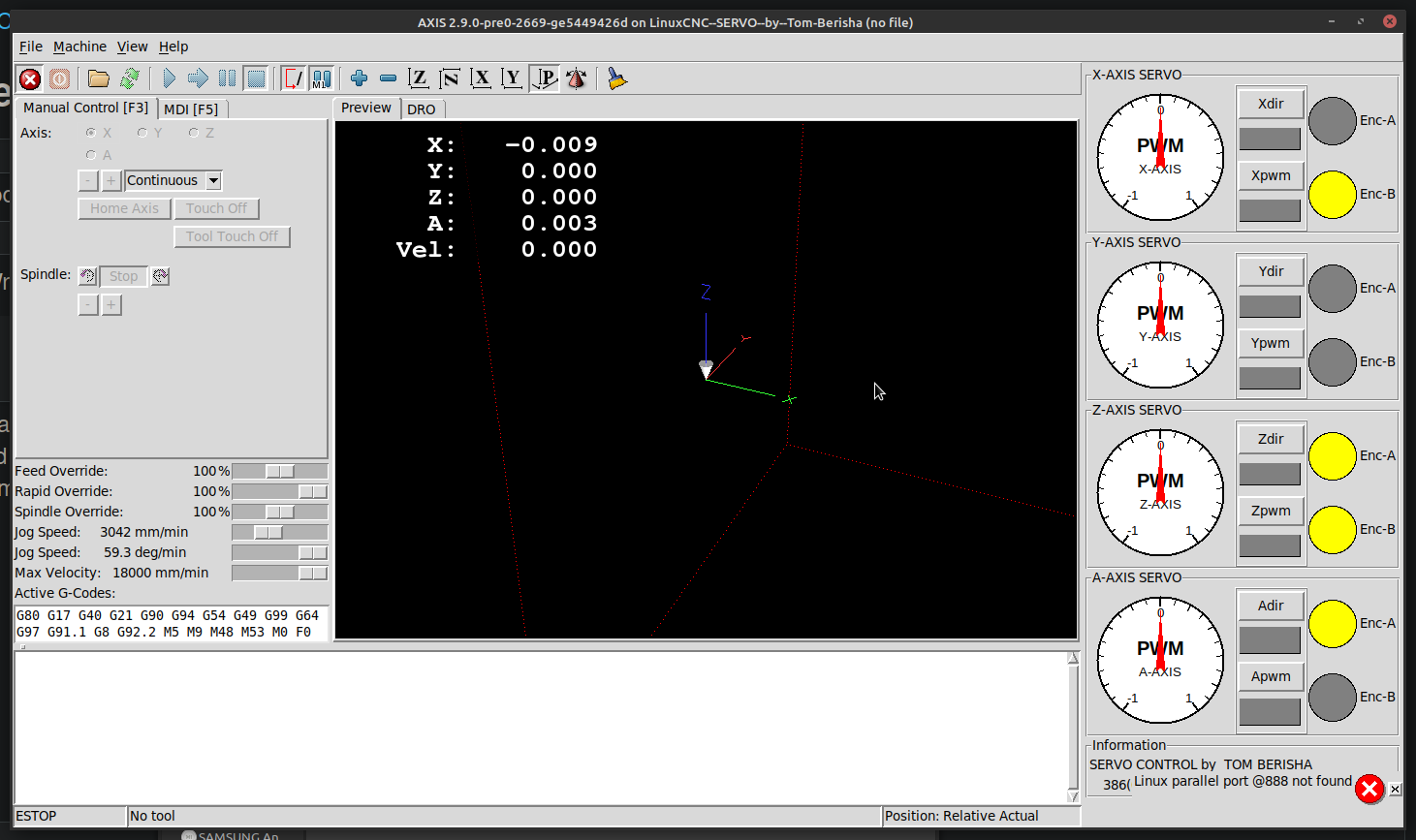

Attached you will find a ready made config with 4 axis and a VCP panel that shows everything from PWM output to encoder inputs, just add another axis.
Some editing required, but for 4 axis it works as is and it looks like this:

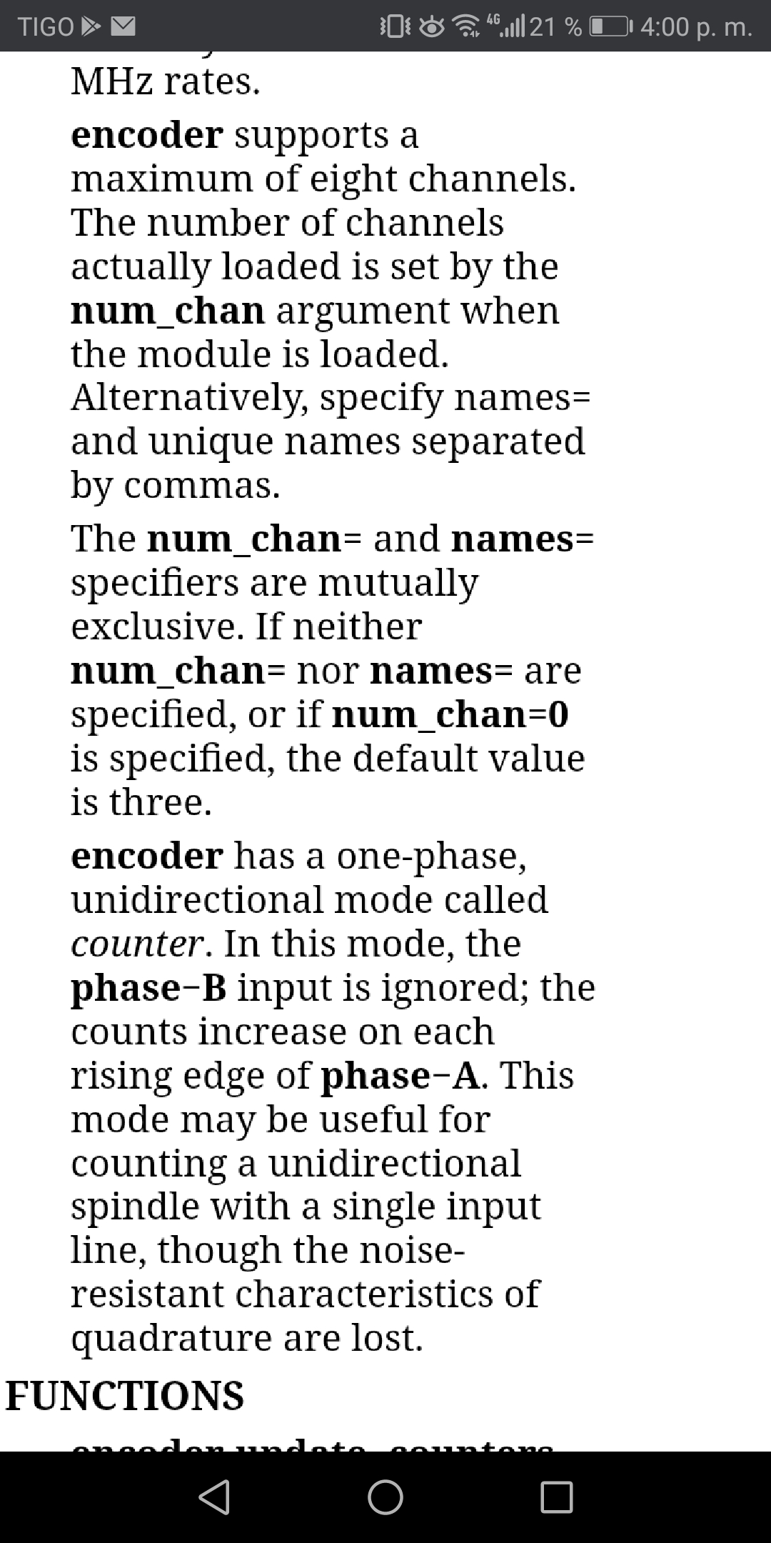

I think linux can only handle up to 8 encoder inputs, so what function should I add to the hal code to add a steper motor on the 5th axis?
30 Aug 2020 19:48 #180101 by PCW
Replied by PCW on topic Modified example etch servo to 5 axis
LinuxCNCs encoder component can handle up to 8 encoders. Why would you need more than 5 encoders? (or possibly 6 if you have a spindle encoder)

30 Aug 2020 19:59 - 30 Aug 2020 20:01 #180102 by Profed81
Replied by Profed81 on topic Modified example etch servo to 5 axis
I mean 8 channels, does that mean 4 servo motors?
Last edit: 30 Aug 2020 20:01 by Profed81.
30 Aug 2020 20:01 #180103 by PCW
No, that would support up to 8 servo motors with encoder feedback to LinuxCNC
