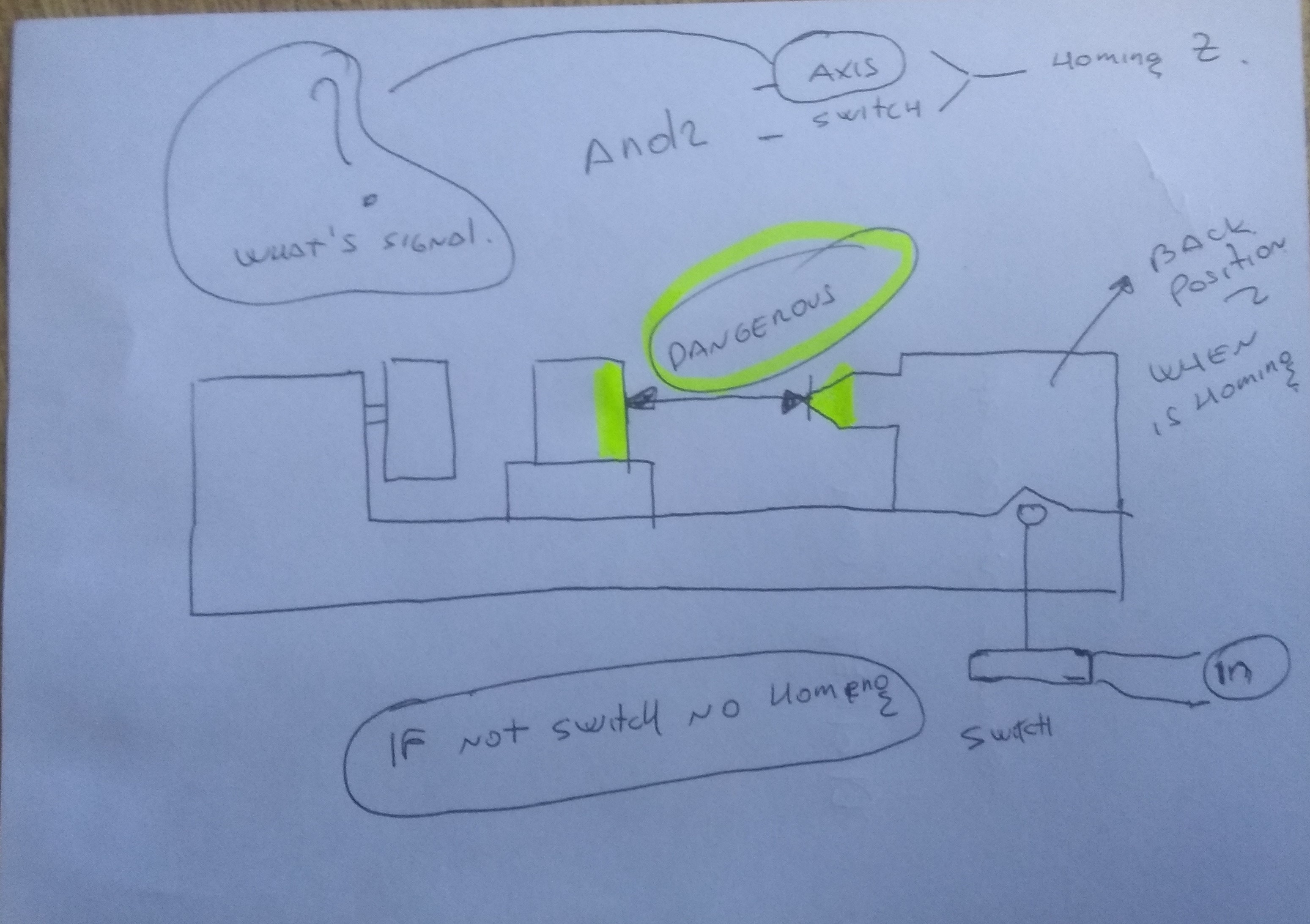

in a parallel lathe I want with a limit switch to verify before the home process for the Z axis that the tailstock (contrapunta) is removed.
I can't find the signal in the (axis GUI) that starts in the home process for the z axis or for all the axes.
I can see ......homed
......homing
......unhome
I am looking for the signal that I can read to make an and2 and be able to stop the home process so that it does not take place when the switch is not depressed.

I found this in the motion manual (V2.8) linuxcnc.org/docs/2.8/html/man/man9/motion.9.html
motion.homing−inhibit IN BIT
If this bit is TRUE, initiation of any joint homing move (including "Home All") is disallowed and an error is reported. By default, homing is allowed in joint mode whenever motion is enabled.

Thank you!!!. but I am using 2.7.15. and does not exist in motion. I need another solution to keep the latest version stable.

Ah, maybe use
axis.N.homing OUT BIT
TRUE if the joint is currently homing
And use your signal for "tailstock present" to trigger an estop? Maybe coupled with a message on screen?
Or maybe
axis.N.amp−fault−in IN BIT
Should be driven TRUE if an external fault is detected with the amplifier for this joint
Not really sure what this does though.

dear Aciera !!. Thanks to your help I was able to solve the problem, it's perfect !!! thank you!!!. I have learned a lot !!! regards
and2 in0> homing
in1> switch
out > fault
