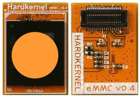

I'm not up with the terminology but I got the thumbnail sized 64 gb SSD, 4 gb RAM and their USB Wifi.
I ordered some SMC coax cables with a bulkhead connector so I can relocate the antenna to the outside of the enclosure. You can have one when they arrive but don't hold your breath.
Replied by rodw on topic Linux Mint 19.3 ISO
I ordered mine directly from Hardkernel, even allowing for postage and exchange rate it was so much cheaper than going through a local supplier.
Are you using SATA, EMMC or NVME drive ? If NVME what did you go for ?

Yup except somebody wrote 64 on the orange dot!

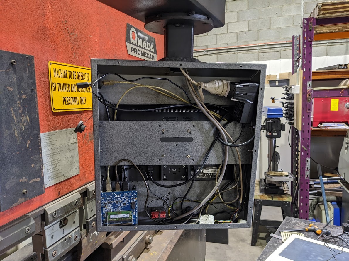

CNC is not disk intensive (simple sequential reads) so I don't think its an issue and keeping the small footprint is an advantage for an embedded controller in a console
Shown here running windows controlling a press brake with an Asus 15" touch screen monitor from Scorptec.
I'm gunna make something similar with the same hardware.

That's a neat setup.
- Posts: 12118
- Thank you received: 4138
10 Sep 2020 12:49 #181622
Yes, particularly now the touch screen works reliably. I always had in mind to do something like this for my plasma cutter but never really knew how to do it. I was forced to learn how to get this machine working..
Eventually the hidden wifi antenna will be mounted on top of the enclosure..
