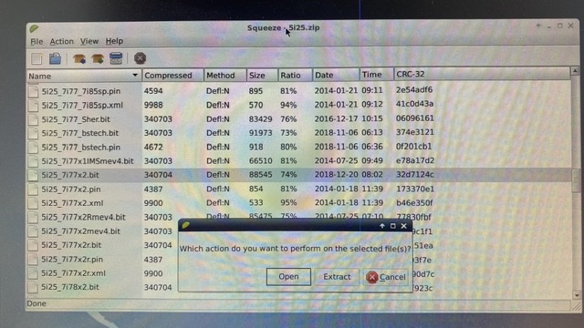

12 Sep 2020 21:27 #181936
by PMCD
Replied by PMCD on topic 5i25-7177 pack and go frimware
So how does a 5i25 zip. file load the 7i77 firmware.
- Posts: 18064
- Thank you received: 5308
12 Sep 2020 21:32 #181937
Replied by PCW on topic 5i25-7177 pack and go frimware
You unzip the 5i25.zip file. cd to 5i25/configs/hostmot2 and type:
sudo mesaflash --device 5i25 --write 5i25_7i77x2.bit
then
sudo mesaflash --device 5i25 --reload
then
- PMCD
- Posts: 41
12 Sep 2020 22:19 - 12 Sep 2020 22:28 #181939
by PMCD
I am doing something wrong. I got the zip loaded on a USB and got to here.
Last edit: 12 Sep 2020 22:28 by PMCD.

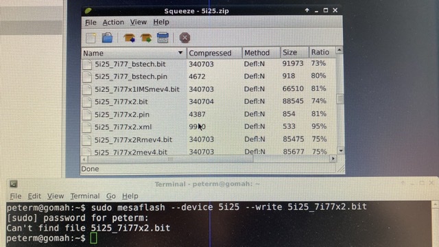

- BeagleBrainz
- Visitor
12 Sep 2020 22:32 #181941
by BeagleBrainz
Replied by BeagleBrainz on topic 5i25-7177 pack and go frimware
The file has to be in the directory you are giving the command or you have to include the full path to the file in the command.
So copy just the bit file you want to your home directory and run the command again.
Linux is like a Formula Ford, you need to put the effort in to get the most out.

- BeagleBrainz
- Visitor
12 Sep 2020 23:52 - 12 Sep 2020 23:57 #181946
by BeagleBrainz
Without any error messages or a description of going on it's near nigh impossible to work out what the error is.
Usually I just right click on the zip file and click on "extract here", which will extract the files into a directory, in your cased called 5i25, that is the same name as the zip file.
If you are having issues it maybe best to use google to search how to extract files on your particular version of Linux.
Last edit: 12 Sep 2020 23:57 by BeagleBrainz.
