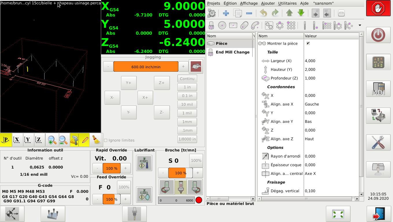

I had corrected the values of x min and max limits. In Hurcobug.ini , there is a small value in positive or negative.
I don't understand why you say z axis limit is set as a variable? It is set like the others, isn't it?
I had tried with servo period set at 1500000 Hurcobug.ini and it didn't change anything.
I managed to reproduce the problem with a config file present in the simulation examples. This is the example "Nativecam - 2.8 - gmoccapy - mill".
By loading a tool with a Z offset, then a g43. I open my little drilling file and play with the G54 offsets so that the machining is in the red "frame", and there it ends up showing a bit of anything within the machining limits. Look at the limits in X :0.87-60.87 or 0.71-60.71.
And Z axis limit min at -7 should not be in red.
Thanks.
Thanks.

I think this may have something to do with the fact that you use commas (,) instead of the decimal points (.) in nativecam.
[edit]
Do you normally use the comma in the french language? I know they do in germany but in switzerland we use the point.
[edit2]
Ok. just looked it up. Turns out the Swiss are among the odd ones in the non english speaking world.
Just looks odd to me your tool diameter has a comma 0,0625 and the offset z has a dot 0.0000.

In this test I didn't touch nativecam. These are the default values.
The toolpath comes from a .nc file.
The tool diameter must come from a diameter in inch. Default values too.
For the offset z at 0, just one connection is missing in hal for the display.
Bruno
