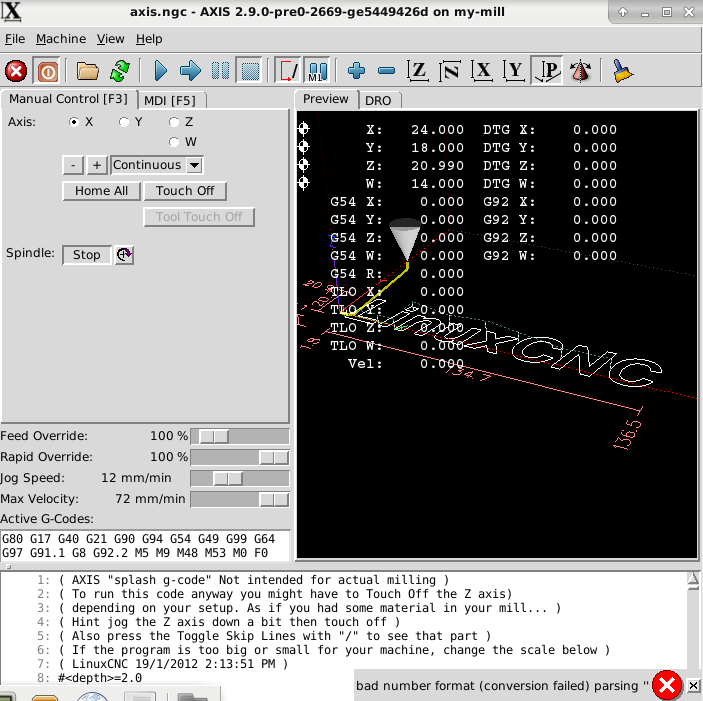

Hello, I am trying different things with the configurations of my whb04b-4 pendant and for example I would like to move my Z axis to 10 and W axis to 20 when I press the macro-10 button, so for that I wrote the following Gcode command on the ini file: MDI_COMMAND= G1 Z10 W20 F4000. But when I try it I get the bad number format(conversion failed) parsing.. error.
Can someone help me out?

Just in case you use release 2.8.0 , comments must be on separate line. I would fix this first.

For example, lines like this will no longer be accepted:
MAX_VELOCITY = 7.5 # This is the max velocity of the axis.

Thank you, it worked once I moved the comments! But may I know why I have to press multiple times on the button to get to the postion with this command MDI_COMMAND= G1 Z10 W20 F4000 ?
