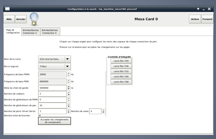

27 Sep 2020 10:16 - 27 Sep 2020 13:10 #183960
by jefsaro
mesa 5i25 7i76 was created by jefsaro
Last edit: 27 Sep 2020 13:10 by jefsaro.

27 Sep 2020 11:07 #183966
Replied by tommylight on topic mesa 5i25 7i76
Click on "accept changes....."

27 Sep 2020 12:58 #183972
by jefsaro
Replied by jefsaro on topic mesa 5i25 7i76
I did it it doesn't change a thing

27 Sep 2020 13:14 #183976
by jefsaro
I have the 5v and the power supply on the 7i76 and the leds are on

27 Sep 2020 13:20 #183977
by jefsaro
mother board is Q1900 B itx

27 Sep 2020 13:21 #183978
Replied by PCW on topic mesa 5i25 7i76
pncconf doesn't look at the hardware when configuring so it will work with no
5I25/7I76 at all.
I think this is a known pncconf issue with non-English locales. you might post this
in the pncconf section along with your LinuxCNC version

27 Sep 2020 14:26 #183983
by jefsaro
i just installed linuxcnc on another pc with the same config and it's the same thing.
thank you i will post on pncconf
