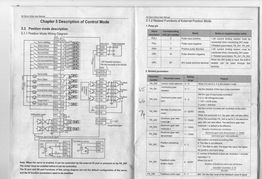

I am currently using the parallel breakout board and the spindle driver manual looks like this :

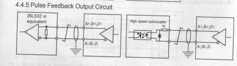

There is a Pulse Feedback output circuit with a Frequency division Filter. I assume the Frequency division Filter can be used to output 100 pulses per revolution to LinuxCNC ?
There is also a circuit to use a 26LS32 to get a Phase Output. Do I connect the output of the 26LS32 to the input pin of the breakout board for each phase ?
The other question is there are only Phase A , Phase B and Index spindle input pins where would i connect the Spindle index input pin to ?

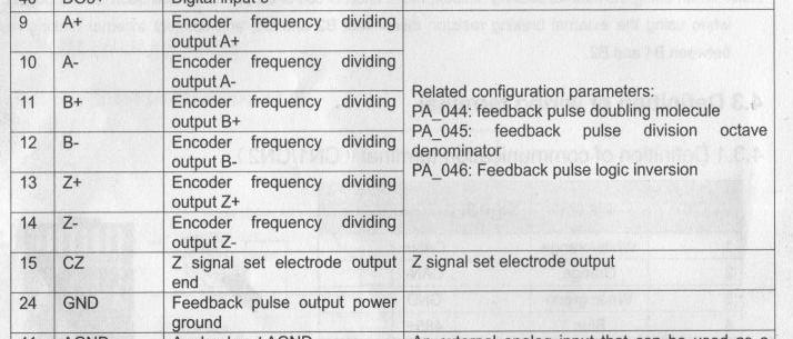

Thank you for the help ! I am new to all of this and just want to make sure my understanding is correct. You say the Z phase and Index spindle pin is the same do i just use the Z output after it went through the DIFFERENTIAL LINE RECEIVER or do i use the CZ pin as the spindle index pin ? Complete Manual
01 Oct 2020 09:36 #184471 by andypugh
Replied by andypugh on topic How to Spindle Synchronized Motion
You might not need any line transceiver. It rather depends on the spindle drive output voltage and the specification of your breakout board.
Does the BoB have any information about connecting differential signals?
CZ is "Z signal set electrode output end" which is gibberish to me.
I think I would connect pin 24 to the BoB digital GND and then try connecting A+, B+ and Z+ to individual input terminals. If that doesn't work then try the A-, B- Z-.
Use Halscope to check the inputs directly at the p-port driver in LinuxCNC.

I am using the Mach3 BOB . I already bought the 26LS32 IC, reading up on its function it seems to remove noise from any interference to output a clean signal. My volt meter reads -12V to 12V from ground on the Positive and Negative Servo Driver Phase Pins, so i assume that would be too much for the BOB to handle.The 26LS32 output is 5V.
After connecting the 26LS32 up with some LEDs the Phase A and Phase B act like a Binary Counter and The Phase Z(Spindle index) will stay on and only switch off and then back on again at a certain position on the motor shaft after making 1 rotation.
Does that behavior sound right?
01 Oct 2020 13:35 #184493 by andypugh
Yes, that's all good.
01 Oct 2020 13:42 #184494 by andypugh
You have probably already realised this, but you want the line-driver as close as possible to the BoB, to maximise the benefit of the differential pair signalling.
