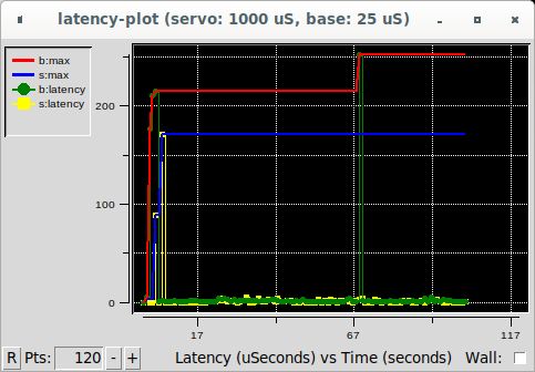

Looks like there are some relatively huge latency spikes
when LinuxCNC is running. Did you run a latency test?
I did one about a Year ago when I was building the system for the first time. It was not too bad...
I've now run one and it is waaay worse... Attached a new plot.
Possible work-arounds if you cannot fix the host latency issues are:
1. Make the maxerror smaller so the maximum velocity modulation
range due to latency is reduced (if you go too small the PID loop will lose
control since it will not have enough range to correct for LinuxCNC <->
5I25 timebase differences)
2. Make a bitfile with the DPLL module and use it to re-time the stepgen
position sampling.
3. Lower the servo thread rate to 500Hz or so
Thanks for that new input! I'll look into these options next!

I've tried a few things mentioned but only got slightly better results. I then comitted to a fresh Install, which fixed all the issues with latency. I really don't know what could have caused this but it might have been a kernel module that I didn't install for my wireless interface this time. Even the new bitfile and configuration made with pncconf are now working as they should.
So, thanks everyone for your help! I got a lot of good input from you and it might help someone else who encounters the latency issues.
