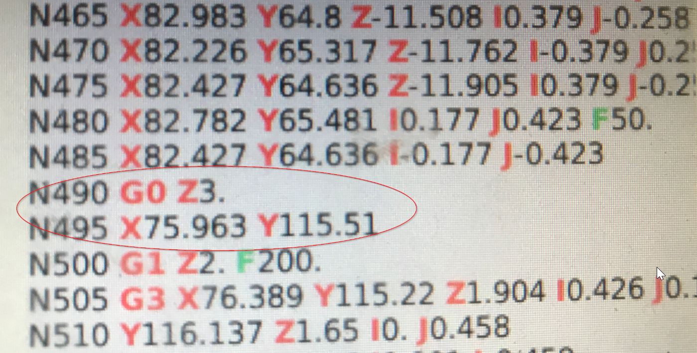

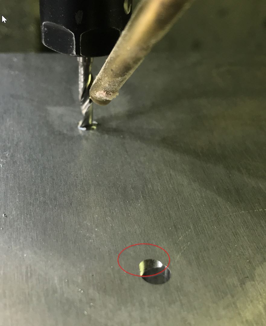

Hi guys,
I wonder what's going on with my G0 movement.
My mill is at Z-11, then 2 G0 statements come after each other.
G0 Z3
X... Y..
What I can see is that x/y coordinates are changing way before Z reaches 3 - it starts so early, before Z0! so it gouges the part.
Happens even when rapid feed rate is reduced to 1%. I can of course change the post to use G1 to go to safe zone.
But I'd rather understsand why G0 behaves like this. I heard of machines who will do unsynchronized motion, but this should be sth different.

Sorry it took so long, today I found another perfect example (forgot to use feed instead of g0)...
There you go:
even though the code says to move to Z4, then X/Y, the machin stops before reaching Z4 and only continues to move in Z when I execture the next step which is a X/Y movement.
You can see it clearly in the video.
Looking forward to opinions!!
Regards,
Daniel
There you go:

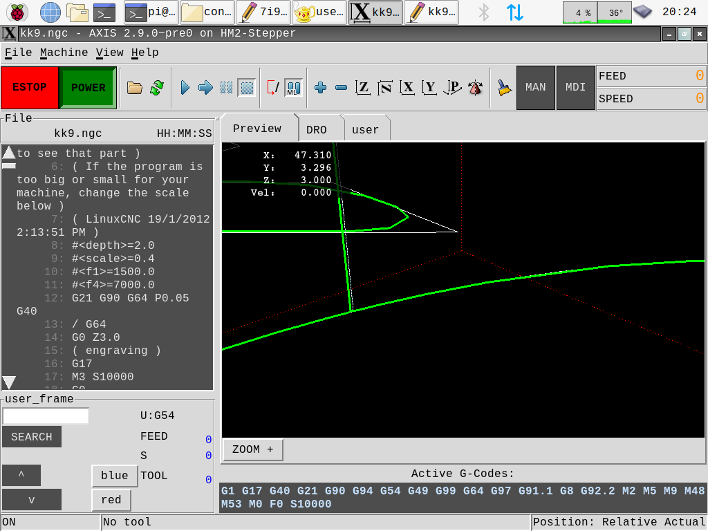

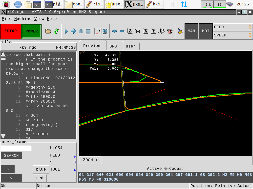

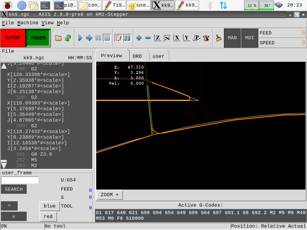

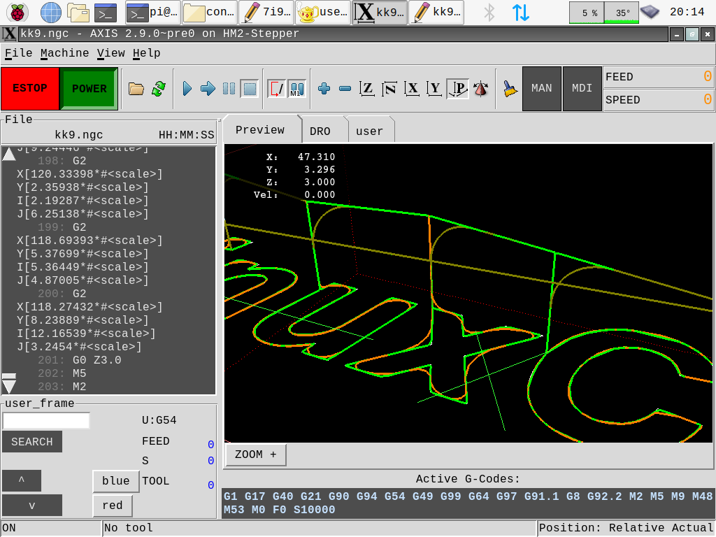

Replied by cakeslob on topic G0 movement gouges part
honestly, i just wanted to play with the colour changing toolpath thing that recently was added by cmorley (thanks for the help) , I am getting similar values to what tommy is getting in regards z height, ( mine are .5mm and 1.879mm), but the entry on the letter c is what caught my attention,
this is G64 P0.05
this is just G64
this is both
the entry into the arc on the letter c is better(?) with G64, than on g64 P 0.05, all the others are seemingly predictable, im going to assume, based on the line legment length, for G64, but there is no blend on when entering on an arc, while p0.05 stays uniform the entire time. I dont know what it means, or if its a problem, I just found it interesting. I usually program an overlap on a contour toolpath anyways
this one just for kicks, colours reversed on this one
