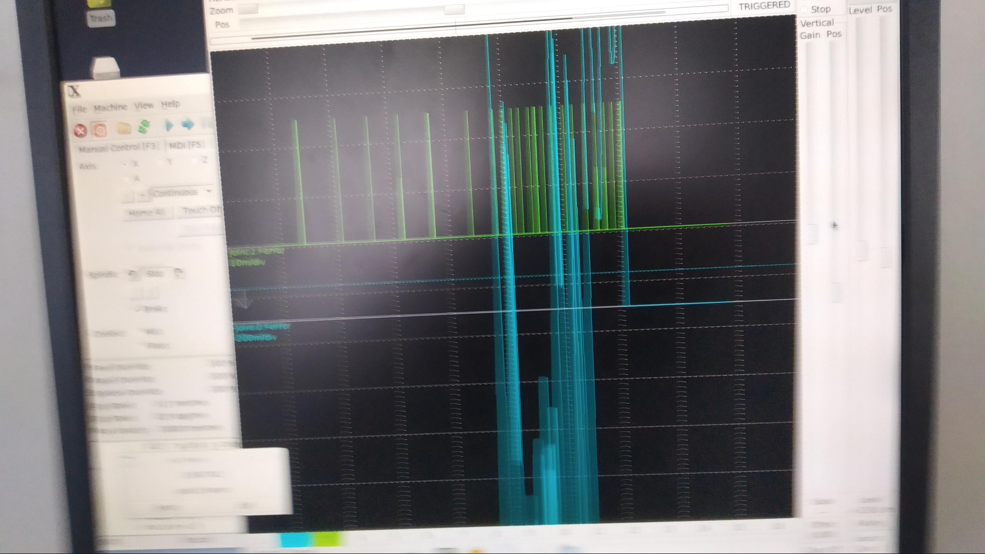

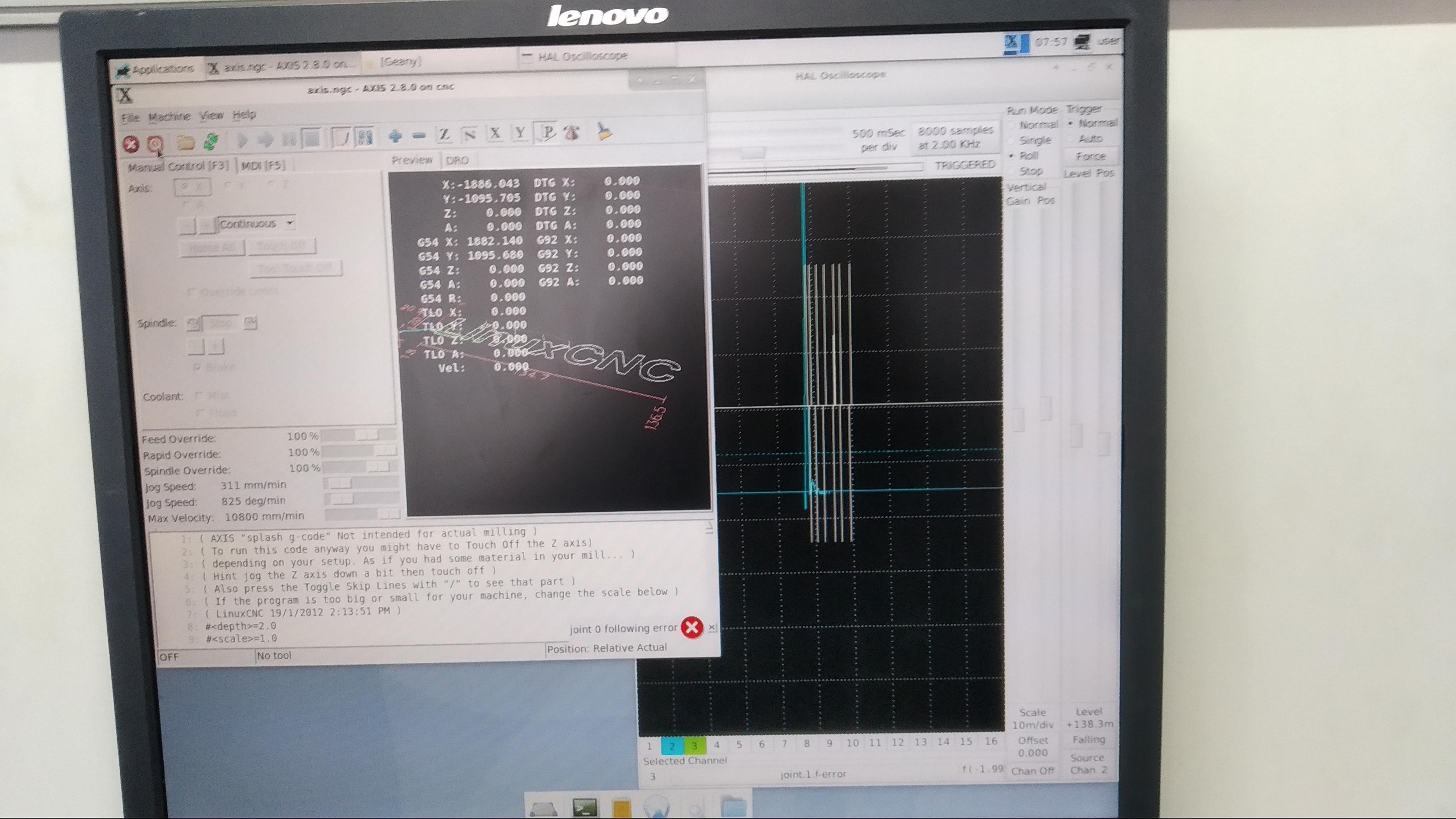

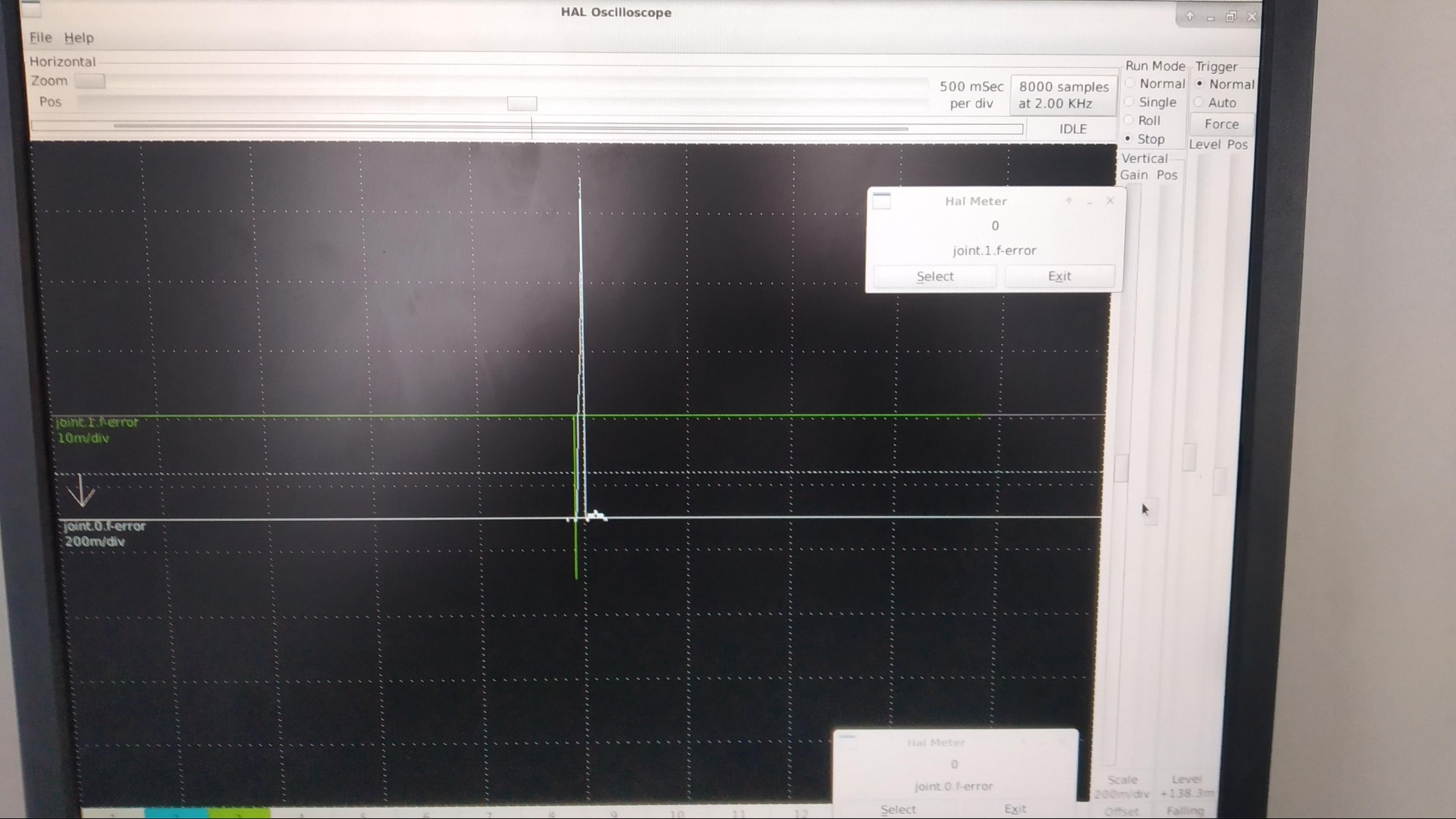

23 Oct 2020 12:50 #186999
by aleksamc
Replied by aleksamc on topic Analog Servo runs at maximum speed at start
Yesterday, when I finished configurations of axes everything was OK. I tried to jog all axes, configured homing. Everything fine. Here is halscope of axes.
Today all motors are connected mechanicaly, so f-error is configured on low value.
All next photos are my tries to turn linuxcnc. Even with f-error 5mm, I get turn off from axis X (joint 0).
And I must say that machine is also jittering.
As you may see, joint 0 gives big spikes of error.
I also tried when I start decreese P value to 0.05 but it doesn't help. I also tried to change servodrives for this mototrs, first one was 3.7kVA for 22A, I set others 12A, 2.2kVA. Motor is 1,5kVA. Joint 1, where is small motor installed is fine and stable.
When I disconnect analog signal from motor it in stand still position.
My version is that the quality of control position by servodrive depends on ohmic resistance of the motor. When it's cold in the room, here is 12 by celsium, it can't control motor. But when it's turned on, it's heated a little, ohmic resistanse increases and it become controlable.
What your versions? How can I solve this problem? At lease for the start of the motor for standing without movement.
- Posts: 18084
- Thank you received: 5317
23 Oct 2020 14:11 #187002
Replied by PCW on topic Analog Servo runs at maximum speed at start
Can you add the feedback position and PID output to the plot?
Its hard to tell where the problem lies without additional data

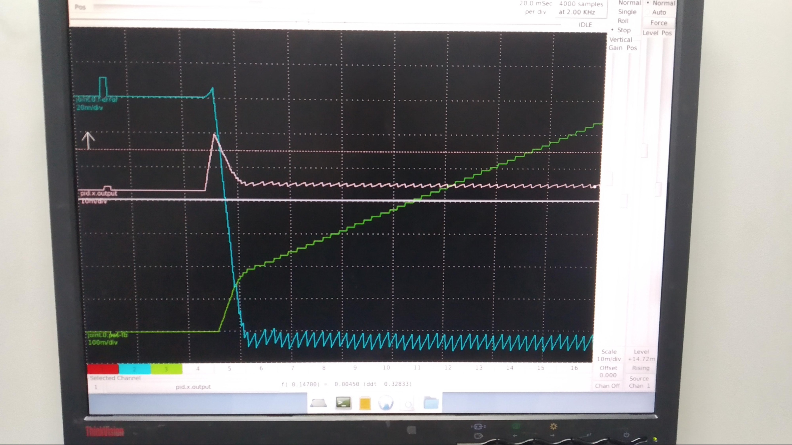

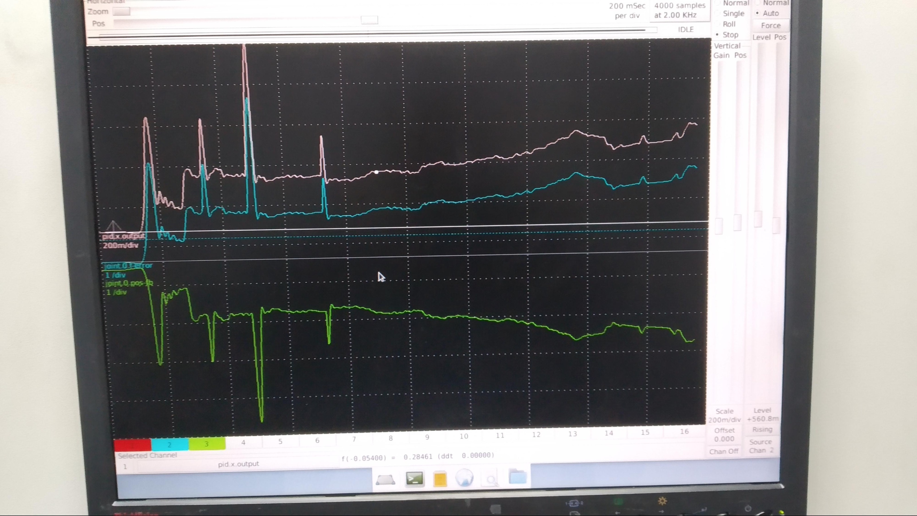

27 Oct 2020 04:59 #187368
by aleksamc
When I started at first I had such transition process
Then I reconfigured axe from start, I decreased BIAS to 0, I suspect that BIAS=0.02, as I had give big problem. I made configuration milder without integral and Derivative parameters and at the end received suvh transitional process in work.
Today, when motor is cold I will check if everything is fine.

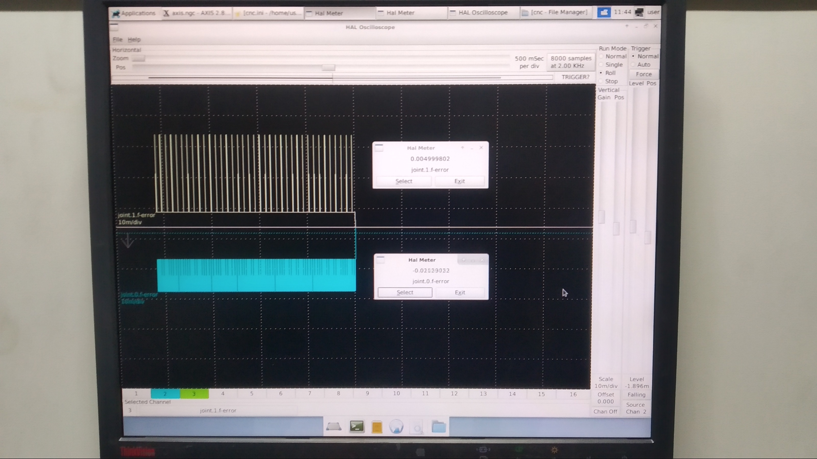

27 Oct 2020 07:26 - 27 Oct 2020 07:58 #187382
by aleksamc
I tried today to run. But the same situation, it doesn't catch position and turns of from increasing f-error.
It seems that one chanel of 7i77 have BIAS that deppends on temperature.
BIAS between output (0.0V) and vitual output decreased to -0.43V
Suddenly BIAS change to 0.9V (to positive direction), it gives spike of f-error and turn off.
Machine stabilized but with big f-error. I see on the scope output sinal -0.9V but measurement by multimeter gives me 0.0V.After 20min of trying to move
After 5 min when I write this topic
Last edit: 27 Oct 2020 07:58 by aleksamc.
- Posts: 18084
27 Oct 2020 14:38 - 27 Oct 2020 14:42 #187423
I looked at the pictures you sent, and if you have a drifting output, it really seems like
there is an ionic contaminant on the card, I first thought it was flux, but flux residue would
not cause this issue. Can you see if the residue washes off with water?
If its not flux, honestly it looks a bit like Coca-Cola...
