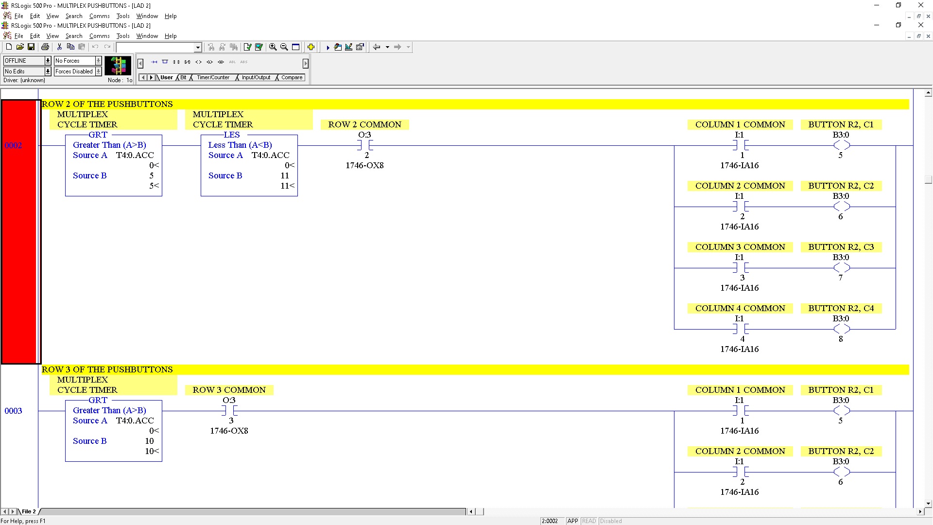

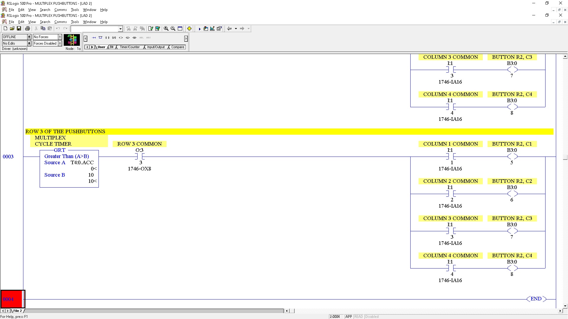

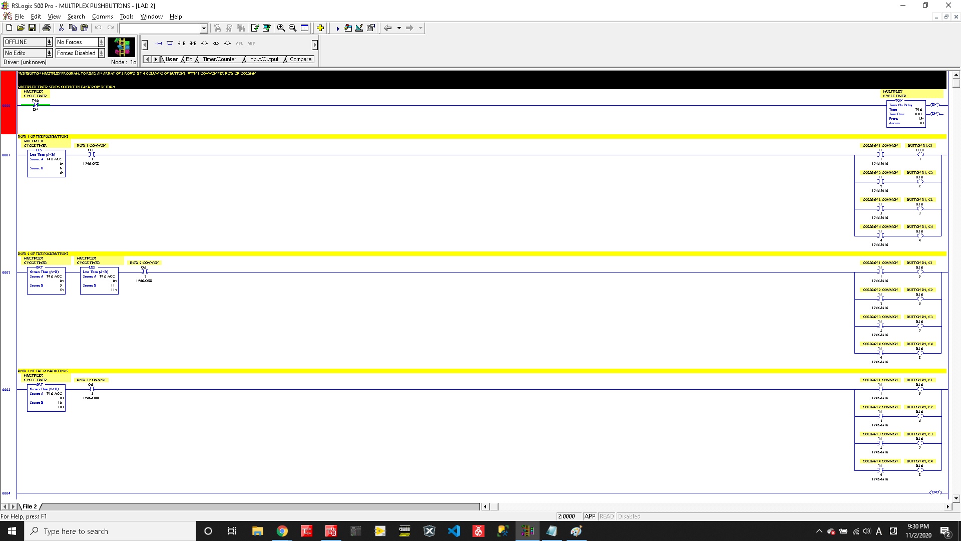

Replied by Himarc3D on topic Control panel, MUX wiring help
Classic ladder isnt another option?
here one example using ladder for RSLogix500 (have many ways to do it using scan logic)
Mitsubishi offer free simulators just need to become member.
FX-TRN-BEG
FX-TRN-DATA
FX-TRN-POS
The last two just in japanese (shame) the DATA teach how to handlle 7 segment displays, BCD, keyboards, thumbwheel, outdated stuff (win98) but still usefull but now low end HMI is very cheap...
This one is another one nice for learn but isnt free like Mitsubishi
www.thelearningpit.com/lp/dwnloads.asp
www.youtube.com/results?search_query=FX-TRN-BEG
Give a try to Classic Ladder, have many ways to skin this cat.
SOR XIO T4:0/DN TON T4:0 0.01 15 0 EOR SOR LES T4:0.ACC 6 XIC O:3.0/1 BST XIC I:1.0/1 OTE B3:0/1 NXB XIC I:1.0/2 OTE B3:0/2 NXB XIC I:1.0/3 OTE B3:0/3 NXB XIC I:1.0/4 OTE B3:0/4 BND EOR SOR GRT T4:0.ACC 5 LES T4:0.ACC 11 XIC O:3.0/2 BST XIC I:1.0/1 OTE B3:0/5 NXB XIC I:1.0/2 OTE B3:0/6 NXB XIC I:1.0/3 OTE B3:0/7 NXB XIC I:1.0/4 OTE B3:0/8 BND EOR SOR GRT T4:0.ACC 10 XIC O:3.0/3 BST XIC I:1.0/1 OTE B3:0/5 NXB XIC I:1.0/2 OTE B3:0/6 NXB XIC I:1.0/3 OTE B3:0/7 NXB XIC I:1.0/4 OTE B3:0/8 BND EORMitsubishi offer free simulators just need to become member.
