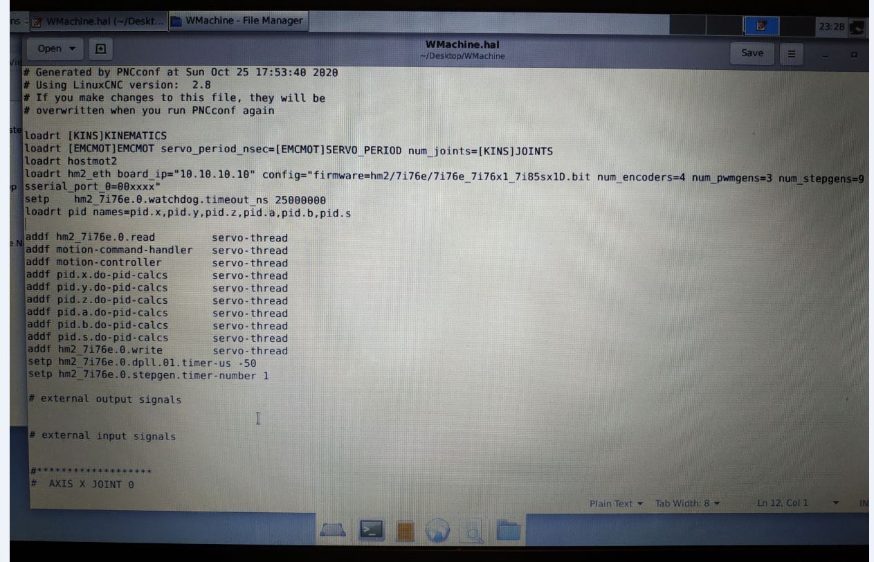

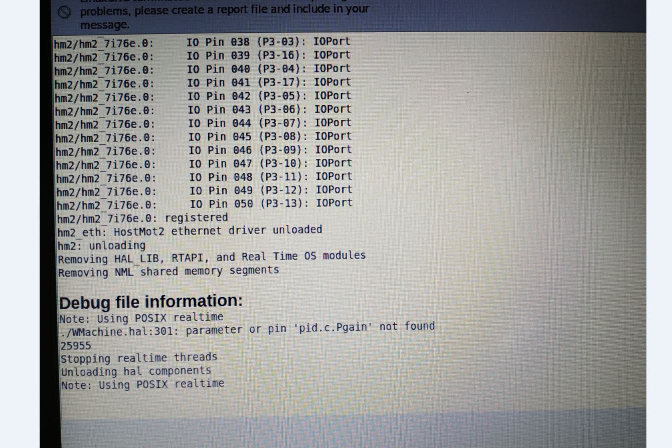

Actually I'm facing some problems to integrate them , i used the firmware 7i76e_7i76x1_7i85sx1D.bit ,
the 7i76e card connected 100% , for the 5 axis , but when I increased the axes to 6th , I got a message as attached photo ..
Any help please ..
Any help please ..

Replied by PCW on topic 7i76e+7i85s Mesa Integration
You (or pncconf) did not create a pid.c in the loadrt pid line
- Hamel2020
- Posts: 74
26 Oct 2020 16:01 #187321
by Hamel2020
Replied by Hamel2020 on topic 7i76e+7i85s Mesa Integration
Ooops .. you are right ..
Thank you very much
Thank you very much

- Posts: 18064
- Thank you received: 5308
26 Oct 2020 19:25 #187333
Do you have the required addf statement for pid.c?

Unfortunately ... I do not have ...

I established addf component .
It works ... thank you for help ...
