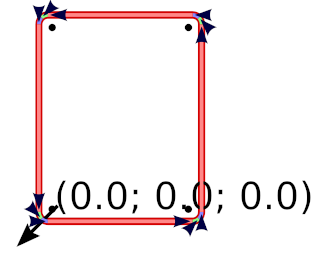

Hello
Attaches is a very simple drawing made in INKSCAPE 0.92.
I use the Gcodetools to generate two files, one for the wholes (4 points) and an other one to cutout the material.
The wholes are made with the DXF - Point extension from.
My problem is hat when cutting a plexiglass with LinuxCNC the 4 points (Drill-Wholes) are not exact i.e the 4 wholes are always nearly 1mm drifted to the right.
Thank for help
Martin

Ok I reply to myself as I found a way.
Marking the drill-wholes with circles and not points as I did in Inkscape and then applying Stroke to Path and not Object to Path made it work.
Now, using DXF in GcodeTools works as expected and the wholes are precise where they have to be.

This is not how to do it:
Here the correct way:
The entrance point of a DXF (drill-whole) created with Gcodetools is where the arrow points at the attached image (the small rectangle).
So, if the circle diameter is 2mm one has to make an offset of 1mm. In other words when the CNC machine is homed than the y-axis has to be set plus 1mm. Of course if the circle has a different diameter the offset value differs.
I apologize for the confusion at the previous answer.
Kindly Martin
