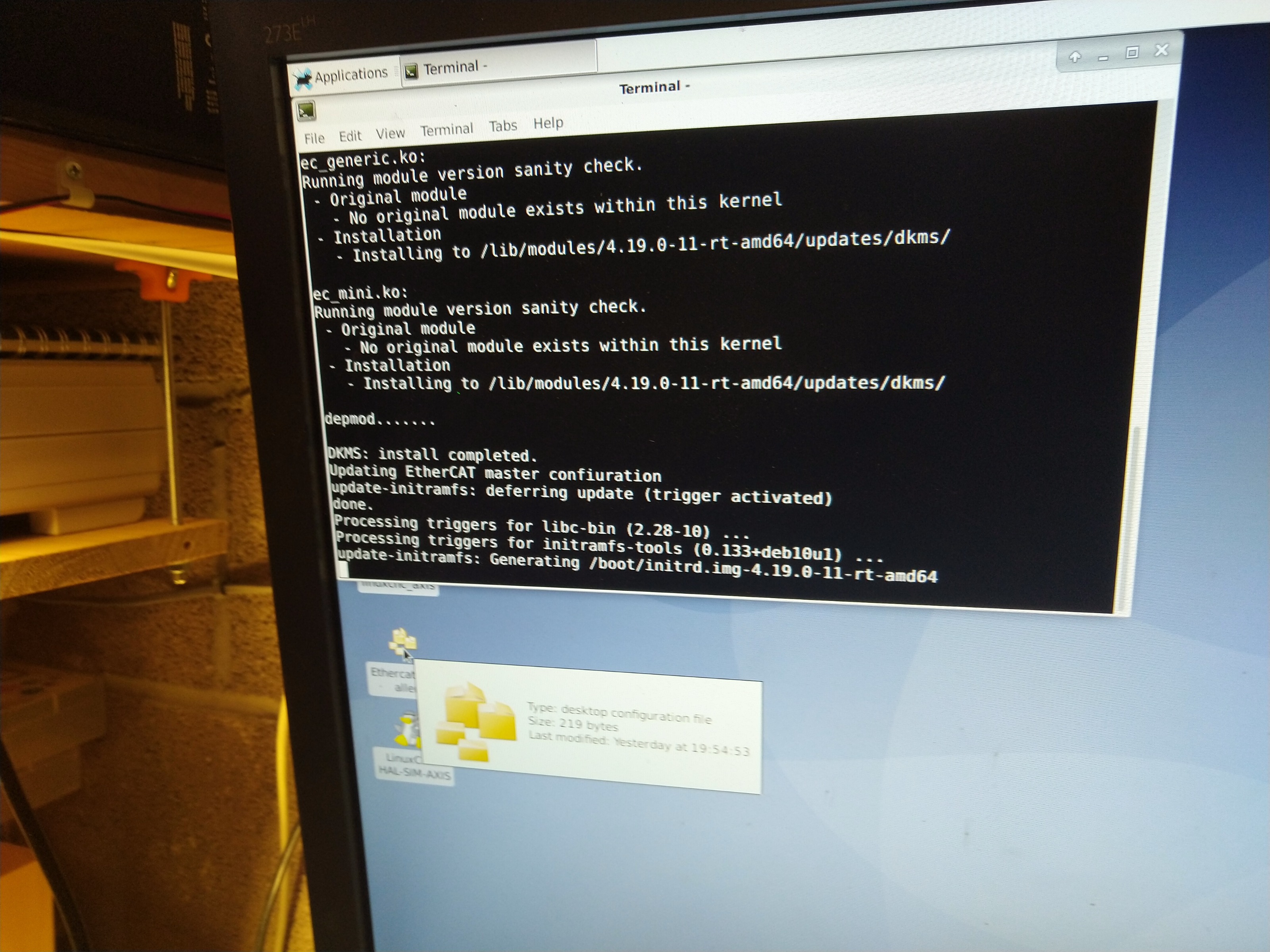

Another day and a good bit of time spent... But going nowhere fast
Ok... So I've downloaded and installed the iso recommended, but from then on I've not had much luck,
So the install script wouldn't run, I did some general distro updates, but nothing is working.
So as the steps are quite complex, and there does seem to be a different story depending on the forum post... Am I able to get set of tools and utility's I need that will allow the Ethercat install...
I'm nothing but confused...
Thanks everyone
Pb
Thanks everyone
Pb

Hi Pb,
Yeah, that's life man.
Ahaa, i think i know your problem.
During installation you must keep the administrator password empty. Wich has resulted in wrong priveleges.
I suggest you filled in a admin name + password, that's wrong. I just added this comment to the readme file.
Install the iso again. Read this also before install : github.com/grotius-cnc/LINUX_RTOS/blob/main/README.md
Oke try to fix this, and then report !!
Good luck and take your time !

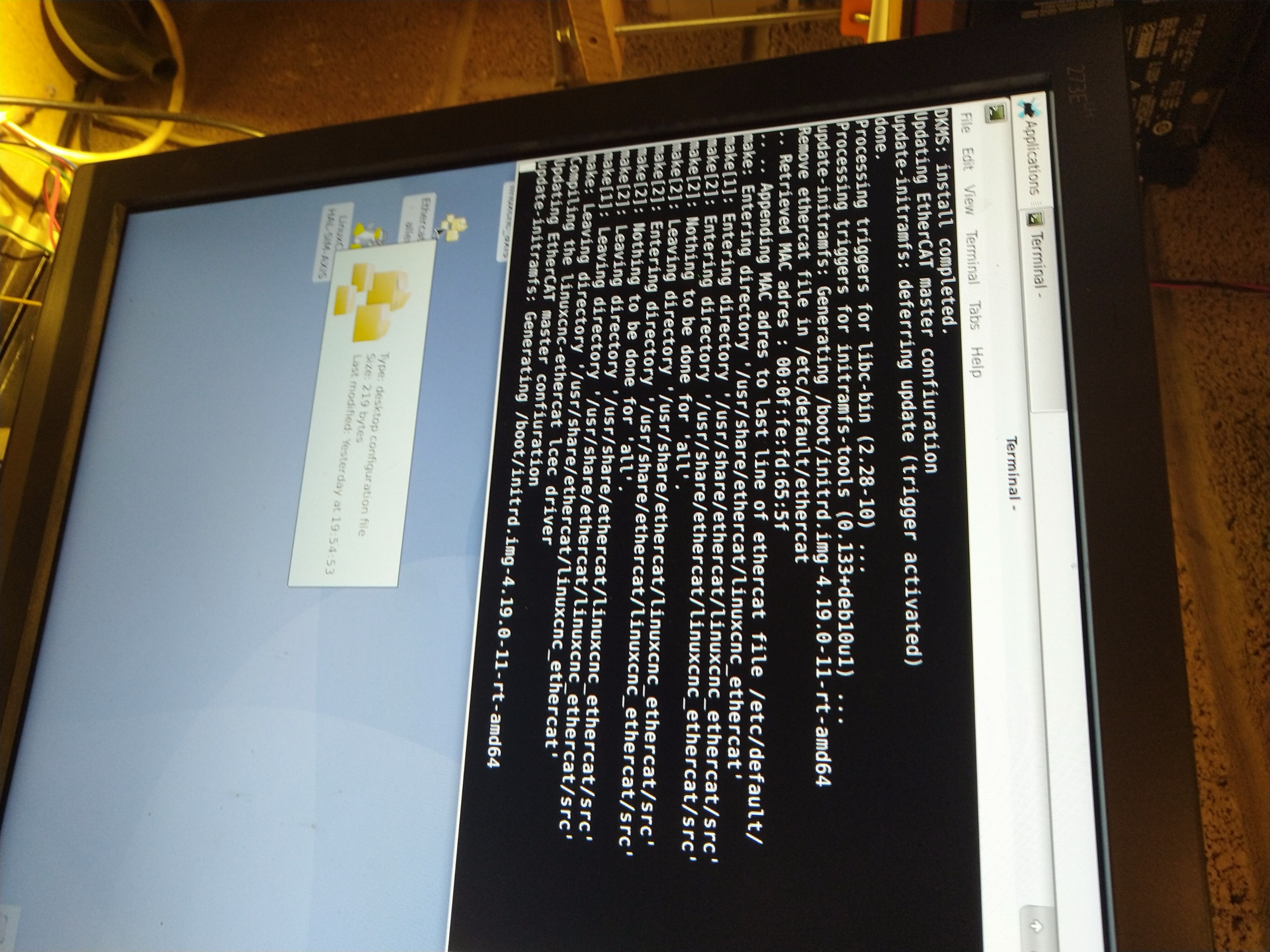

Wow thanks for the speedy response...
Ok... yes... I totally put a password in, so I’ve just kicked off the install again... and I’ll report back ASAP...
Pb
Pb

So... With a quick rebuild "which i think could be a primary skill when working on linux"
The way it worked is, you leave the root password blank, but it won't let you log in as root, so log in as the account you create (mine is called "cnc") and then run the install script... Which then does a boat load of stuff.. See the pictures below
I've stopped now for a moment... But ill check it out later...
Thanks for all the help so far
Pb
Pb

Ahh, that look's nice !!
Yes, when u want to be admin u use before a terminal command $ sudo
With a linuxcnc rip install don't use $ sudo make..
In this way linuxcnc will not start. Linuxcnc will not start as root. So in that case you have to recompile the rip after you did a make clean.

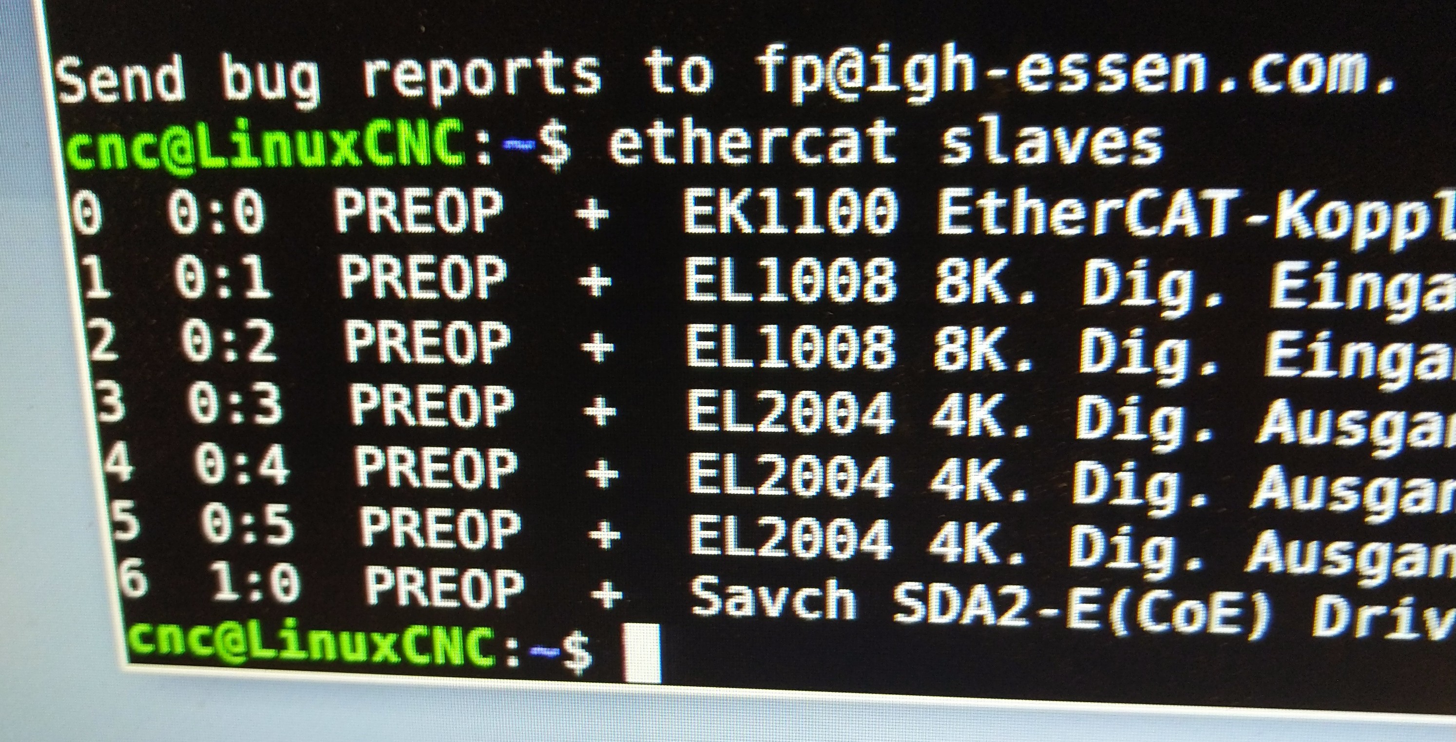

31 Oct 2020 17:29 #187928
by Padstar
Replied by Padstar on topic Savch Servo and ethercat control
Now I do have some beckhoff devices,
Here is a shot of the ethercat device list
Now I have one question, how can I change the ethernet card from the onboard card which its picked as being the ethercat master... Now it's not really important, but my experience with ethercat on raspberry pi is you can't share the adapter with things like modbus, or tcpip, etc...
Then also.... What's the next step... How can I do all the connecting of my inputs and outputs with Linuxcnc... Would I be right that we need to edit some files...
Pb
Pb

Hi, very nice !
This is the info on github with the iso :
After the ethercat installation, start the linuxcnc desktop launcher, the lcec will show up in Linuxcnc "show hal configuration". Add your I/O modules to your needs in the linuxcnc_axis desktop map ethercat-conf.xml. Connect your I/O modules to linuxcnc in the hal file, in this axis-qtvcp example it uses the qtvcp_postgui.hal file to connect the ethercat I/O
Just open your desktop map : linuxcnc_axis and edit file /Desktop/linuxcnc_axis/configs/sim.qtvcp_screens//ethercat-conf.xml
to your needs.
Its off iso :
In your case, following your terminal picture :
For the rasperri i can not advise you.
But there is ethernet over ethercat. You can read about this in spare time.
Ethercat is configured for your mac adres, you mac adres can be changed by terminal commands, even automatic.
This methode is used by kali linux for special purposes.
Now start lcnc. Look at halshow. If everything looks fine.
Just connect some lcec i-o pins to hal.
You can also test with halcommand : setp lcec. .. ..
Have fun, and take your time !
