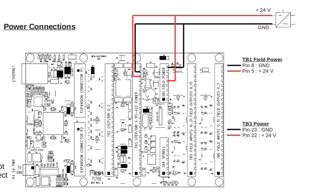

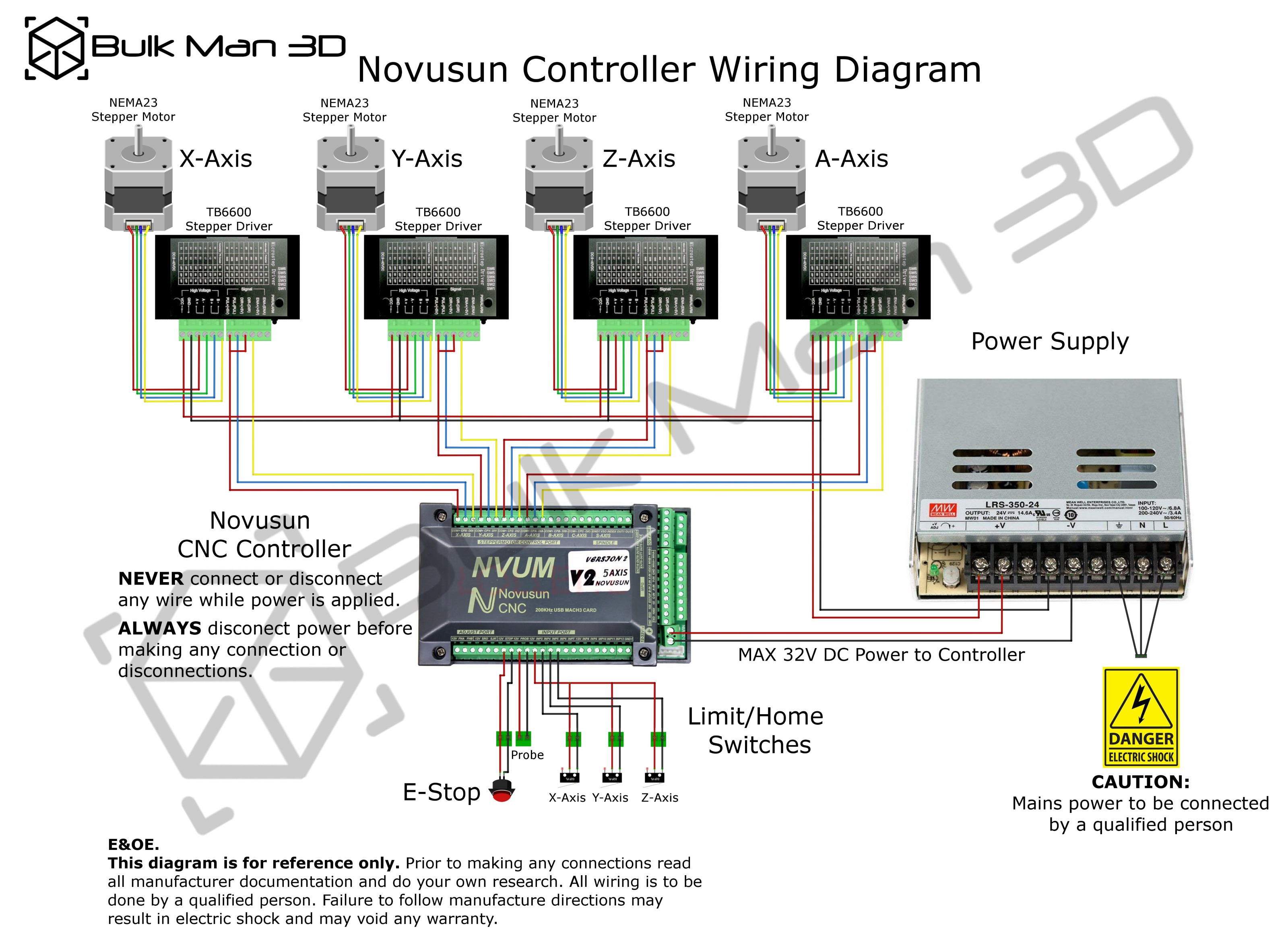

Brand new to LinuxCNC and mesa boards. I just ordered a 7i76e board and I am going to upgrade my current setup from mach3 and a cheap Novusun NVUM controller to Linux CNC and a 7i76e. Below is my current setup minus my Huanyang VFD for my 2.2 kw spindle. I am assuming I can power the 7i76e board off of my 24V power supply? Are there any wiring diagrams out there? If anyone could help me out that would be great!

forum.linuxcnc.org/27-driver-boards/3191...nnection-sheet#83565
Download the pdf attached to the first post.

Looking at the power section of that pdf, do I connect just one of those terminals to my power supply? If so, which one do I choose?

You need to power both sets of terminals with 24V I suggest you download the 7i76e manual as well.

okay, thanks!
