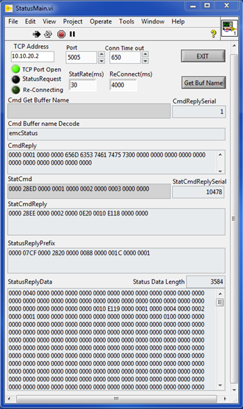

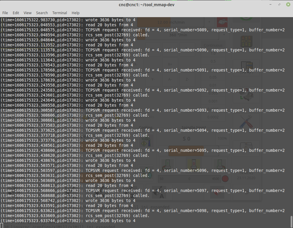

24 Nov 2020 00:40 - 24 Nov 2020 00:47 #190172
by auto-mation-assist
Replied by auto-mation-assist on topic Tool table issues
I went ahead and downloaded the dgarr branch, compiled it and installed my x1Mill info into the configs folder so that I could control my milling machine with gmoccapy 3.0.9.1. This allowed my to home the machine and then jog to known positions so that decoding of the raw emcStatus data that my Labview status peek process would send back to it via its network TCP connection.
I'm extremely happy with the results. The number of bytes that the emcStatus buffer has to handle has been greatly reduced and there is no bad data being sent even though the number of tools is set to 1001. Actual size of status data that is transferred via a peek request is now at 3636 bytes which gives 3584 actual data bytes after removing the the header and sync start pattern.
The below shows the data transfers being completed, 20 byte peek request acknowledgement which also has the number of bytes that will be sent. Note that command serial numbers will not agree between the pictures because the pictures were taken at different times.
The next picture show the receiving end which is my Labview panel that handles the connection and collecting the status data and routing that data further for decoding by its location in the status data and conversion of pointer values. The status data itself shows a lenght of 3584 bytes near the bottom right and near the top left and down a bit it shows that the buffer supplying this data is the emcStatus buffer.
The picture below shows that at offsets 1088, 1096 and 1104 is the main position data that is displayed for X, Y and Z axis.

24 Nov 2020 02:30 #190183
I was reviewing some of the information printed out in my terminal window during linuxCNC start up for this new tool format and found the following at the start of the list that were added by dgarr branch.
Starting LinuxCNC...
(time=1606184063.691686,pid=20671): Registering server on TCP port 5005.
(time=1606184063.692440,pid=20671): running server for TCP port 5005 (connection_socket = 3).
20677 IO: TOOL_MMAP yes emc/iotask/ioControl.cc
IO: EMC_STAT size= 10272
IO: EMC_IO_STAT size= 696
IO: EMC_TOOL_STAT size= 224
IO: CANON_POCKETS_MAX = 1001
