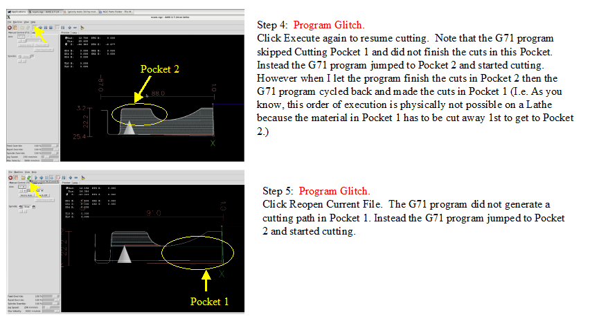

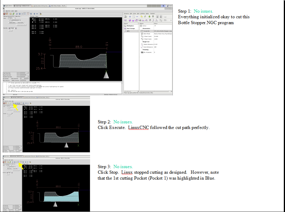

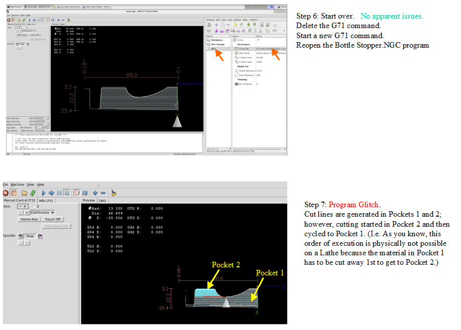

There is a glitch when using G71 Fanuc Equivalent and selecting the Stop button during program execution in Axis. When Run is pressed again the current Pocket operation is skipped and G71 starts on the next pocket regardless whether or not the current Pocket operation is completed.
I recently discovered a work-around which is to select the E-Stop button in Axis and not the Stop button. This is not ideal, but the G71 program works like it should by starting over.
Does anyone know a permanent fix?

Replied by Aciera on topic Fanuc G71 G72 Equivalent
If this is an unknown bug you might want to report that on the github page since it will more likely be read by somebody from the developers group:
github.com/LinuxCNC/linuxcnc/issues
