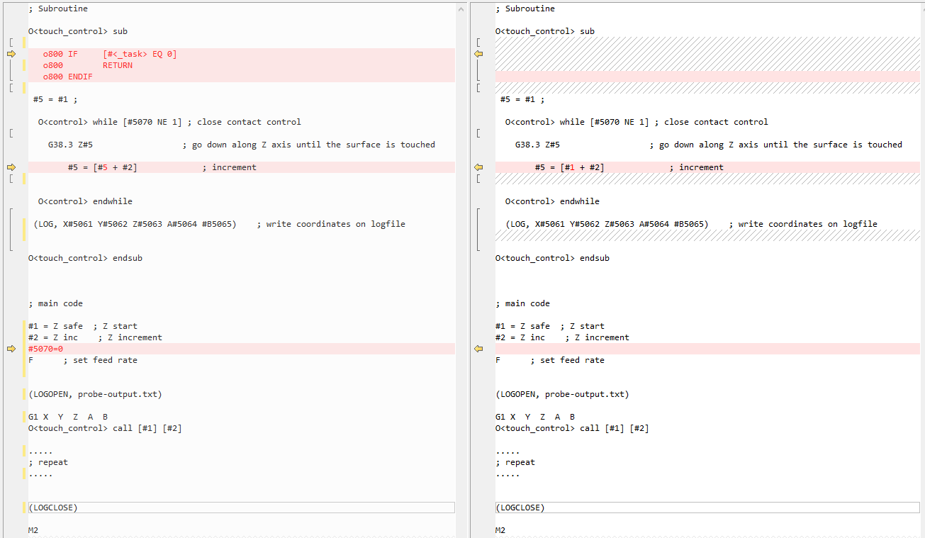

I'm affraid, your probingroutine needs some improvement.
About #5070. After successful probing, it gets TRUE, it stays true, until unsuccessful probing occures (no contact). So your probing will not be done after the 1st successful probing. Set #5070=0 before calling the subroutine. Another thing, for a loop like 'O<control> while [#5070 NE 1]' ,something like
is needed at the top, or ending up in a endless loop when loading the routine.
o800 IF [#<_task> EQ 0]
o800 RETURN
o800 ENDIF
The following user(s) said Thank You: Aciera, elisa

Perfectly explained, thank you very much!

Yes, it worked with the code above
