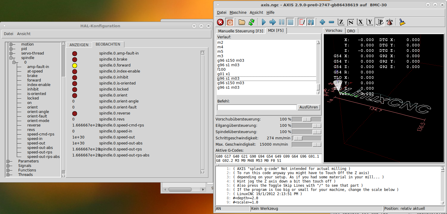

I set the Offset PWM Mode to: setp hm2_7i97.0.pwmgen.03.offset-mode 1
Problem now:
I Enable the Machine -> Spindle Output = 0V
I set the Speed to any Speed (1-1000rpm)=> Spindle Output = 10V
I can not understand what is happening.
There are 2 photos in the attachment with speed 1rpm and 150rpm.
I'm a little bit confused where the problem can be.

Try it without the G96
G96 needs encoder feedback working...
(you can see that LinuxCNC is commanding a near infinite spindle speed)
