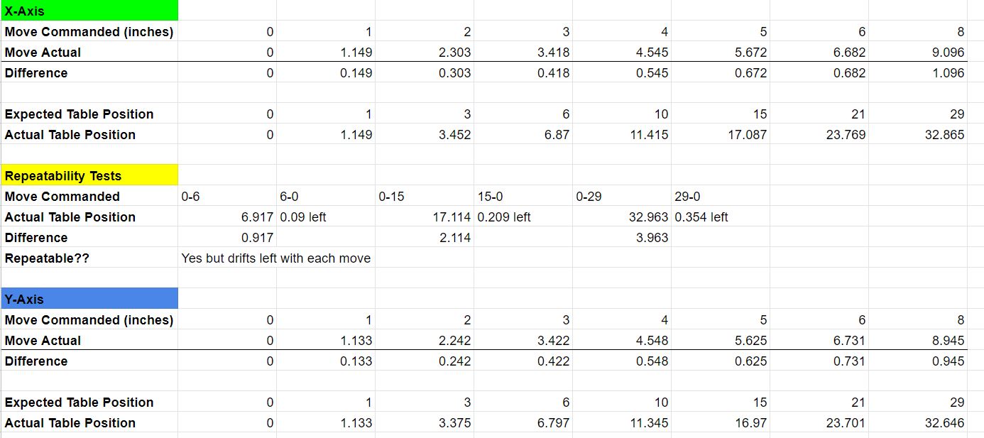

27 Dec 2020 16:05 #193298
by LinfieldGarage
Replied by LinfieldGarage on topic Axes not moving correct distance
Thank you all for the help.
@rodw I am using the rack and pinion drives below. They have a 20 tooth stepper pulley and a 60 tooth pulley driving the rack gear.
www.finelineautomation.com/product/rack-and-pinion-drive/
With 8x micro stepping step_scale should be:
(8 micro steps per step * 200 steps per rev * 3 gear reduction) / (1in pitch diameter * pi) = 1,527.88745 steps per inch
@Aciera and PCW, after lots of testing I believe this is a step_scale problem. The longer moves have more error and it goes past 0 on the way back. See table below.
Is it common to have to tune step_scale even when the math should be absolute?
Thanks again,
Jamie
Thanks again,
Jamie

27 Dec 2020 16:28 #193300
As I mentioned earlier you can calculate your step scale quite easily now for each axis:
STEP_SCALE = STEP_SCALE x "Expected Table Position" / "Actual Table Position"
Replied by Aciera on topic Axes not moving correct distance
Certainly not unheard of.Is it common to have to tune step_scale even when the math should be absolute?

27 Dec 2020 21:32 #193312
by LinfieldGarage
Great suggestion , I will give it a shot.
