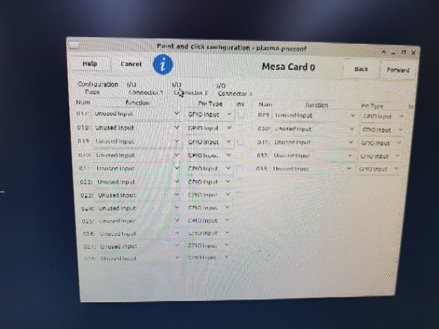

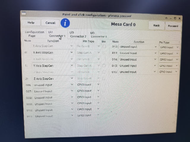

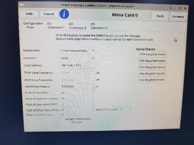

Hey guys.
I've got a newbie question
I'm slowly converting my plasma over to Linuxcnc.
I'm running a mesa 7i76eD and Odroid H2+.
I have been through the pnc setup and can move axes in the pnc setup.
I haven't setup any io pins yet, apart from the drives
When I load lcnc, i can't move anything. What am i missing to get moving?
I haven't installed plasmac yet
Also, I can't get wifi to connect. It shows up with strong signal, but whenever I try to connect, it keeps asking for password, even though password is correct. Ethernet connects fine.
Running Linux mint

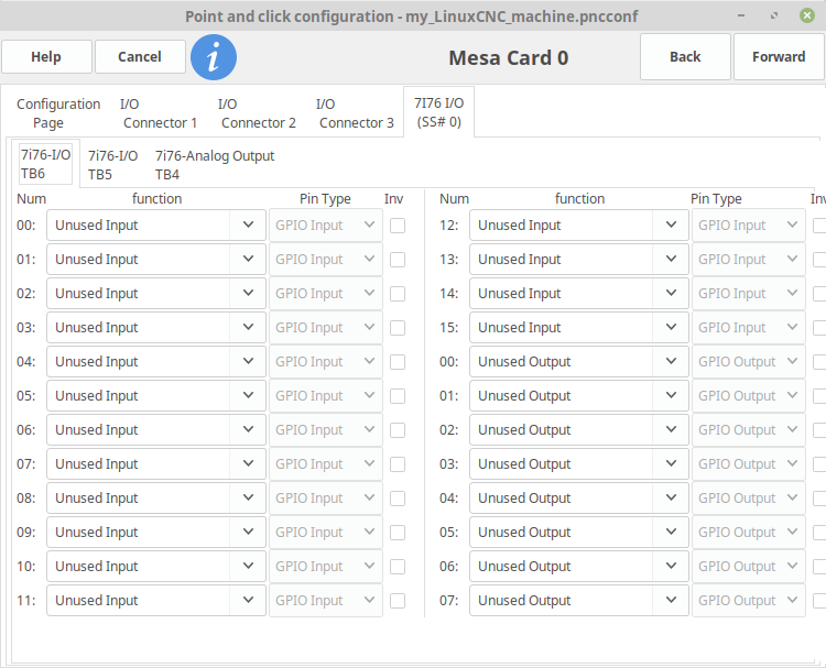

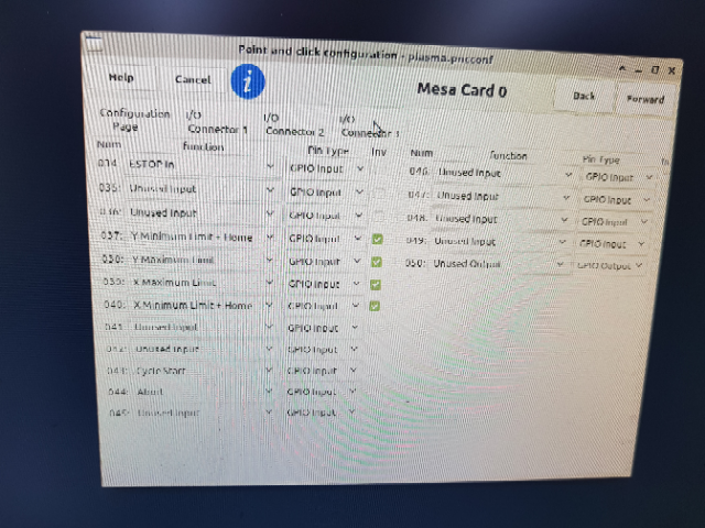

I have got all axes moving nicely, but limit switches are not working. How do i workout pinot of 7i76eD in pncconf relative to input 0-24 and output 0-24 on the mesa?

When looking at the manual, the IO pins are counted from the bottom up, so the first physical pin on the connector is input 00, same for outputs.

All sorted now.
I didn't have the 7i76ED powered up properly.
