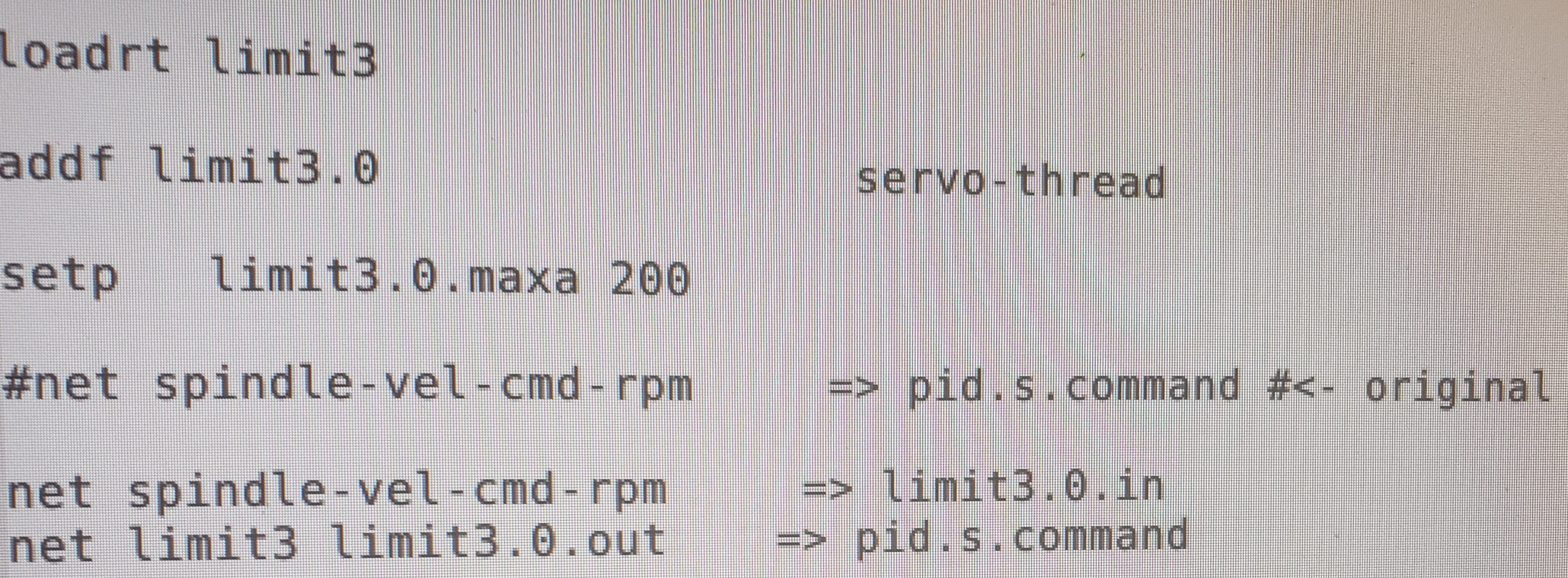

I would like to ramp my spindle speed down to zero on stops, instead of coming to an abrupt halt. I figured out how to do a ramp, and it works, but only when changing speeds.
With the above lines added/changed in my hal file, I enable the spindle and click the speed +/- buttons and it will gently ramp up and down, but when I click stop, it still slams to a stop. What more can I do?

That is done on the VFD, not software, although i am pretty sure it can be done in software with a timedelay on the ON pin and a ramp down on the PWM pin.
VFD has that setting in seconds, i usually set that at 5.

Yes as tommylight says on most drive analog/pwm a timedelay do the job
I have use that before writing a component with more control, but timedelay work really fine !

Yup, stupid question. I had my head stuck in the past. I'm not used to being able to change parameters in the drive (AB Ultra 3000, no LCD, bad serial port). I was looking for a workaround solution before it blew up, I knew it was going to happen sooner or later, it did, and I replaced it. After it blew up and I replaced it, I continued on trying to force my workaround, when it should have been obvious that I no longer need a workaround because I now have a working serial port. Thanks for talking sense into me.

Just for reference, you could do it all in HAL with a limit2 HAL component to limit the rate of change of spindle speed command. Though you would also need a delay on the drive enable pin to give it time to stop.
Spindle speed rate and speed limiting is on my mental list of things to add now that spindles look like Axes.

Not that it matters for my scenario (I am going to implement ramp in the drive) but since we are talking publicly and I'm still curious, what's the reason for using limit2 instead of limit3? I am already using limit3 to do this. Limit3 has .maxA (max acceleration I assume, not documented) and .maxV (max velocity I assume) where limit 2 has only .maxV

Just a _fractionally_ smaller CPU load.
Bear in mind that if the output is a spindle _velocity_ then limitV is a limit on the rate of change of velocity and limitA is a limit on the rate of change of the rate of change of velocity.
limit / limitdxdt / limitd2xdt2 might have been better pin names.
