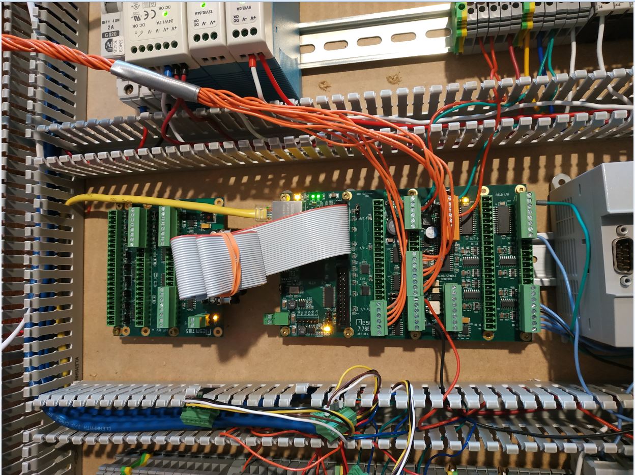

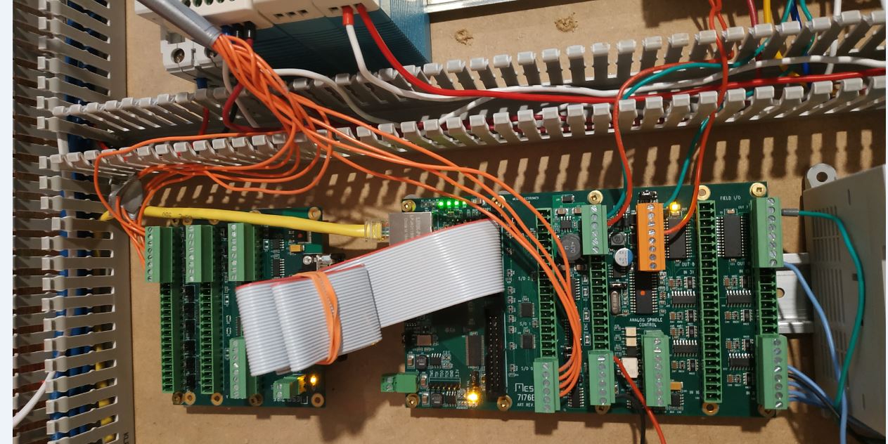

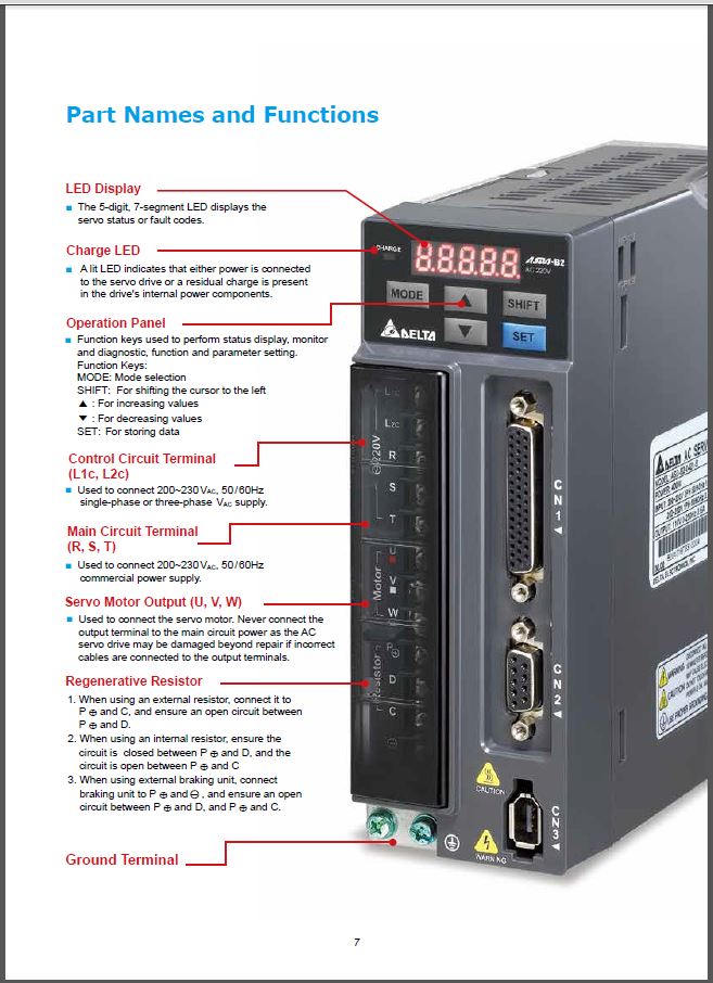

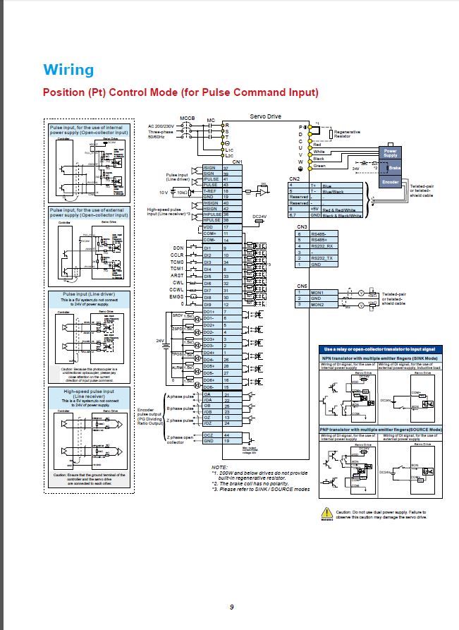

Hi ..
1. I Have a 7i76e+7i85s , mesa cards , setup and flashed ok , trying to use my delta servo drive and motor as the attached images ,
2. I did the wiring as position control (step and DR) .
3. I have a difficulty to setup the encoder output , always I get [ joint 0 following error ] also I did not see the encoder output on the hal oscilloscope !
I attached the hal and ini files also the driver and motor
Need advice please …
Hamel

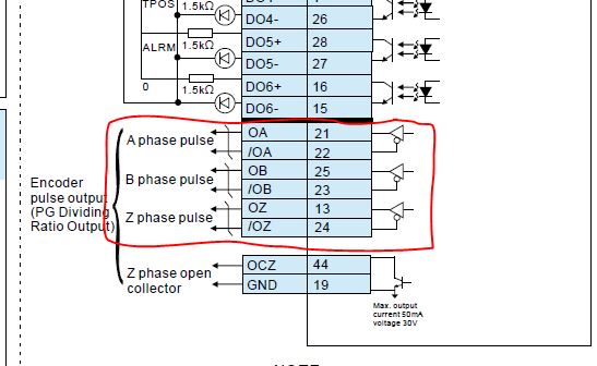

14 Jan 2021 16:36 #195333
by Hamel2020
Replied by Hamel2020 on topic Encoder Feedback
Encoder wiring change as per the img .
I have 3 phase encoder output (shown in the img with connection) ,...
(when I rotate the motor shaft by hand ,the encoder show moving signal )
but still I got joint following error , and both signal from the encoder are negative , try to swap the wires .. I got bot +ve ...
I do not know who to manage ...

- Hamel2020
- Posts: 74
14 Jan 2021 17:07 #195339
by Hamel2020
No ... when the driver enable it shows negative in both motion direction (X+ , and X-) ...for very small movement then show joint following error .
But when I disable the driver ,and rotate the shaft with by hand shows
+ when moving CCW , and - when moving CW
- Posts: 18100
- Thank you received: 5326
14 Jan 2021 17:17 #195344
Replied by PCW on topic Encoder Feedback
So you are saying the encoder position moves in a more negative direction
when the servo moves in either direction?
- Hamel2020
- Posts: 74
14 Jan 2021 17:22 #195346
by Hamel2020
exactly
- Posts: 18100
14 Jan 2021 17:34 #195351
OK That sounds like an electrical noise issue
Do the drive and 7I76E/7I85 have a common ground?
