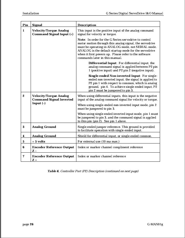

I have to supply a single -ended analog signal , and I have to use the TB2 form my Mesa card ,,,
my question is : how can I get an analog signal form TB2 ,
since the stp/dir signal is ( digital ??)
Thank you very much for your support ...

What kind of analog signal do you need?
That is what range and precision do you need?

I need a signal range -10 to +10V , send to my servo drive ...
- Hamel2020
- Posts: 74
10 Feb 2021 16:13 #198287
by Hamel2020
Replied by Hamel2020 on topic Single Ended Signaling from 7i76ED
My servo drive type is Ormec G type

Replied by PCW on topic Single Ended Signaling from 7i76ED
Is this for a spindle?
- Hamel2020
- Posts: 74
10 Feb 2021 16:59 #198293
by Hamel2020
No ... for servo motor in x direction ,
- Posts: 18084
- Thank you received: 5317
10 Feb 2021 17:11 #198296
OK so unfortunately its pretty awkward to just add support for a single
analog drive/encoder to a 7I76E. you could add a 7I83 for analog out
but you would need another daughter card to add an encoder input
(assuming the 7I76Es encoder is already dedicated to the spindle)
