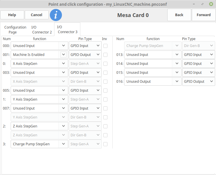

Are you saying that this: (the firmwares pinout)
Does not match your BOB?
IO Connections for P3
Pin# I/O Pri. func Sec. func Chan Pin func Pin Dir
1 0 IOPort PWMGen 0 PWM (Out)
14 1 IOPort None
2 2 IOPort StepGen 0 Dir (Out) <<<<<<<<<<<<<<<<<
15 3 IOPort None
3 4 IOPort StepGen 0 Step (Out) <<<<<<<<<<<<<<<<<
16 5 IOPort None
4 6 IOPort StepGen 1 Dir (Out)
17 7 IOPort None
5 8 IOPort StepGen 1 Step (Out)
6 9 IOPort StepGen 2 Dir (Out)
7 10 IOPort StepGen 2 Step (Out)
8 11 IOPort StepGen 3 Dir (Out)
9 12 IOPort StepGen 3 Step (Out)
10 13 IOPort None
11 14 IOPort QCount 0 Quad-A (In)
12 15 IOPort QCount 0 Quad-B (In)
13 16 IOPort QCount 0 Quad-IDX (In)Does not match your BOB?

12 Feb 2021 03:42 - 12 Feb 2021 03:43 #198479
Replied by PCW on topic 5i25/6i25 bitfile for DMB4350-8B bob
Does LinuxCNC start up and run with your configuration?

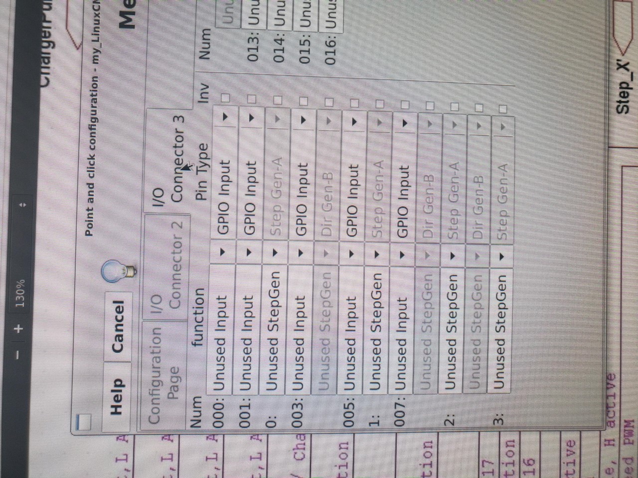

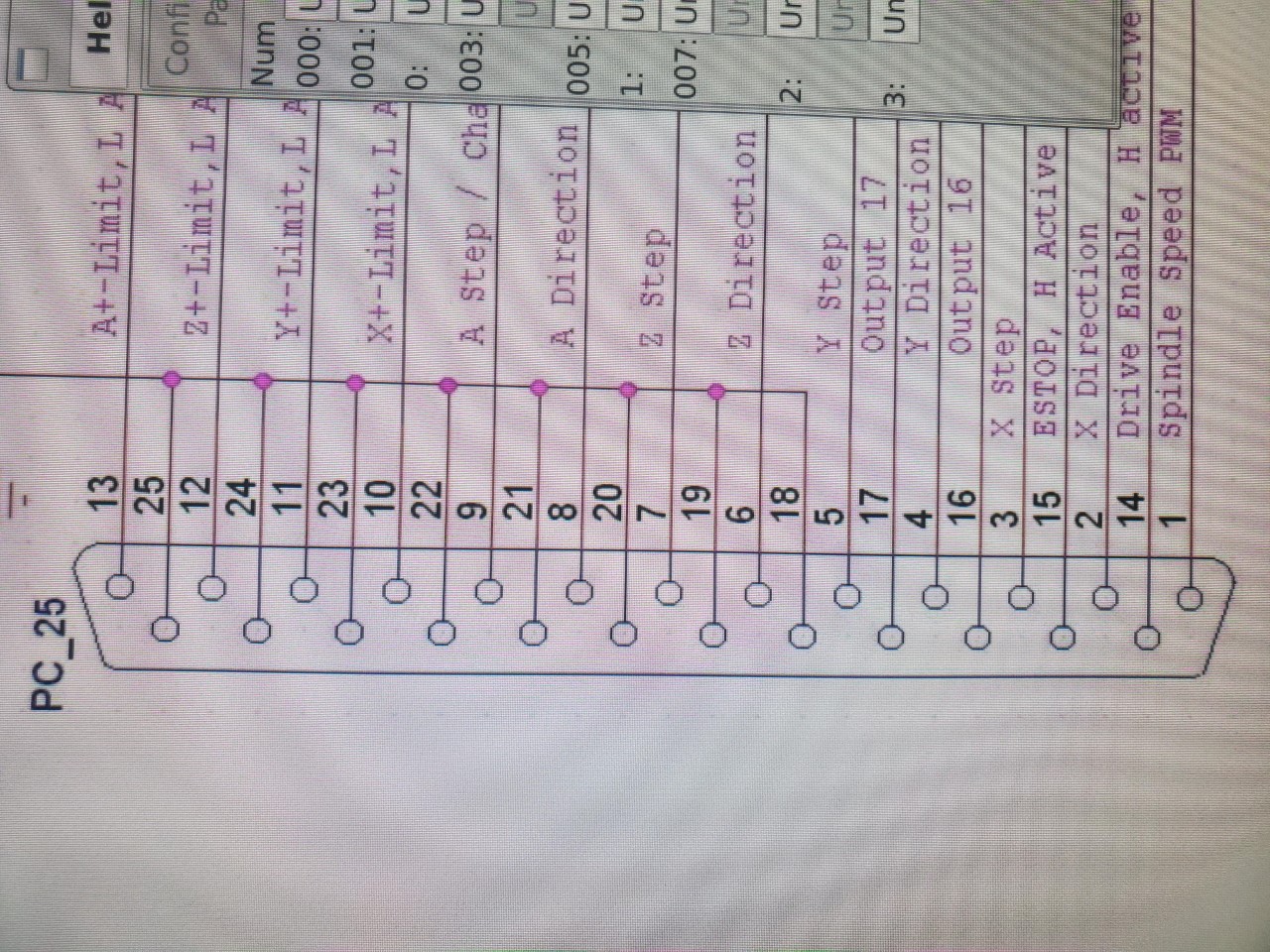

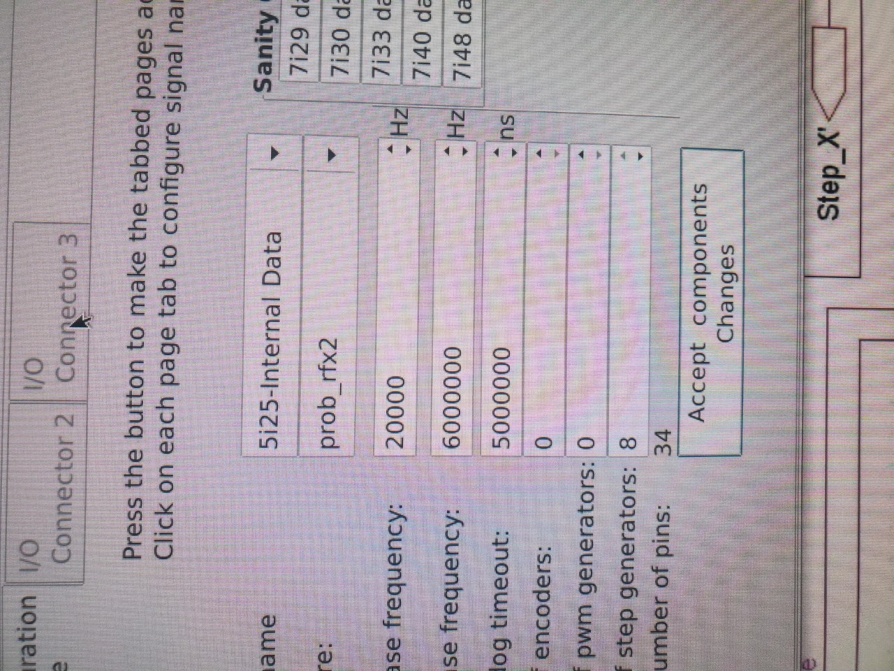

that looks to be the same but its not what im getting on this pc. ive attached some photos. sorry it keeps turning them sideways

i dont have I/O 9 for pin 6 Z stepgen
- 0jw
- Posts: 98
12 Feb 2021 04:05 #198485
by 0jw
Replied by 0jw on topic 5i25/6i25 bitfile for DMB4350-8B bob
i can not set pin 14 - I/O1 to enable
- 0jw
