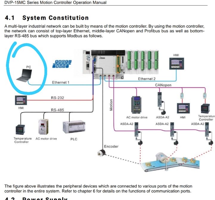

Good morning,
Do you think that will be possible to use linuxcnc with a DELTA DVP15MC PLC hardware via an Ethernet communication?
Try to figure out this task, will be a challenger job for someone over there that want to help us?
If someone is interested to make us a quotation, please he can contact me via PM or at This email address is being protected from spambots. You need JavaScript enabled to view it.
Thank you in advance

Replied by rmu on topic LINUXCNC + DELTA DVP15MC via ETHERNET
I don't think it makes much sense to include communication with a separate motion controller into linuxcnc. Even then it would be a complicated task with (at least to me) no obvious benefit.
What should be possible is to talk to the Delta Servos directly via ethercat.

Replied by AlessandroT on topic LINUXCNC + DELTA DVP15MC via ETHERNET
Thanks RMU for your feedback,
As I'm a bit confident with the flexibility of linuxcnc, for this reason, I'm a bit scared to start from zero with new solutions.
The goal is to use CANopen communication with 9 axes and linuxcnc, but I don't know which hardware and configuration are ready out of the box to manage 6-9 axis with linuxcnc and CANopen.
Do you have any advice to do it?

Replied by Roiki on topic LINUXCNC + DELTA DVP15MC via ETHERNET
Linuxcnc doesn’t support canopen. You’re either looking at the wrong motion controller or you have to build a canopen stack yourselves,

by rmu
AFAIK not possible out of the box.
Either get ethercat drives or get appropriate interface hardware for step/dir or the analog +-10V interface of the delta drives.
Let's say that we will change the version of the ASDA-A3 driver with the appropriate ethercat version.
At that point can I be able to talk directly from a PC to the drivers via ETHERcat?
If yes, there is a guide or a video somewhere for a newbie in ETHERCAT connections that we could be addressed?

by rmu
I can't help with ethercat, but there is this forum.linuxcnc.org/24-hal-components/22346-ethercat-hal-driver forum thread. Maybe ask there.

18 Feb 2021 11:57 #199241
It doesn't _currently_ support CANOpen.
I think that adding it would be good.
What suitable hardware exists? It would need to connect to the PC hardware by a realtime-capable link.(ie, not USB)
There has been some discussion about using SocketCAN as a shim layer between LinuxCNC and CANOpen on the LinuxCNC mailing list.

18 Feb 2021 14:25 #199257
by Roiki
You can add that to the pile of things people _should_ do. You just need to find the people willing to do it.
The easiest and cheapest hardware is RPI with SPI can interface ic(there are guides for this). PCIe can cards are kind of expensive. Then its just a quesion of creating RT capable drivers for them.
