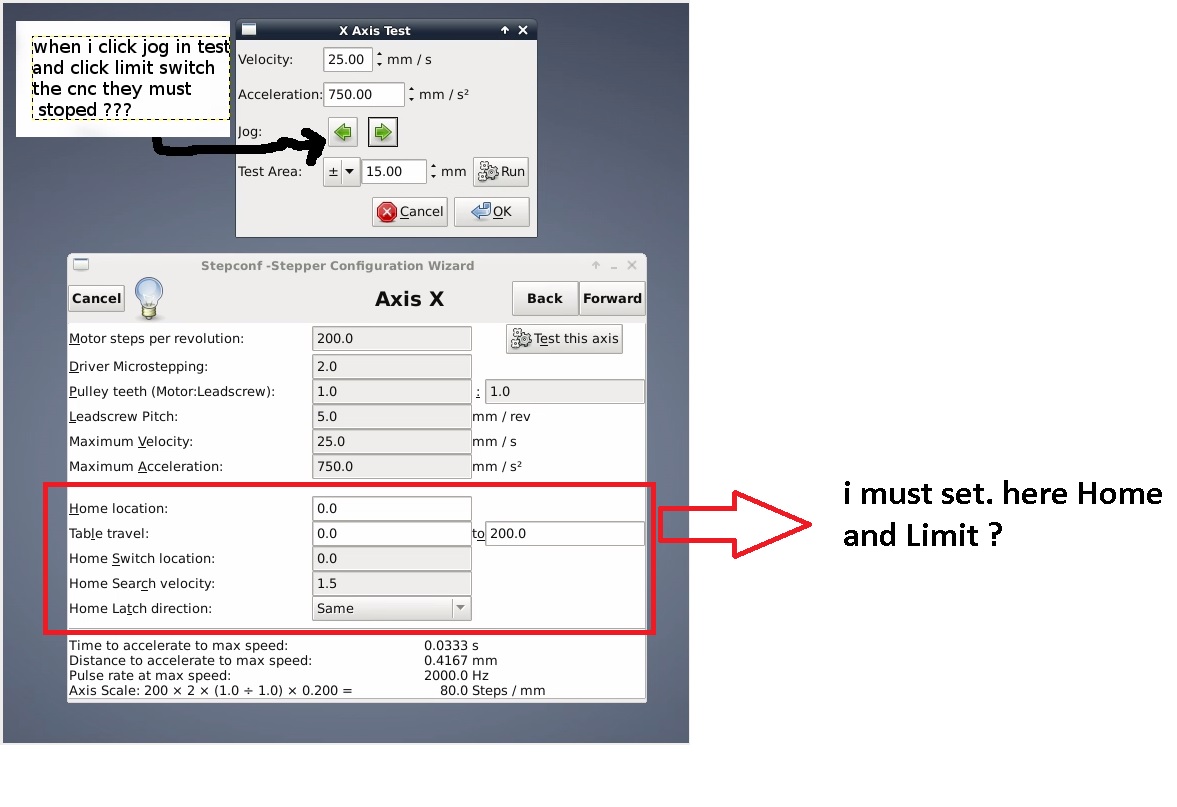

2. question when run a setup wizzard set, mm , geko 540 and after 2 window set pin input 10 estop 11 home + both limit X etc.. for
is corect ?
3 question when arrive in wizard at test axis click in jog and click in limit switch but not stop a motor , is correct ???
4 when is finish configuration i try to test a cnc , open a program created (link created in desktop ) and push turn on , before start i
must do a homing , i push it , start to home , but cnc not move and motor not start ..... why ??? anyone have ideaa

Is the charge pump on G540 enabled ?
That requires having a charge pump set to pin16.

i set g540 but i can set also other , when i try to jog work the same this is my board where is pin 16 ???
lh3.googleusercontent.com/proxy/939cPjO-...WSP5RB9n1N9MbMVQV-tM
