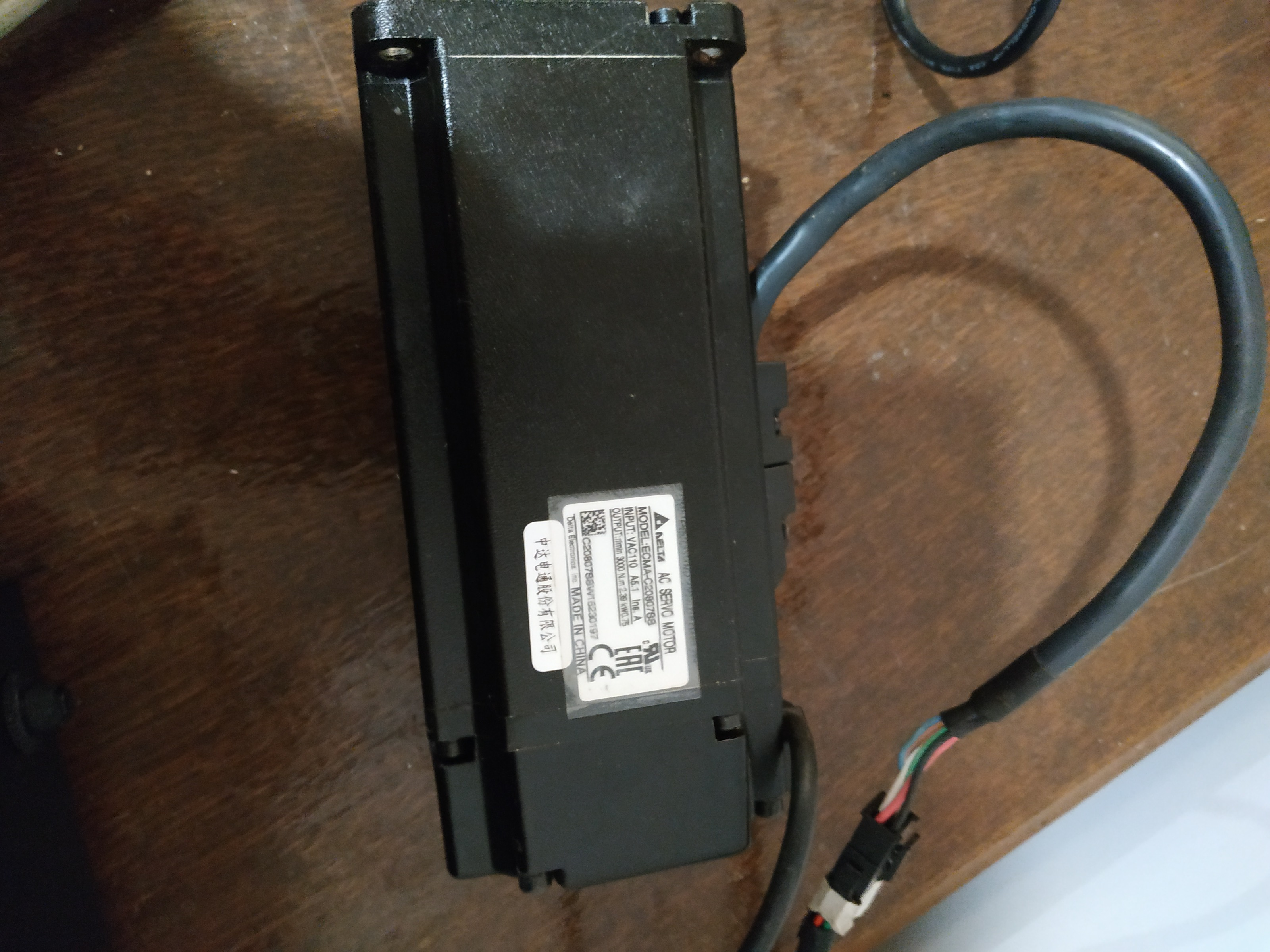

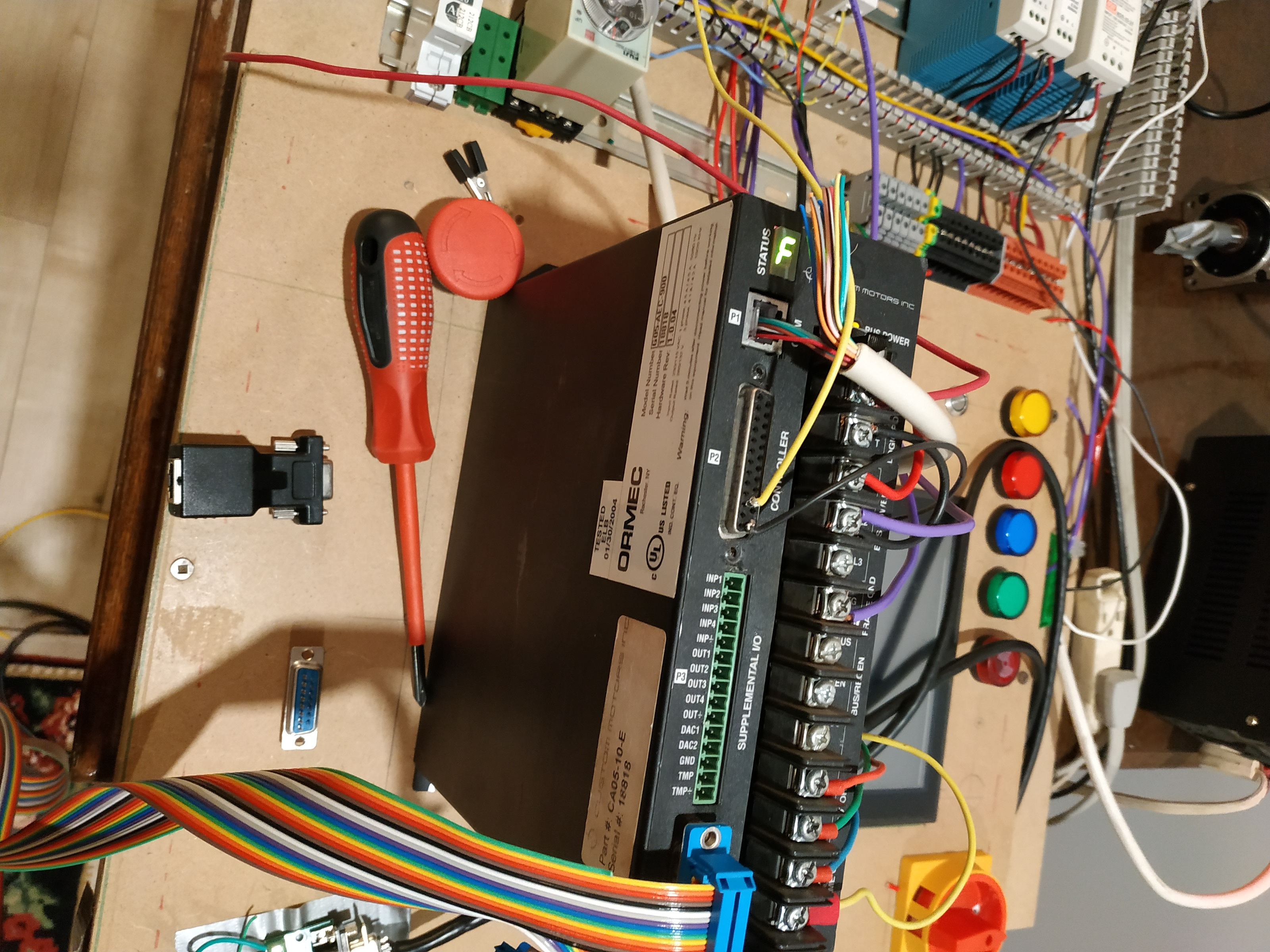

Hi ...
I’m trying to communicate a Delta servo motor with Ormec Servo drive , but always I got F7 error , due to Feedback error .
I’m trying to connect the DB9 (feedback from delta servo motor ) with DB15 infeed for servo drive …
As we see I have two wire T+,T- ( I think RX , Tx) , Any body have an idea to advise …

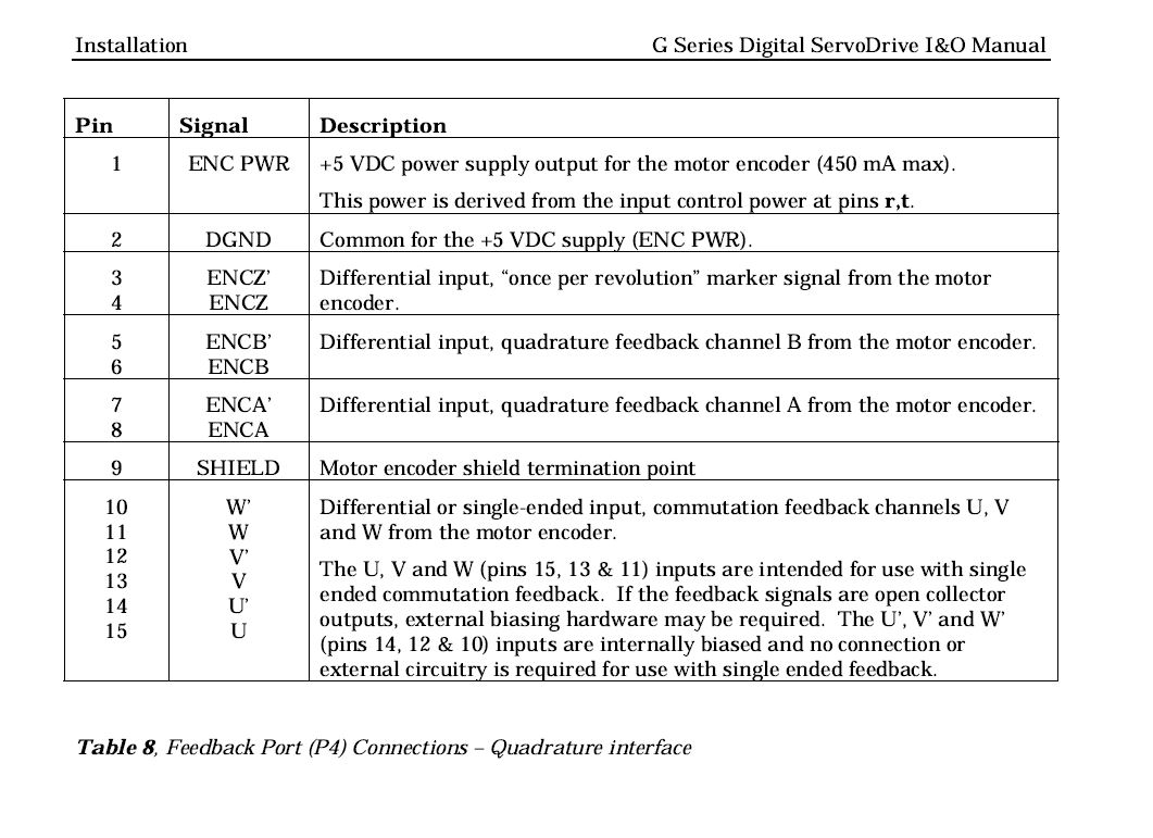

24 Feb 2021 00:45 #199906 by Hamel2020
Replied by Hamel2020 on topic Serial communication for Encoder Feedback
Thank you tommy ...
The servo drive is Ormec , and the servo motor is Delta .. As I check in the manuals for both ,
1. serial communicate ,
2. Differential signals
attached some photos

24 Feb 2021 00:51 #199908 by Hamel2020
Hi Benb ,
Yes , Delta B2 is a servo drive , but it is compatible with the delta servo motor , I attached the photo ... ECMA type ..
I did a lot of searches , but I do not know how to get them communicate together ...
24 Feb 2021 00:58 - 24 Feb 2021 01:13 #199910 by Benb
from the Delta manual I just had quick look at the encoder is based on some serial two wire connection. However your drive is ABZ and ABZ complement. so they are not compatible.
Try to find an incremental encoder that would fit inside the existing encoder housing, least expensive option.

24 Feb 2021 10:50 #199954 by chris@cnc
Replied by chris@cnc on topic Serial communication for Encoder Feedback
Hmm, I wonder if the Omron drives then supports all of these protocols?
pretty sure no. I dont know the omron driver but, serial communication and differenz signal are complete different.
Serial encoder data are packed and inside are individual functions of maker. To read this data it s neccescary to know the data inside and mostly only maker know this.
Second thing some serial data are wired with 4 cable two data two clock rate. Some with two one data one clock. I try to understand this but it seems my mind is not enough.
Result for me: buy driver and servo from one maker it saves much pain.
And Scales with differenz signal could you connect if your driver allowed to input differenz signal. Marked with A,A/ B,B/ Z,Z/
