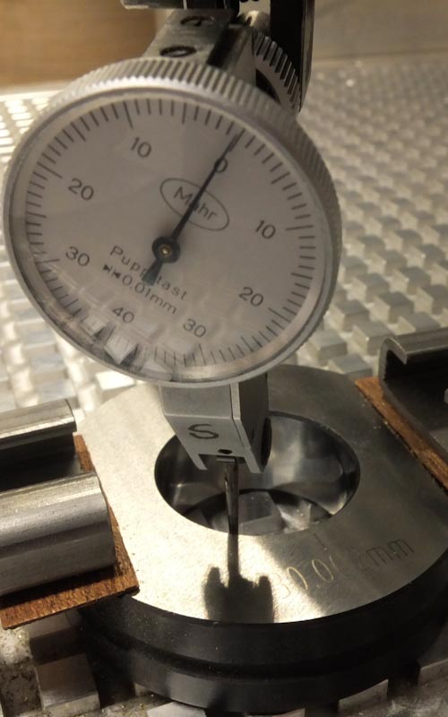

I really would like to know how much I am off from the previous home position when I re-home. Is there a simple way of doing this? It seems this would be a popular feature but my googling is striking out.

If you place a calibrationring on the machining area, centerpoint with dial gauge, G28.1 in MDI, #5161 and #5162 will contain X and Y position, machinecoordinates G53. Save this, then rehome.
G0 G53 X#5161 Y#5162 to the previously saved positions. Maybe select G54 and set X Y to zero. Check the deviation with dial gauge.

I have a DRO with glass scales on my mill from it's manual mill days. I just home, zero the DRO, home again. I think any solution is going to involve the addition of some additional measuring hardware.
