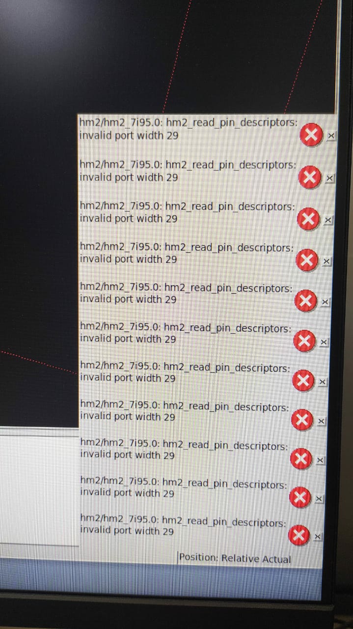

Invalid port width 29 was created by suraj9735
What's the possible reason for this error? I am able to simply ignore this error and run my machine. But, I want to what's this error means?
Due to this error linuxcnc take 20 seconds to start.

Replied by PCW on topic Invalid port width 29
It means you are not using a new enough version of LinuxCNC for the 7I95
The 7I95 needs LinuxCNC 2.8.1 or greater

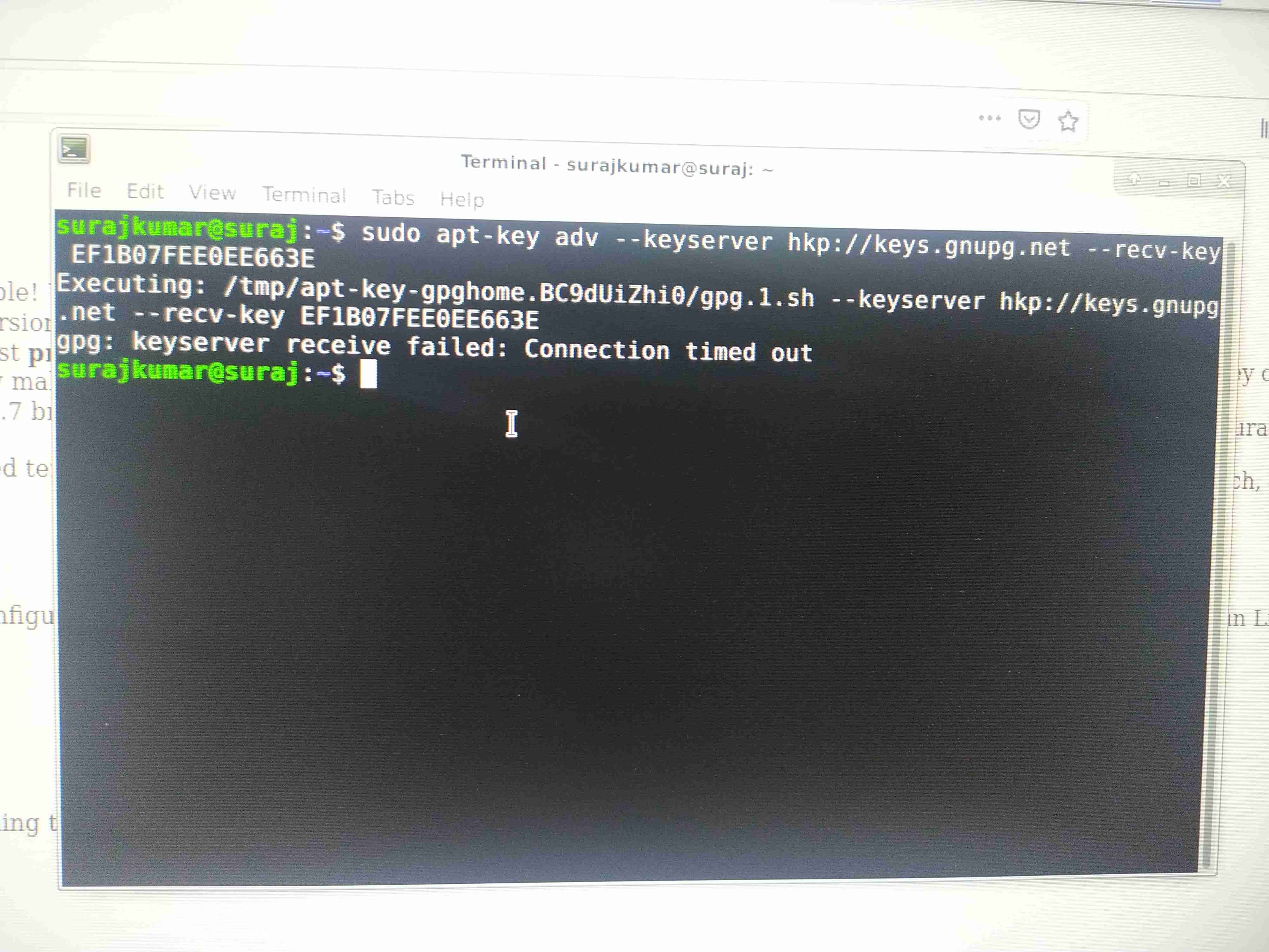

by suraj9735
Could you please write the steps with commands to upgrade from 2.8 to 2.8.1?
I am using LinuxCNC 2.8.0 Debian 10 Buster PREEMPT-RT ISO.

by suraj9735
I am getting this error when trying to upgrade to 2.8.1

Replied by Aciera on topic Invalid port width 29
Maybe try to add port 80 to your url:
As suggested here:
unix.stackexchange.com/questions/399027/...-indicated-a-failure
[edit]
I'm actually not sure this is even important at all. Have you tried to proceed with the other commands regardless of this error?
hkp://keys.gnupg.net:80As suggested here:
[edit]

Replied by andypugh on topic Invalid port width 29
If you already have 2.8.0 then you shouldn't need to do anything much to upgrade.
In fact it _should_ be automatically offered as an update.
Open the Synaptic Package Manager, search for LinuxCNC, mark it for upgrade and then click "apply"
