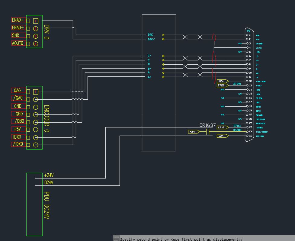

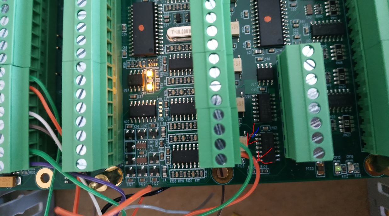

Doesn't look like the analog out is connected to the drive at all

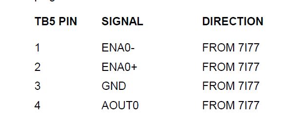

but I used the connection as per the images

ENA0-
ENA0+
ENA0+

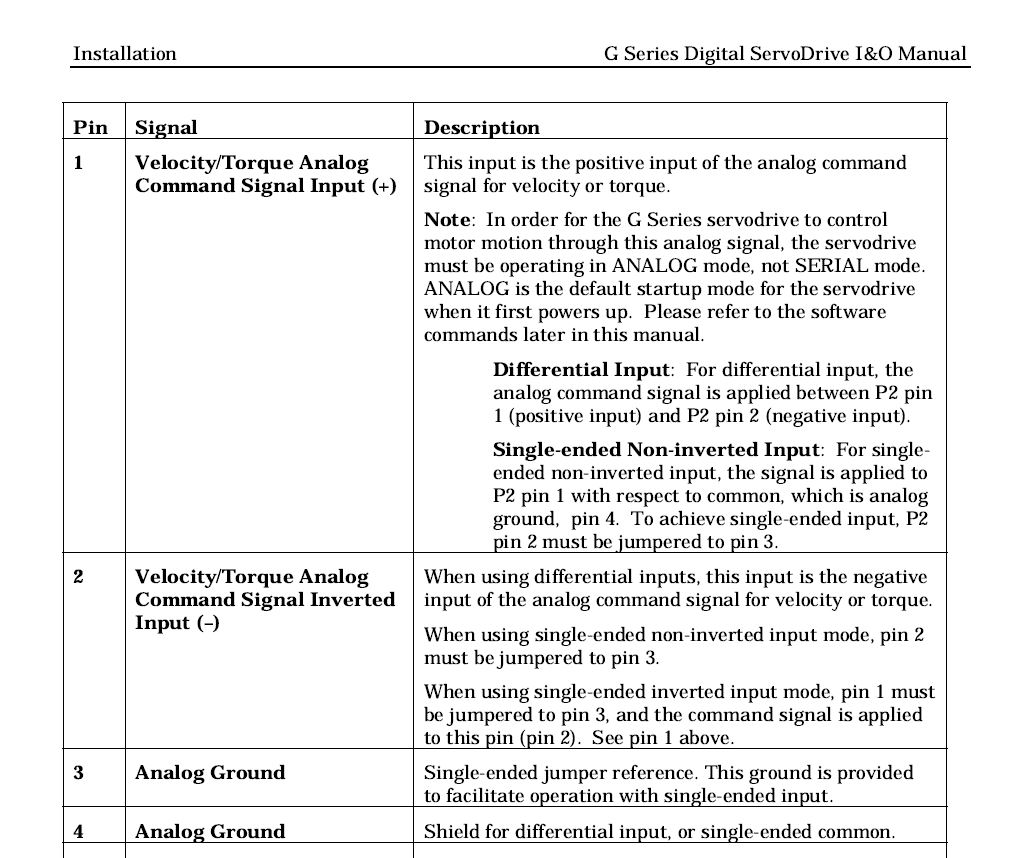

here is also the drive manual instructions

7I77 AOUT --> DRIVE AIN+
7I77 AGND --> DRIVE AIN-
7I77 ENA+ and 7I77 ENA- are the two terminals of a switch
that should enable the drive when "on"

As I understand , the connection could be like this ?
correct me if I'm wrong please
- Posts: 18084
- Thank you received: 5317
08 Mar 2021 01:50 #201385
Replied by PCW on topic 7i76ED+7i77 for analog signal
That look basically right except you have ENA- and ENA+ swapped
