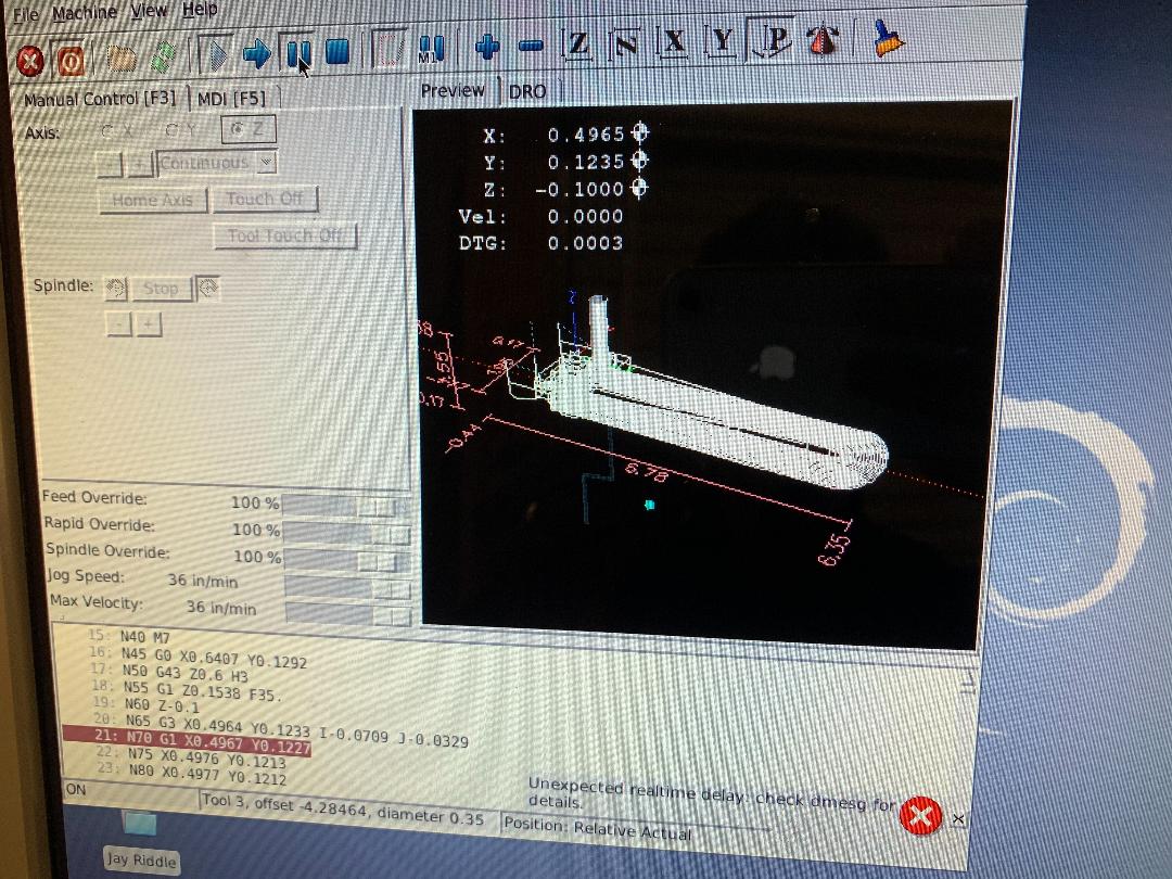

Hey everyone-
I've been getting this error intermittently on one toolpath for a new part. Sometimes it happens in the first few seconds, sometimes it takes 5 minutes or so, but it always happens eventually running this program. It seems to "lose" it's place in the Y axis and will machine features offcenter in Y after the error occurs. I've spent several hours trying to internet diagnose it myself, and have realized I'm waaaaay out of my depth... most of the time was spent googling what all the acronyms mean.
I've read that it may have something to do with acceleration speed, so I tried slowing it down to a crawl, but still get the error. I've also read that it can have something to do with latency... I ran the test overnight, abused it as much as I could, and came up with max jitter base thread of 22,000. Originally I had it set up for 25,000, but upped it to 30,000 and still get the error.
I've found at least somewhat similar threads in many places with suggestions about RTAI, ACPI, APIC, disabling things in BIOS, something about kernels, graphics cards, etc and pretty quickly realized that this is an enormous language that I definitely don't speak.
Anybody able/willing to walk a dummy through troubleshooting this?

Update: I've now tried setting base period maximum jitter to: 10,000 15,000 25,000 30,000 and 50,000 and all of them give me the same error

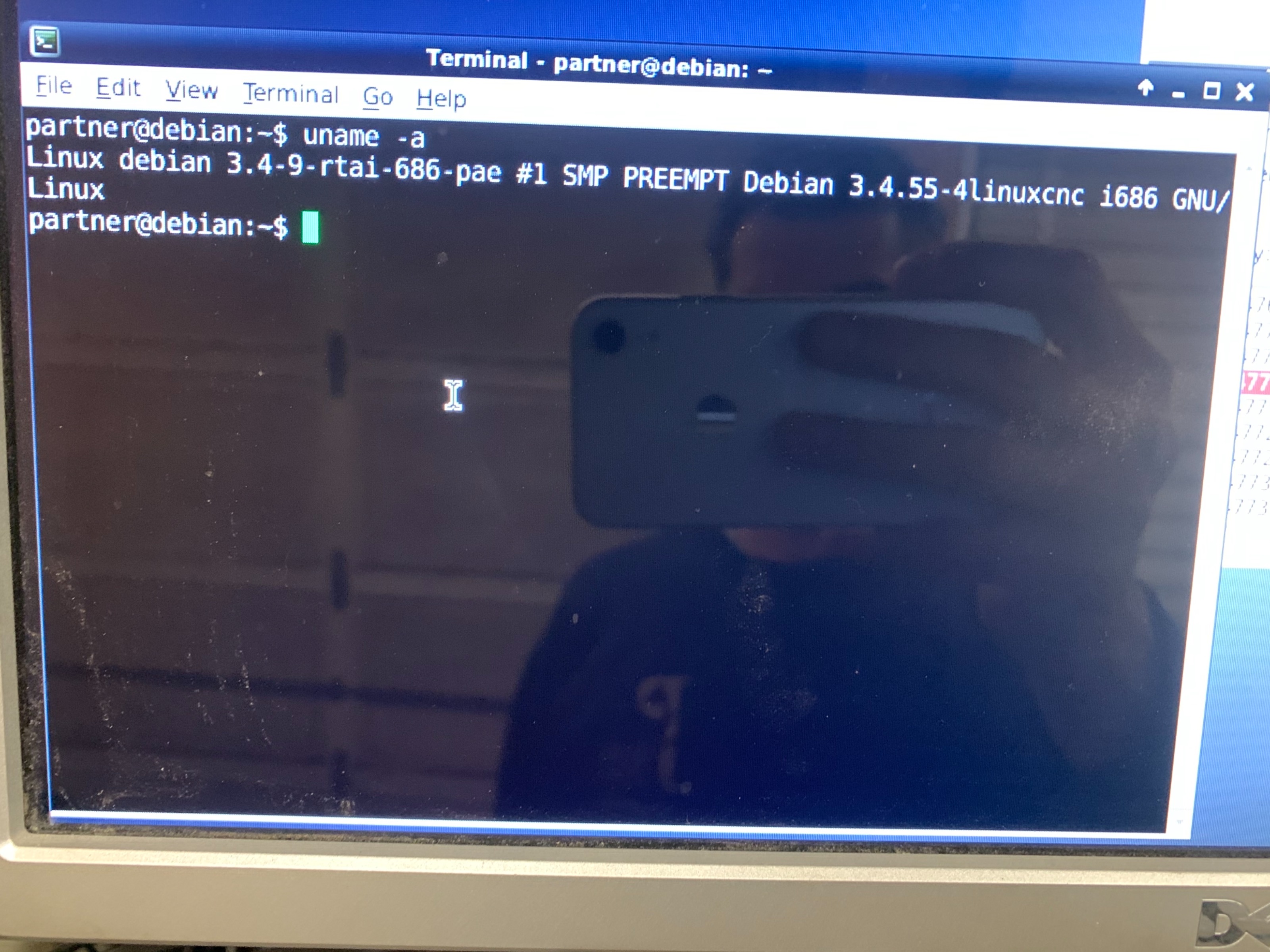

What does
uname -a
in a terminal say?

I attached a pic belowWhat does
uname -a
in a terminal say?

The "unexpected realtime delay" doesn't normally cause a problem. [1]
Are you seeing the Y-axis problem only when making parts, or also when making air cuts?
[1] I am not saying that is doesn't indicate a problem, just that it would be unusual to see it wreck the part as you seem to be describing .

I suppose I’ve only noticed it running an actual part, but I’m not sure I’d be able to see it naked eye cutting air. The part is long and narrow... op1 is a 2d contour of all the outside geometry, and op2 is the one I’m having trouble with. I notice the y error in op2 because there’s that sort of “known good” frame of reference from op1. There’s a few on center features in op2 that will be visibly offcenter after the error occurs... maybe .100 or so
