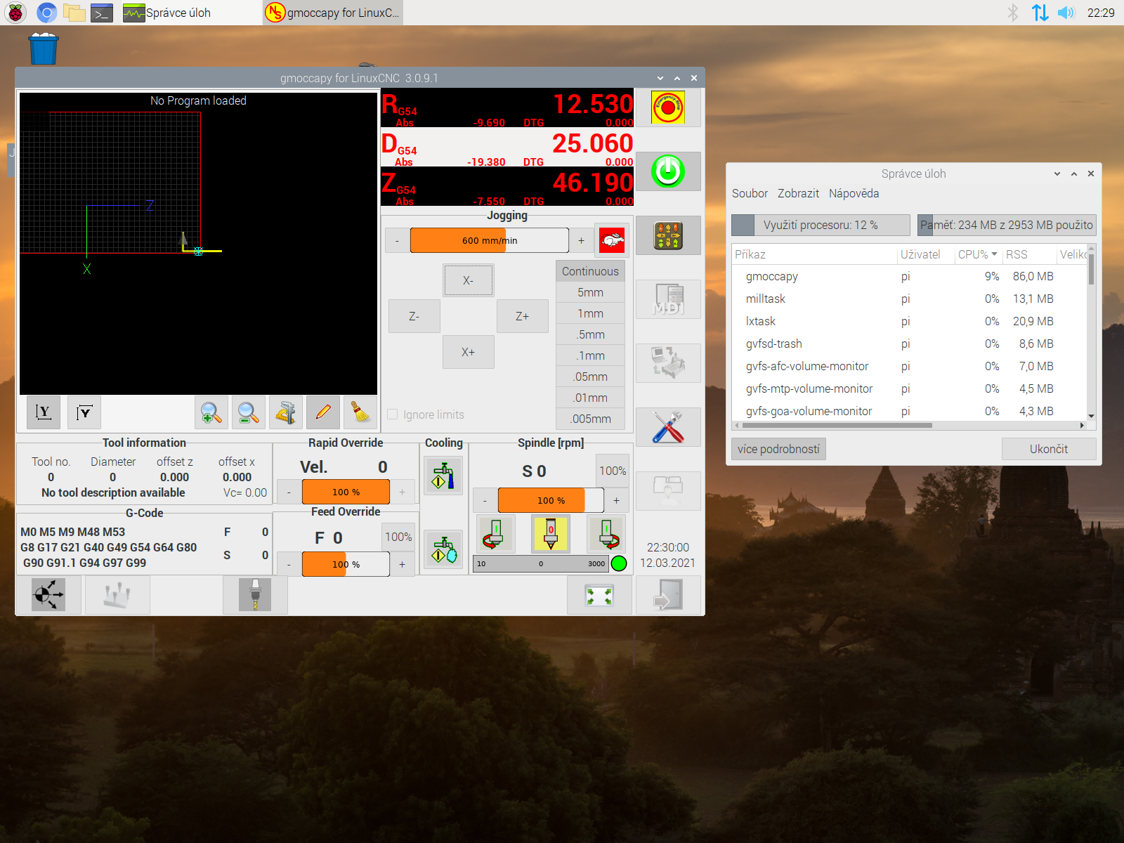

Sometime I run LCNC:
And CPU is fantastic everything works.

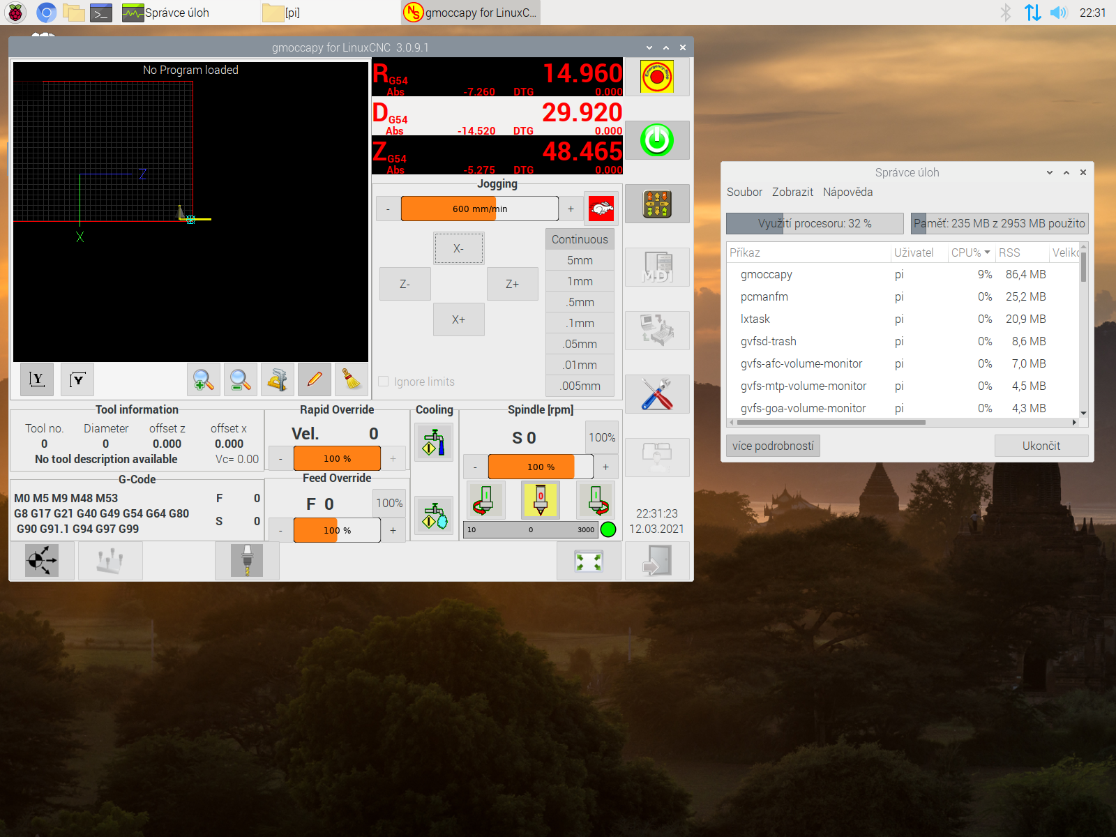

And CPU dont want fall down under 25% CPU and it is problem.
I did these 2 attempts in a time span of 3 minutes. I didn't turn on any apps.
There is an error, some random number generator determines when the LCNC is usable and when it is not.
I bought 10 pcs of Mesa 7i96 (a total of 20 pieces, but 10 pieces for me), so I have enough hardware for experiments, but I don't have IT knowledge to solve problems.

What task is using that much CPU?

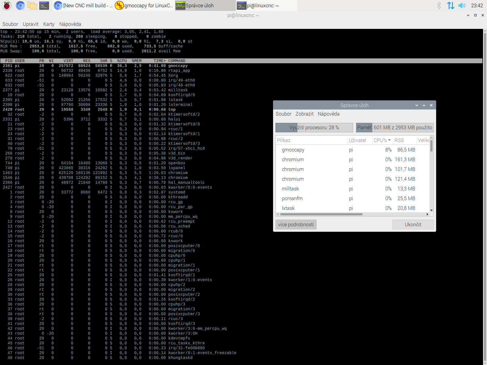

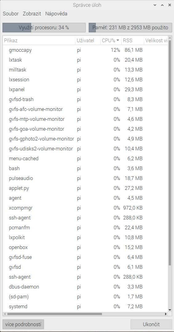

GUI tools will not show the processor load, use
sudo top
in a terminal for that.

That's strange I have a test setup with a 4G RPI4 and its pretty snappy even with more then 50% CPU utilization, though this is using Axis
