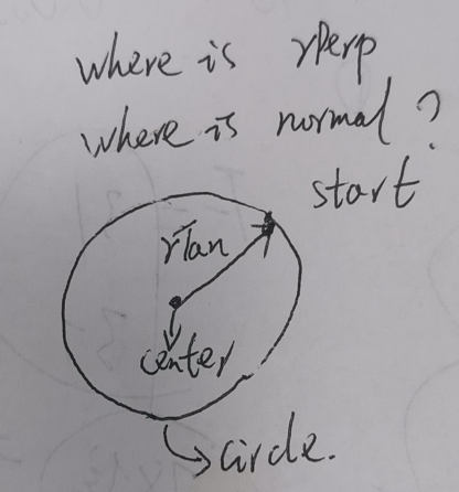

PmCircle structure parameter definition( rTan , rPerp and rHelix) was created by mil818
/* Generalized circle structure */
typedef struct {
PmCartesian center;
PmCartesian normal;
PmCartesian rTan;
PmCartesian rPerp;
PmCartesian rHelix;
double radius;
double angle;
double spiral;
} PmCircle;
My question is that :
1 . what means are parameter rTan , rPerp and rHelix ?
2. Are there has a figure that could show them clearly ?

18 Mar 2021 01:40 #202696
Replied by andypugh on topic PmCircle structure parameter definition( rTan , rPerp and rHelix)
There seems to be some clues here:
github.com/LinuxCNC/linuxcnc/blob/43ac97...th/_posemath.c#L1726
But it also appears that whilst rHelix is used, rTan and rPerp are not.
- mil818
- Posts: 11
18 Mar 2021 05:22 #202709
by mil818
Replied by mil818 on topic PmCircle structure parameter definition( rTan , rPerp and rHelix)
/* vector in plane of circle from center to start, magnitude radius */
pmCartCartSub(start, &circle->center, &circle->rTan);
My understanding is that rTan is the vector from center to start point.
/* vector in plane of circle perpendicular to rTan, magnitude radius */
pmCartCartCross(&circle->normal, &circle->rTan, &circle->rPerp);
circle->normal is normal of circle,where is its exact position in one circle plane ? circle->rPerp is cross production between circle->normal and circle->rTan vector. For linuxcnc, do we have original description for this definition by figure.
- mil818
- Posts: 11
19 Mar 2021 00:43 #202788
by mil818
I draw a circle and add one rTan vector,but I don't know where is normal vector and rPerp vector ? who could please tell me about it ?

27 Mar 2021 01:36 #203764
It is possible that nobody knows. This code has a feel of something either written with future expansion in mind 20 years ago, or imported from somewhere else at about the same time.
LinuxCNC never uses rTan or rPerp. it uses rHelix, and my only suggestion is that you look at the code to see what it is used for.
No one person knows how all the LinuxCNC code works. Parts of the code that have never been used are likely to be understood by no-one (including the original author, this many years on)

01 Apr 2021 09:49 #204381
rTan and rPerp don't "work in LinuxCNC". The code might be functional, but as far as I can see LinuxCNC never calls those functions or uses that data.
Hello,Mr
Firstly, thank you for your warm reply for this quesiton, like what you said in your previous answer,it is difficult to understand how rTan , rPerp and rHelix work in linuxcnc,I just use it as black box but I don't know what its algrithm really is working.
