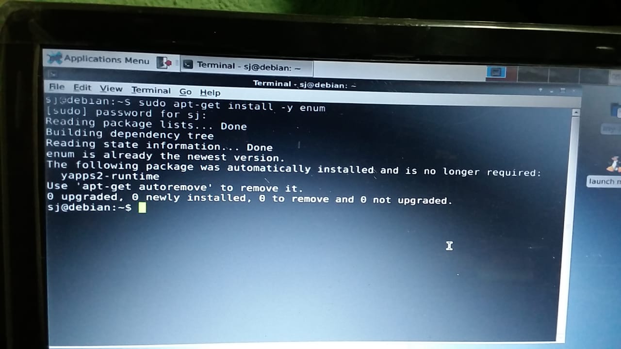

But new error:
File "./compensation/compensation.py", line 29, in <module>
from enum import Enum, unique
ImportError: No module named enum
Out of guess, I run "sudo apt-get install -y enum"; something was installed. I tried enum again, result as per the photo.
But linuxcnc same error persists. What to do??

26 Jul 2022 16:29 #248346
Replied by andypugh on topic adding auto leveling to linuxCnc
try
apt-cache search enum
and see if there is a "python-enum" module or similar.
