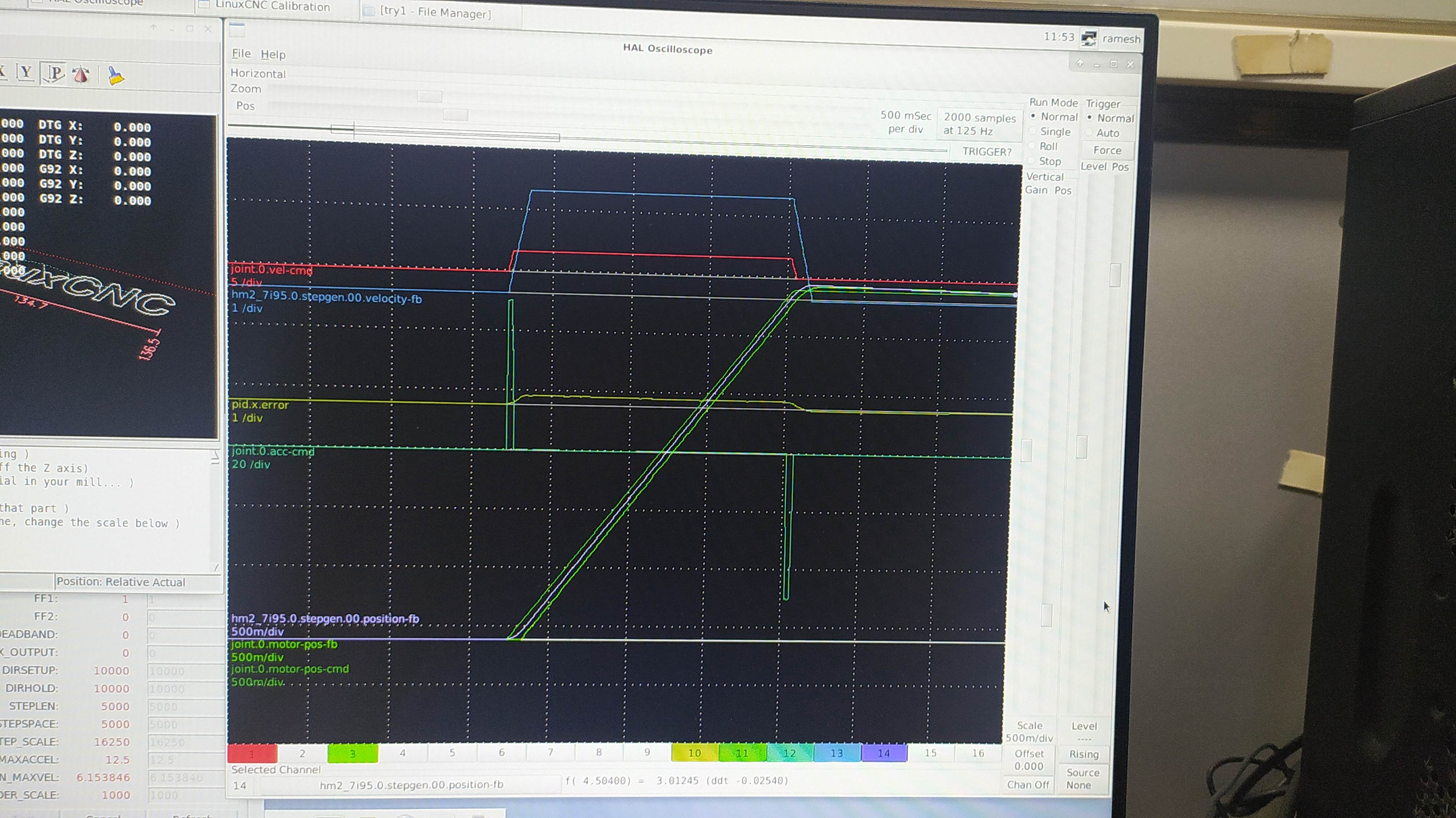

What's the difference between joint.0.motor-pos-cmd, joint.0.motor-pos-fb, hm2_7i95.0.stepgen.00.position-cmd, and hm2_7i95.0.stepgen.00.position-fb ??????
Image attached, showing very close to eachother but little difference. I am trying PID tuning, need help in setting the parameters like max/min velocity and acceleration for default, axis, and stepgen.

joint.0.motor-pos-cmd is LinuxCNCs commanded position output for Joint 0
joint.0.motor-pos-fb is LinuxCNCs acttual position input for Joint 0
hm2_7i95.0.stepgen.00.position-cmd is the 7I95s stepgen 00 position command input (normally not used)
hm2_7i95.0.stepgen.00.position-fb is the 7I95s stepgen 00 position feedback output
