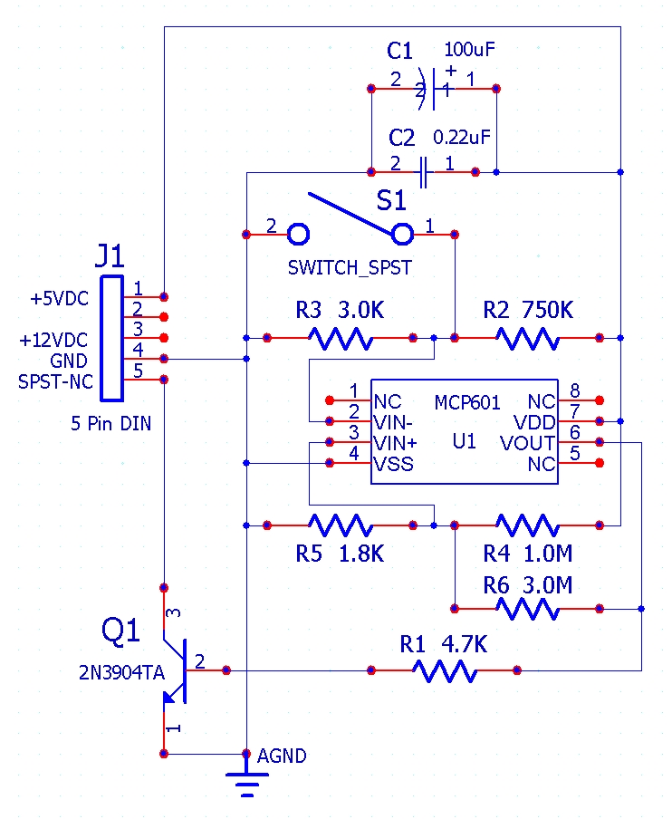

Thanks for your replies, yeah I think you are right about the way they output the signal. This thread has a lot of info about the way Renishaw tackles the spark issue - www.cnczone.com/forums/tormach-personal-...25794-tormach-7.html
There are 2 circuits posted for inverting and non-inverting outputs which I think would work with the TP20 Probe, however this seams to use a 5v supply and the mesa inputs are 24v field power.

This is the non-inverting circuit diagram from the CNCZone post.

Of course my post was written pre-coffee. I meant increase in resistance as the probe triggers...
Duh.
Thanks for throwing up the diagram for future reference.

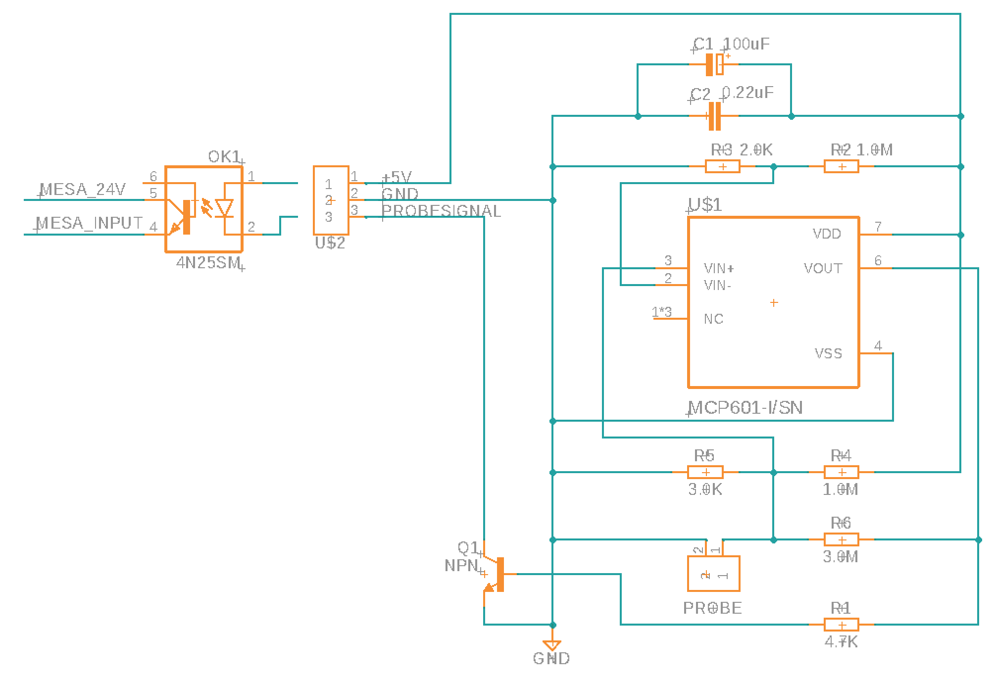

So I have redrawn the circuit so I can make some PCBs for this, but I am having trouble with the output voltage signal. I am using the inverting signal version of the circuit to be able to trigger the opto during a probe, otherwise the LED in the opto would be always on.
I am running my Mesa card at 24v field power, but this circuit operates on 5v so I thought about using an optocoupler to close the signal on the Mesa card for the PROBE IN pin. So I would power this from a 5v pin on the Mesa, but the actual triggering circuit would be separate.
Would something like this work?

I think I could use the 5v Step/Dir for the supply and Enc Index in for the signal, as explained here - forum.linuxcnc.org/27-driver-boards/3668...stion?start=0#135209
Would then not need the optocoupler and simplify things and speed it up.
