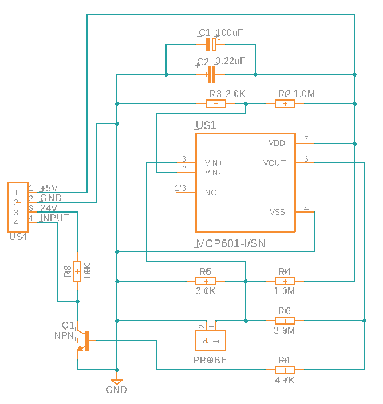

Thanks to both for the info there, thats interesting that it supplies 12v.
I think I have found a way to do this, which actually was quite easy, I still need to actually test this circuit however!
Using the circuit shown here - electronics.stackexchange.com/questions/...g-5v-microcontroller
I have attached my revised circuit that should trigger the 24v input with the same transistor.

Replied by andypugh on topic Renishaw TP-20 Probe Connection
Yes, that should work, but why not run the whole circuit off of 24V? It just needs a higher-voltage op-amp and making R4 proportionally bigger.
