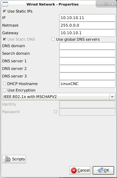

I have the following setting for the wired connection;

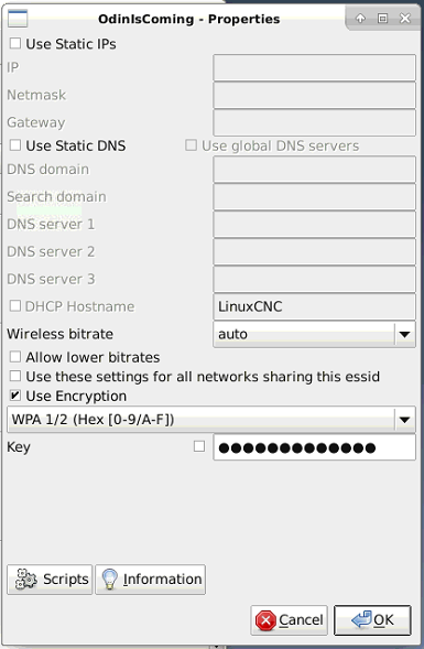

The wifi setting uses these settings;

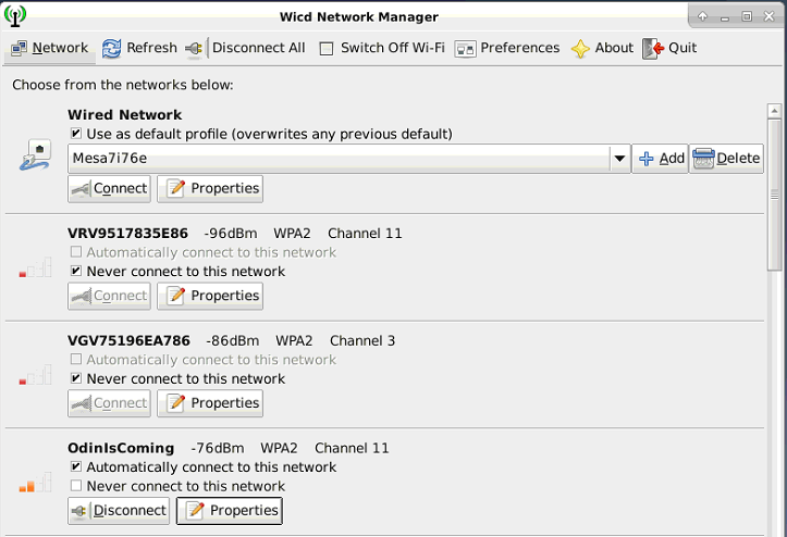

At this stage the wifi is connected(see picture below) and if the wired connection is connected, the wifi immediately disconnects.

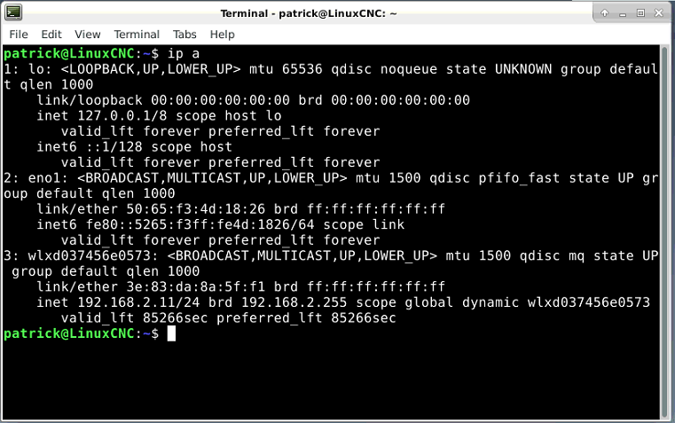

If 'ip a' is put in the terminal I get the following response;
Please note; it is connected to the Wifi and not to the 7i76e.
When the wired connection is used; 3: wlxd037456e0573: disappears and 2: eno1 shows the right ip adress and 7i76e can be pinged.

AFAIK WICD is broken and cannot make a static IP connections along with a normal
dhcp dynamic IP address internet connection at the same time. but you might try:
1. Setting a 255.255.255.0 netmask for the 7I76E
2. Deleting the gateway address on Ethernet, you
definitely do _not_ want internet packets routed
out the Ethernet port.
These may fix the issue, if not I would dump WICD and replace it with network manager.
Another option is to edit the interfaces file as suggested in the hm2_eth manual page

Replacing WICD with network manager seems to do the trick!
