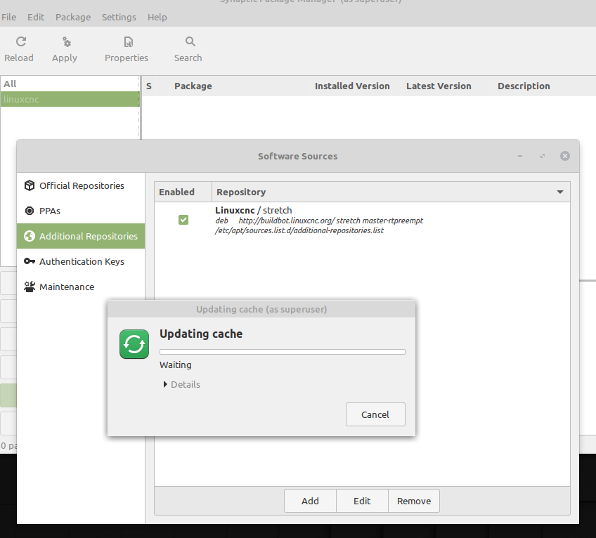

14 Apr 2021 13:28 - 14 Apr 2021 13:29 #205887
by snowgoer540
Replied by snowgoer540 on topic Updating 2.8 to 2.9 mint 19
Have you followed the instructions at: linuxcnc.org/docs/devel/html/plasma/qtpl...x_with_linuxcnc_v2_8
Which really takes you to buildbot.linuxcnc.org/
Basically long of the short is you need to install the key:
Delete existing Linuxcnc repository entries.
And then add these two (I am not sure if buster is correct for Mint. That said I've only ever used buster on package installs. I gave up Mint because I found it to be too *quirky*):
where the entries are:
I often find it a touch confusing too. Hopefully that helps a bit?
sudo apt-key adv --keyserver hkp://keys.gnupg.net --recv-key EF1B07FEE0EE663EDelete existing Linuxcnc repository entries.
deb http://buildbot.linuxcnc.org/ buster master-rtpreempt
deb-src http://buildbot.linuxcnc.org/ buster master-rtpreemptwhere the entries are:
type address <distro> <branch>-<type>
type address <distro> <branch>-<type>I often find it a touch confusing too. Hopefully that helps a bit?

14 Apr 2021 13:48 #205891
by Clive S
Replied by Clive S on topic Updating 2.8 to 2.9 mint 19
Thanks for the quick reply I had deleted the Linuxcnc repository entries.
Then I put sudo apt-get -y install linuxcnc-uspace into the terminal now I am on 2.9
Go figure
Go figure

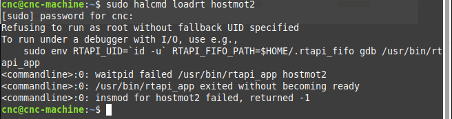

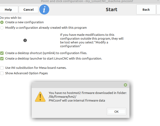

16 Apr 2021 12:20 - 16 Apr 2021 12:31 #206102
by Clive S
Ok next hurdle
I would have thought it would be in 2.9
It looks like hostmot 2 is missing. I have tried halcmd loadrt hostmot2 and looked in /lib/firmware but there is no hm2 folder or hostmot2 folder
I also tried it with sudo

16 Apr 2021 13:39 #206104
by snowgoer540
I’m fairly certain you can ignore that message. You don’t need any custom firmware unless you are doing THCAD Ohmic, and even then you can just use the Mesa tool to load it yourself.
In the past I’ve just clicked ok and moved on. I ended up with a fully functional config.
If I’ve been doing it wrong someone can correct me ¯\_(ツ)_/¯

- Posts: 18084
- Thank you received: 5317
16 Apr 2021 13:43 #206105
Replied by PCW on topic Updating 2.8 to 2.9 mint 19
The hostmot2 firmware is only needed if you have a quite old Mesa FPGA card
(5I20, 5I23 etc)
(5I20, 5I23 etc)

16 Apr 2021 14:03 #206106
by Clive S
Thanks Peter it did not show the message when it was on 2.8.
So onwards and upwards
(5I20, 5I23 etc)

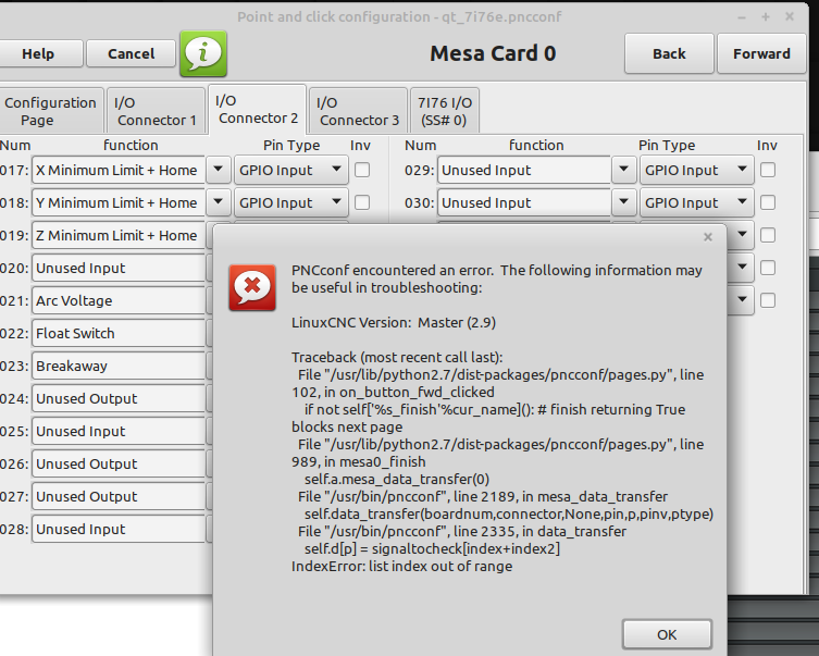

16 Apr 2021 14:57 - 16 Apr 2021 15:13 #206109
by Clive S
Is there a way I can test a config without out a card as it is on the bench. ie just the pc
Edit:
I have a 7i76e so thought I would try it. But
I am wondering if I have updated to 2.9 correctly
